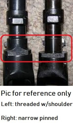

Hey Owen, I made another observation for the "straight line inletted stock"(that's what I'm calling them anyway). If you look at yours in you last pics with the tape, do you notice how it is 90 degree cut where the receiver ends and the barrel begins? I think that is a tell tale sign as well. The one in my OP is rounded to accomodate the collar. I found another stock on GB that is like yours and the dimension is correct.
owenj492
Agreed, I also found this picture in my SKS folder to share, shows the difference where the barrel meets the receiver:
Quote from: owenj492 on October 16, 2020, 06:25:01 PM
Yep, pics paint a thousand words
