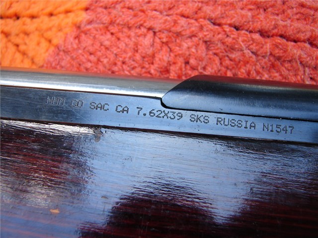

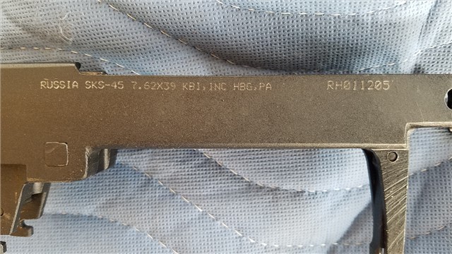

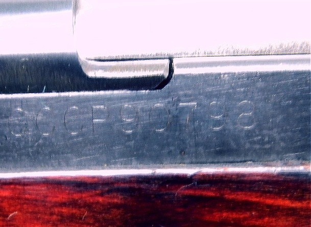

Here's one of each I've found in my first 2 minutes of looking (these are obviously not the high values...though the CDI is quite high, I have some that I know are higher, but not into the 100k range so that one might max out at 97k or so...that will take quite a bit of time as I look through thousands of my archived photos)
KBI RH: 11,205
KBI RL: 12,466
CDI: 90,798
NHM 99XXXX: 10,941
NHM NXXXX: 1,547
It appears there are XX times CAI guns then there are XXX imports. (still working on this one...this one will probably take a while)
