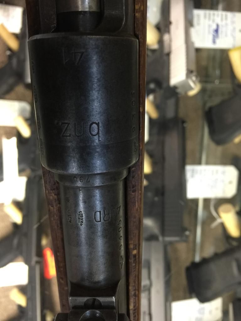

At a pawn shop, said they could do $399 out the door for this.  Metals all matching Eagles and all stamps intact.  Mismatch stock.

It's a K98 with eagles, it's a true German K98 for 400 bucks, whatcha waiting on, whip out the wallet and get gone with it.... Worry about the small details later, like the missing sight hood.
It's a Yugo rework but they kept the reworking to a bare minimum. Looks like a good deal. Steyr-Daimlers are some of the best Mausers made.

Hard to say without seeing all the numbers (German guys are funny about their numbers). Are there line outs? Force matches? Electropenning? The Yugo stock knocks it down a bit. Just from what I see, it would bring $425-500 on GB. Put it in an uncaptured stock and it's maybe a $600 gun.

Garand1957
Looks to be a Yugoslav refurb K98k by the 1 TRZ stamped in the stock.
All the Yugo refurbs I have seen have the swastikas peened over and have the bolts and magazine floorplates re-stamped to match
The Yugoslavs did a much nicer job refurbing these than the Russians.

Nothing premed over that I saw and none of the metal was re-serialized.  Stock serial doesn't match the rest of the metal.  I'll look it over more closely once I get it out of layaway.

If none of the metal is boogered, what's to say it's a refurb.  Maybe some one simply replaced the stock which may have been duffle cut or busted or ---

I wonder if the handguard matches the stock or rifle.  How's the bore -- not that it matters that much.  Hell, get that puppy.  jd

Sounds like someone simply used a Yugo capture K/98 stock on it.
