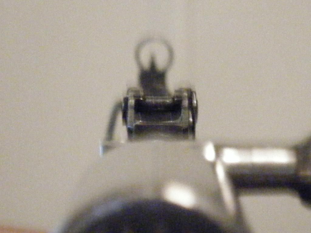

Did you get your sights figured out ag? BTW, hard to tell but the FSB does look canted. I have taken a rubber mallet the FSB in the past to fix a canted front sight. Hold the SKS sideways with the direction you want the top of the FSB to go facing down while the barrel is supported on something solid. Smack the top of the FSB with the rubber mallet then check for alignment. Also, did you check to make sure the barel isn't bent? I've had a couple of those over the years as well.

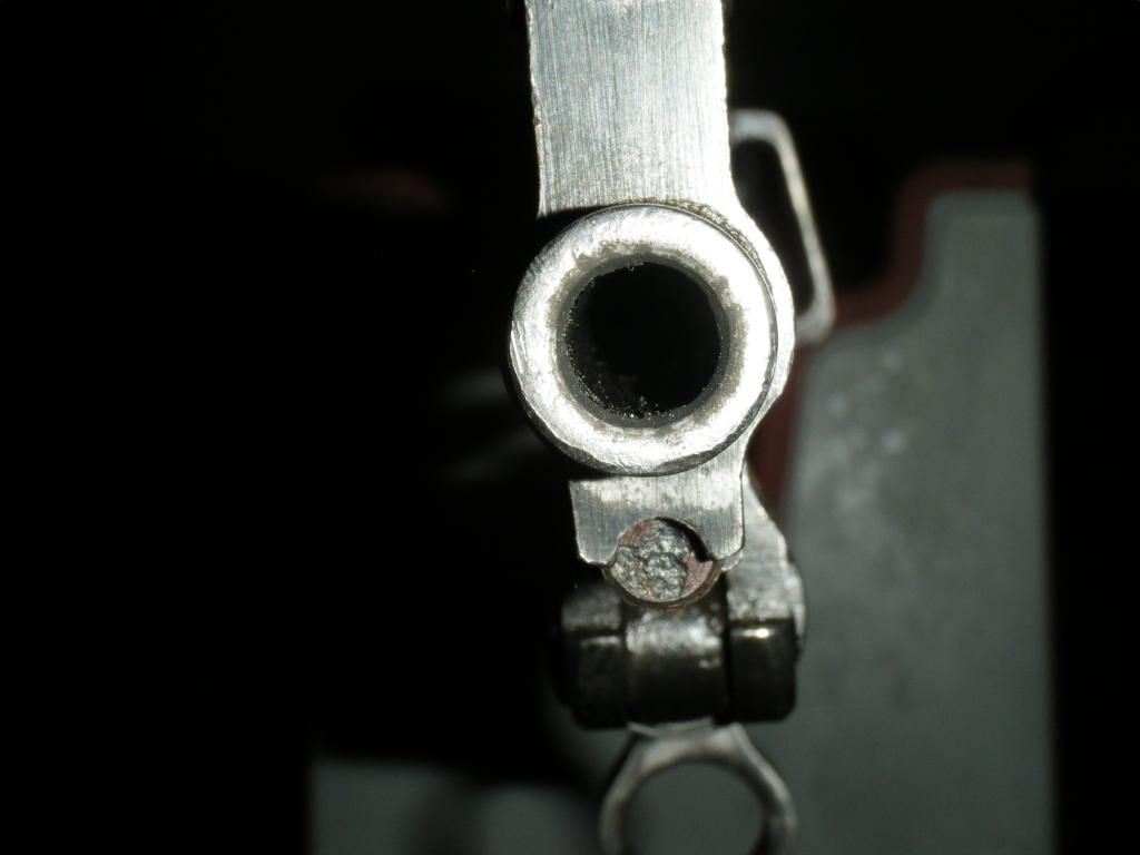

Actually you can tell a lot from looking down the barrel, but you have to do it from the receiver end.
If you strip the rifle down to just the barrelled action(don't need to mess with the pressed on stuff on the barrel obviously), Look down the barrel from the rear of the receiver so you can get a clear view. You may want to steady it in a vise with the jaws padded or something to get a good steady view. Basically the muzzle end opening should look symmetric in respect to the chamber end in a circle within a circle type view. If the inner circle, the muzzle end, looks off center to the outer circle, the chamber end, then the barrel is bent.
If the barrel is bent it can be cold bent back into position with an hydraulic press without disturbing the temper of the metal. You may or may not need to remove the pressed on parts on the barrel depending on where it is bent.
I had an M59/66 that was bent so bad you could only see about 1/4 of the muzzle end hole because someone had run over the front of it. I did end up cutting off the front 2" of the barrel, but was able to straighten the rest out then re-crown the muzzle. Turned out to be one of my more accurate SKSs. I sold it to a friend here in KC who still has it and hunts with it every year.

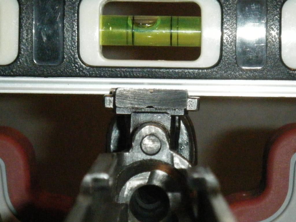

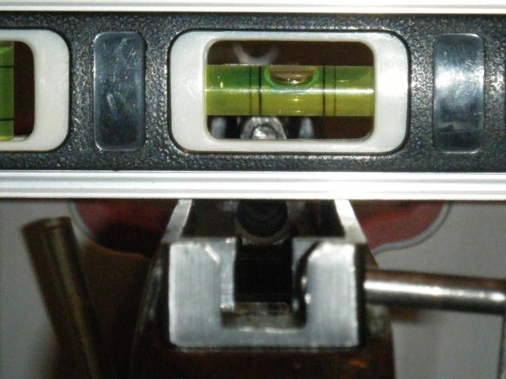

I swear thats a canted RSB or FSB Im seeing..
agrace
Yup.. that is what I keep getting my eye drawn back to.. the rear sight base being canted a bit to the right.  However I need to just get the thing in the vise, take some get do as GG suggested and then if need be take a few more pictures from that angle and see.  Unless my range trip proves it was me not adjusting the sights correctly all along.

Hey ag, if you get a chance, take a pic from just a tad further away and coming down over the action just a little bit more than the pics you currently have up. That might help in the focus and the view of alignment.
IIRC there has been a discussion in years past(4-5 maybe) about canted RSBs particular to Yugo M59/66s. I think it was determined that the rear sight leaf tangs were coming in bent so the leaf ended up sitting crooked in the slot of the RSB. That couldn't be the case here as the leaf has been removed in the pics.
Oh, another thought, you can take a straight edge over the top of the action with the receiver cover in place. Lay it over the back center of the cover to the center of the FSB Globe then see how the rest of the action parts line up. You can also line it up to the center(left to right) of the bore. That will give another angle as to what is canted or bent.

Okay guys.. a few more pictures, I looked down the barrel thru the chamber as GG suggested and I don't see anything that would indicate a bend in the barrel.  I don't know if the level idea I had by leveling the receiver and then moving to the rear sight base would show rear sight cant but thought I would try and and let you guys share your thoughts. If that is a good method then the rear sight base is canted to the right a bit.  I look and see something different each time, one time it looks like everything is lined up as it should be and the next the rear sight base looks canted to the right a bit.. :). Thought I would throw in a pic of the crown of the rifle as well.
