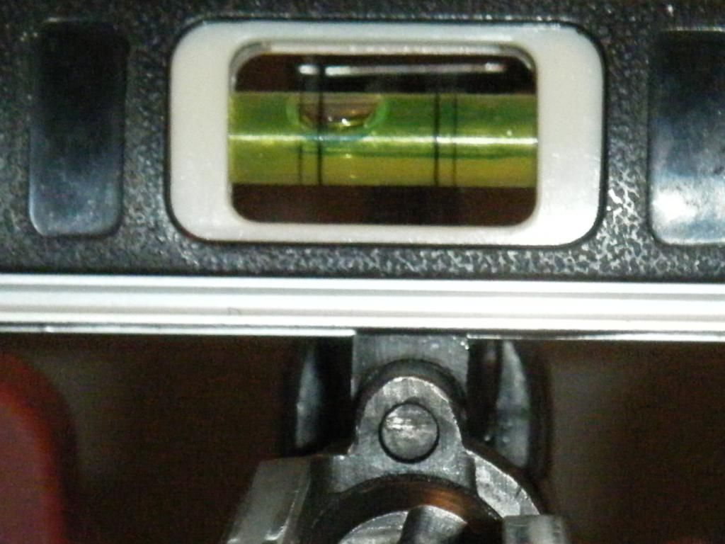

It could just be the leaf itself. I would try the level test on the base itself and then the leaf looking for a change. The block looks to be canted to the right a tiny bit, but Im not so sure its significant enough to cause any real issues not correctable at the fs adjustment.  The crown itself looks fairly good.. no obvious issues that I can see.
I would do try to zero making adjustments at the post (now that you found your tool) and see just how much drift to one side it takes to get it centered left/right and then go from there.

Thanks.. here are the shots with the leaf up and out of the way. Does that help at all?  Guess I will try to get back to the range tomorrow or Tuesday since I am off work.

Checking level that way could merely mean poor machining and have nothing to do with the base being out of time. The straight edge should show whether everything is at the 12 O'clock position or not. Not saying the level won't work, just that there can be some error in the former. I agree with LC to check the level on base and the leaf to look for change.
Having said all that, the more I look at all your pics the more it looks like the RSB is canted to the right slightly. Heck both front and rear could be off.
Another option for a cure would be to put a Tech sight on it, but if you don't want to mess with removing the cover pin then that would not work for you.

Yup.. I was thinking the same thing about the machining.  I used an 18 inche ruler that I placed down in the sight notch and things seemed to line up correctly. At this point I am going to just get it back to the range with my adjustment tool which is now in my bag, and going forward will triple check to make sure it is there before leaving banghead1.

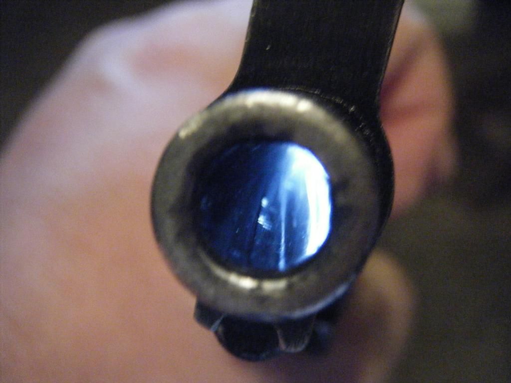

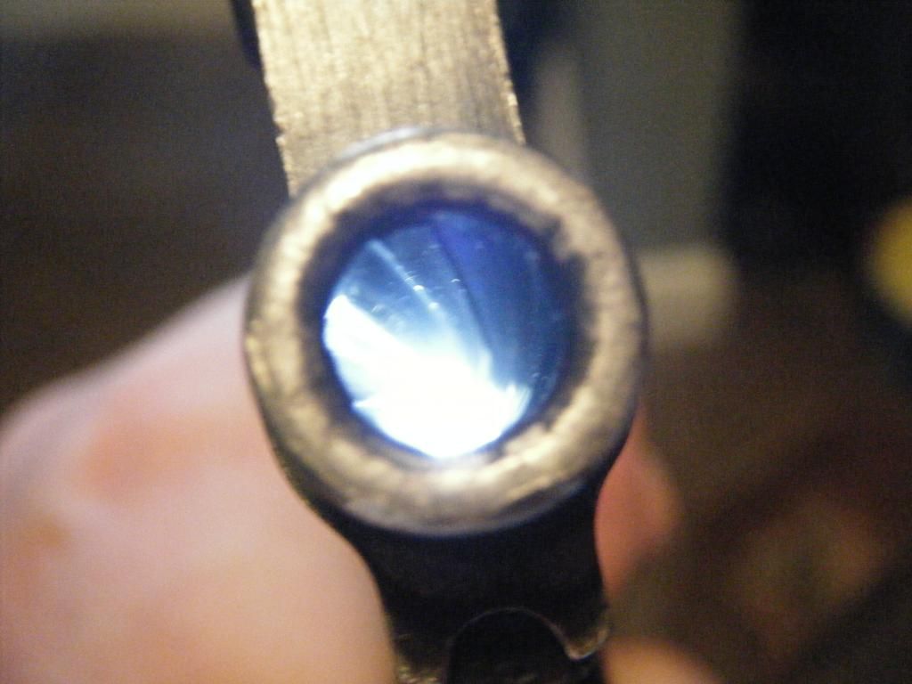

Put a live round down the barrel from the bore end. Take a pic and post it. I'd like to see what condition the barrel is in. If it's "shot-out", meaning worn out, it will never zero. It is possible, it isn't sight related at all, but worn out barrel related. It is also possible it is crown related. Are the lands still crisp and sharp? Just trying to cover all the bases.

here ya are guys.. I tried to get the best shots I could from the crown to see the rifling. My son has a much better camera so I may have him try to get some shots of the bore.  I have also included the target I shot yesterday before I realized I didn't have my front sight tool. The two farthest to the left are aiming dead center of the bullseye with a 6:00 hold both sets at 25 yards.  The other two were me aiming an inch or so to the right.  They seemed to group good. Just too far to the left.  At any rate.. let me know what you think.

If it were a bore/crown issue.... they would likely be all over the place. The fact that moving your poa DID change the poi indicates it a simple alignment issue. See if drifting the sight works like I was saying earlier.

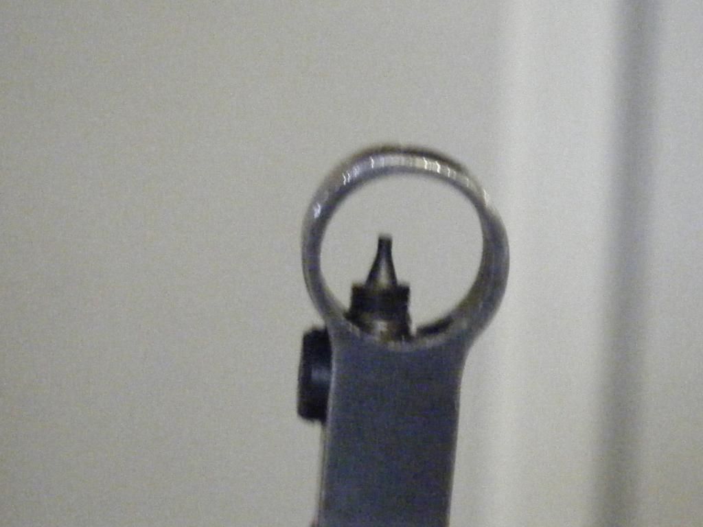

Well guys, I got a chance to go back to the range today to try and see what I could do. I had to push the front sight post to the left to the point I could not adjust elevation. The more I look at this rifle the more I am convinced that the rear sight base is canted to the right. At this point I am going to try my tech sights or my magwedge rail and see if the group will tighten up. I am using a Williams peep sight on the rear sight base and a tech sight target front sight post. Below are my targets for today.

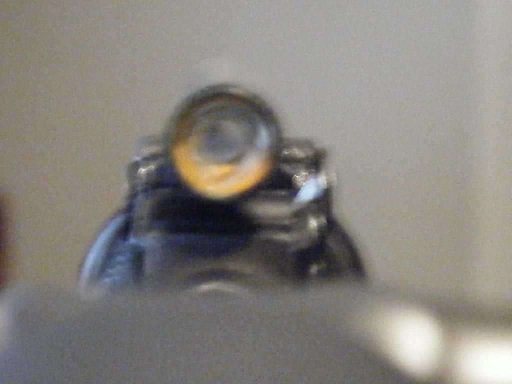

Front sight post
this is where I can see the rear sight base looking canted to the right. the bolt carrier is straight up and down. Sorry it is a bit blurry.

Im still having trouble wrapping my head around this as a rsb cant to the right post drifted far left should be giving you a a far right poi.  It looks to now be shooting pretty darn straight even though the post is drifted that far left.  I may have a rifle or two with a good size drift in the front post also.
