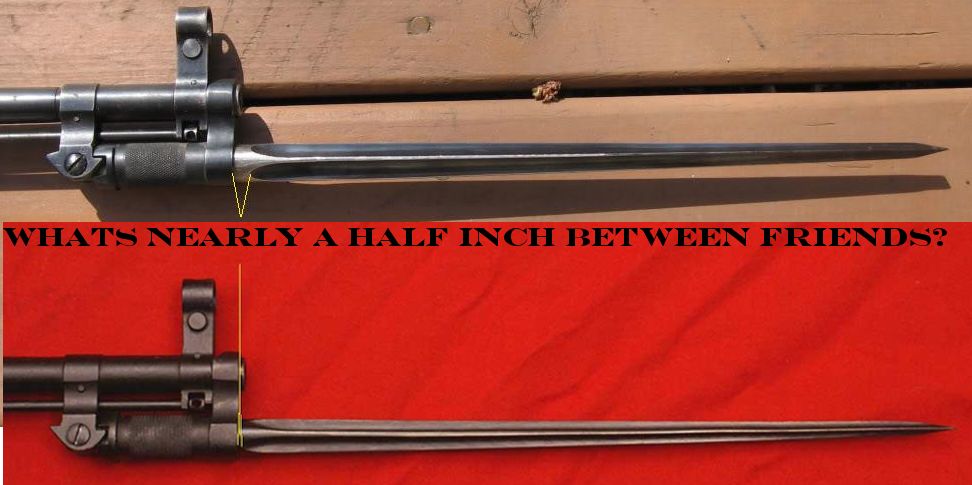

Hole to shank end....  its not just the shank diameter.
An m44 spike shank sticks out of the collar further because of this....  sure you can make one work, but they are a dif animal.  Remember I had this setup in my hands not long ago and one of the reasons I sent it back.  This is a noticeable feature.
See the dif this hole/shank location makes?  Bottom is m44 fitted to sks.. look at where the blood groove starts

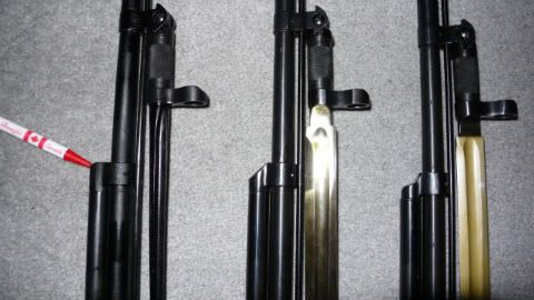

Naw... it's almost the same animal... thumb1    I said screw it......break the stake marks... just to show it can be done. I $&%@ed up my crap..  rofl2
Russian M44 with a /636 spike bayonet mounted, folded and open.. it does fit a little loose, the smaller SKS shank, but fits like a glove. The Russian M44 will fit the SKS, but you would have to spread the ears slightly. The overall length is even the same.
Russian M44 bayonet with same spike... oh yeah...it will work. thumb1 The Russian shank is slightly larger than the SKS bayonet shank. Even the mount hole looks really close, just make the slot longer. The SKS bayonet fits the M44 bayonet collar a little loose, but won't go the other way around. Open the collar or shave the shank.
Excuse the grease... never had them off..smells good.. :)
Slight screw difference
Of course the collar is different
Lets see....find a stand in, a temporary fix to get it close, it's doable until one can be dug out a cave somewhere or somebody happens to get lucky on the fleabay.  Bloodgroove...look how many are installed upside down.  chuckles1
Quote from: Greasemonkey on January 27, 2017, 01:25:32 PM
Wow, :o I did *not* know that a Chinese SKS spike and a M44 spike were the same length.  How big a diameter difference is it between the two?  Is the difference in the whole bayo body or just in the shank that fits in the bayo collar?

I know its 'possible to turn down the shank to 'make it work' (my bottom pic).  Im only stating (as seen in your pic) the hole location is different and so is the shank length i.e where the blood groove starts.... so is the diameter  The 1949 sks bayo is not a re-purposed m44 bayo.  Its that simple
Quote from: Loose}{Cannon on January 27, 2017, 02:36:36 PM

I simply address this....   Its a dif animal. Not simply old stock or the same item with shank turned slightly smaller.
Also.... look at the lightening cut. Not even there on the m44, and the flat cut stops far shorter. Wonder if PKE would take his 49 spike off for some good pics.   thumb1

Design carry over, OF COURSE...  re-purposed/reused/same item, No.   The differences that DO exist between the two tell me the 49 sks bayo isnt simply a reused or old-stock m44 bayo.    thumb1
Quote from: Loose}{Cannon on January 27, 2017, 12:32:40 PM
Ok... I will just throw this out..  You say thats a M44 bayonet fitted on an SKS.. ok, wonderful, maybe it kind of proves my point even a little more.
Now... how is it's blood groove orientation any different than the actual 1949 SKS in the photos I found with the bayonet deployed? By all rights they look mounted identically to me, both bayonet blood grooves seem to start in the same place regardless of rifle/bayonet type and the tip is even orientated correctly.
How are these two different? With the exception that your photo the bayonet is off a Mosin M44 is on an SKS. If I'm wrong. ok, I am used to it  thumb1  But they do look the same, same blood groove orientation etc.
My photos are different, the Chinese I have pictured is a 3 blood groove bayonet and it adds a funky visual difference, the M44 and '49 SKS are both 4 blood groove.

Only that would be comparing it to a..... chinese not a 49 russian.  (not saying it wouldnt make it look closer)
Of course, that wont change the hole placement which is also different between the two.
