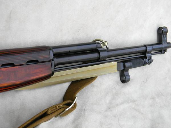

Greetings from Canada!
Folks, I am new in this forum.
I'd like to learn more of what I got here.
I'm so new to the SKS platform that I haven't field stripped this carbine yet.. :)
Enjoy the pics...
These are all the pics I could take without disassembly. I'm believe there are more markings underneath the bolt carrier and bolt.
Let me know if there are more markings that I am not aware of that I could also post here.
I need to go through the SKS HOWTOs to dis assemble this.  :))
What do you think fellas...how did I do on this one?
Welcome to the ranks of SKS ownership! thumb1
Looks like a nice Russian SKS-45!  1954 is the most common year typically found out there.  AB is a known prefix for '54 and the metal parts all look as they should.  Bayo lacks the gold chromate coating, but in my book that is not a huge deal on one of these.  A definite plus is that this carbine is pinned internal to the magazine and not riveted externally or even worse Frankenpinned.
You'll get different opinions on the stock.  I have no doubt it is the original stock to the carbine though some will say it is as-issued, others will say it's likely been lightly refinished.  The double struck cartouche on the right side of the stock is certainly not something commonly seen, so that is certainly interesting. The sans serif 1 in the S/N matches other as-issued stocks from the '54 AB series I have in my files.  The "A" seems a bit short on the bottom legs, in fact it almost looks like a Д.  Some of the other "A's" from '54 are a bit similar though so it may have just been a worn stamp or stamped poorly.  The color in some of the photos seems a bit more brown than I'd expect for an original finish, but it may just be your lighting not popping the ruby red I'd expect.
Make sure to pull the firing pin out of the bolt and clean the channel thoroughly before you fire it.  thumb1

Nice looking rifle.
It has the hallmarks of an unissued, straight-to-long-term storage rifle, and no wear that might indicate issued use.
The darker stock color that RM comments on could be a trick of the lighting in the photos. But stored rifles were subject to regular inspection and maintenance of the wood and metal to prevent corrosion and correct cracking or flaking wood finish. The Soviets used VK-1 nitrocellulose lacquer on the sks45 stock. VK-1 has a natural reddish-brown tint. So any lacquer added during storage maintenance would have the effect of darkening the stock finish.
As RM stated, 1954 is the most common year. But the high condition of your rifle is not as common. There appears to be modest damage to the wood on the right side, by the bolt carrier. Regardless, you got a very nice example. Congratulations!

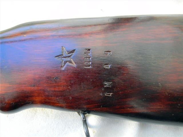

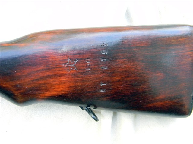

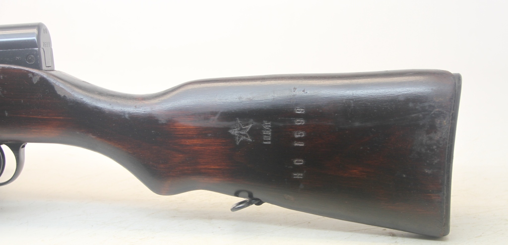

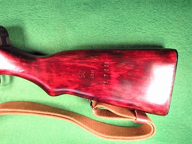

Very well could be the lighting.  Here are a few of the more reddish 'as-issued' '54 examples we've seen:

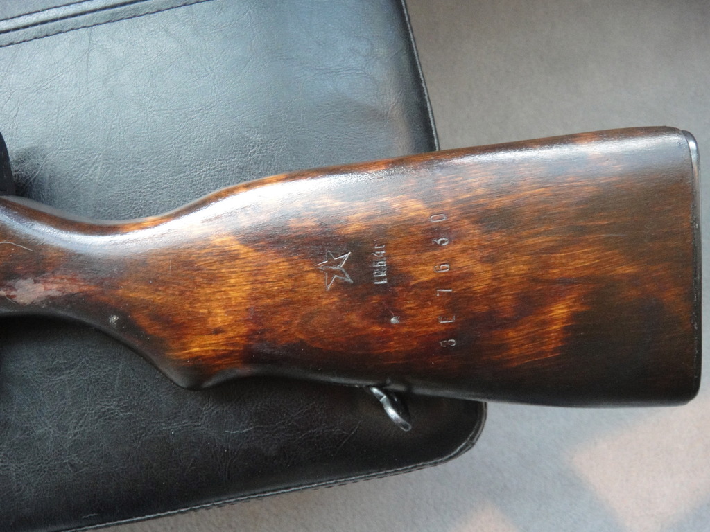

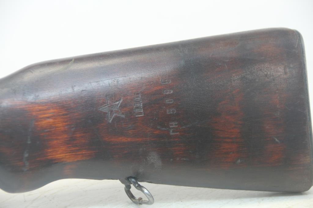

Not to say that darker brown as-issued examples aren't out there:

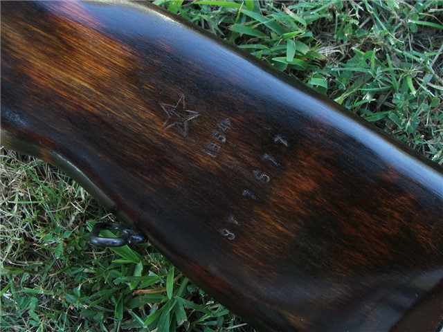

or lighter red & lighter brown for that matter:
And then, some of the Izhevsks are straight up blonde  :o  ...but that is something for another post.
