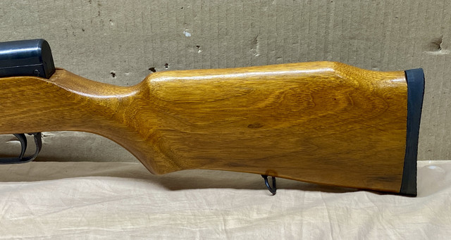

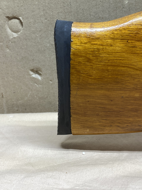

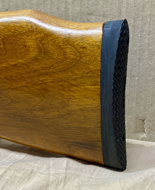

Some may have seen I had a WYB listing for an OEM Butt pad for an SKS-M Monte Carlo stock. Well, Murray hooked me up with an aftermarket grind to fit that actually looks close in height to the original one. Got it yesterday and fit it onto the stock today. In spite of a couple of dings in the wood due to not having a pad on it, I think it turned out pretty good. Thanks to Ben @ Murray's
Here's some pics;
Here's a pic from the internet with an original pad that I grabbed for my WTB thread to compare

I got mine from Ben at Murray's Gunsmithing. It is a NOS from Alpha that he picked up so you'd have to check with him to see if he has any left to sell. He has a sub-forum here like he did at the other forum that is now defunct. You can PM him through there. As to the size it was well oversized, but easily ground down. I used my 1" bench sander initially with my 6" disc bench sander to finish for a smooth final touch. I had to drill in a new hole for the bottom as the spread was narrower than the original hole spread on the stock, but it worked well and the finished product looks real close to the OEM part.
Quote from: running-man on July 20, 2026, 10:01:48 PMVery nice indeed.  How hard/easy is that rubber to grind to profile once you have it attached?  Did you mark a perimeter line and grind to that, or how do you keep from taking the finish off the buttstock?
Sorry RM I just saw this. When I worked at a gunsmith shop we had a butt pad fitting triangle to grind pads down with a nice 9" disc sander. I don't have access to that anymore so I set the raw pad in place on the stock screwing into the top hole only and squaring it up. Then I took a scribe (looks like a pen, but is a fine steel point instead of ink point) and I traced the perimeter of the stock staying as vertical as possible. I did the rough grind on the 1"x21" belt sander and finished with my 6" disc sander to fine tune the lines and smooth it out at the curves.

And Monaderio, IIRC it was about 5"x1.875" overall but with a shorter hole pattern than the M stock. It was easy enough to set a new bottom hole though and I used the existing top hole on the stock with the top hole on the pad.
Edited to correct dimensions, it was 1.875" NOT 2.875"
