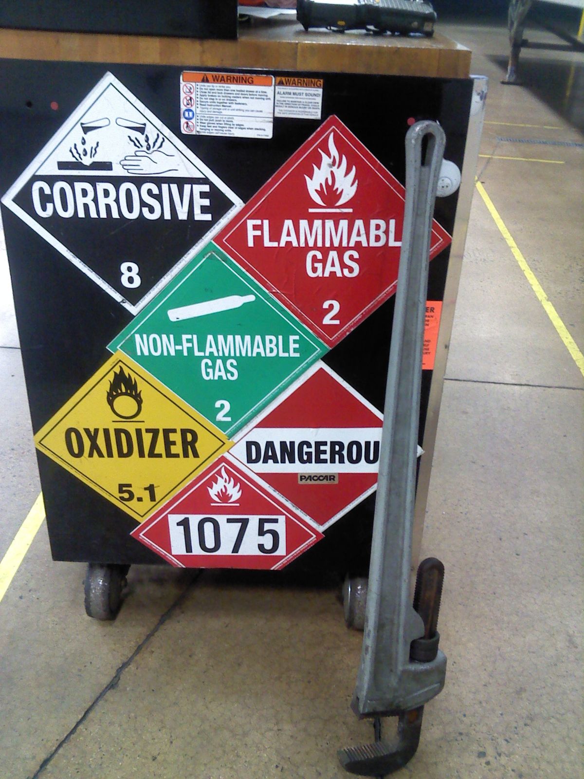

Very nice!  What did you finally use to get them loose? (I see a 3' pipe wrench in the background of one of the pics!  :o)

Possibly some heat and soak.. not heat it red... but... warm it to 300-350 degrees well before metal color change, you dont want to change the hardness or previous heat treatment, so keep it low.. When I was a truck/heavy equipment mechanic.. common practice was to spit on bearings and such, when the spit bubbled and bounced.. it was right.. time to install. There are temp crayons that the mark vanishes at the correct temp for this same job. Soaking with or dunking it in oil while heated can help draw in the lubricant to the threads, many things work, diesel, PB Blaster, Free All, 50/50 mix of acetone/ATF, even regular candle wax. sometimes it might take a few cycles to do it, but usually it will help..There have also been times... dry ice was used to loosen things.. I've used it on cylinder liners.
And sometimes..... size matters. :)

I apologize RM but a pipe wrench was used, I'd advise those with weak stomachs to look away now.
