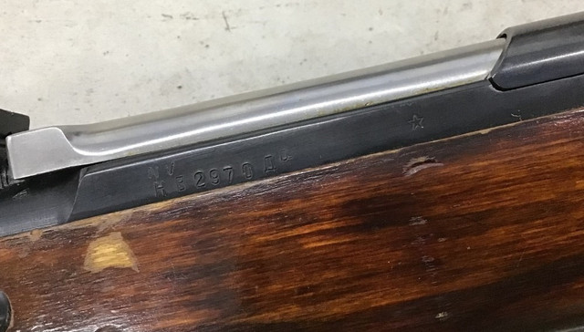

Picked this up today, it's a 1950 in rough shape. The gas piston is seized pretty good, the firing pin is broken (also interestingly a Murray's replacement pin so it's a recurring issue), the stock is really worn, and interestingly it's been counter bored which I've never seen on an sks before. Mostly here to admittedly show off but also to ask about theory's for the firing pin. Any ideas why it keeps breaking? obviously the previous owner was hard on it but if it's something I need to remedy I'd like to know before I sink money into it.
And some pics of the bolt and firing pin (what's left of it)

Maybe zero? If so that would be perfect as the Chinese rifle I have is a zero too. Idk what do you all think?
Attero Dominatus
Looks like a zero so you lucked out!!! PAX

Quote from: theSKSguy45 on October 17, 2024, 04:17:34 PM
I don't think that is the timing number. The receiver timing numbers are stamped on the bottom corner of the receiver flat (by the middle of your pinkie in the photo)
Here's another 1950 example (from jstin2) with the receiver timing number (29) in the standard location: https://ibb.co/w0SQrF3
