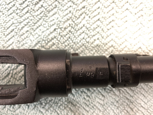

The answer to your question on the swap is "Maybe"  depends on what configuration the Chinese is in.
Post some photos of the two and we'll be able to go in more depth.  Specifically the barrel lugs of each and the barrel lug match numbers on the side of the barrel and receiver.  You have a 1/35 chance of the match numbers being the same if the Chinese is a long or short lugged gun.  If pinned and pressed, you are out of luck.

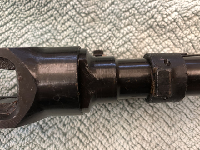

Thanks for the offers to help!  Here are some pictures of the barrel lugs.  I see some markings, but nothing that I can identify.  There are some hand etched numbers on the Chinese receiver and barrel that appear to match.  Both barrels appear to be screw-in. The muzzle of the Russian barrel is significantly eroded.
Again, any help in determining if a barrel donation from the Chinese SKS to the Russian SKS is appreciated!

I see the 1 on the russian but don't really see anything i can clearly read on the Chinese. Is there a number on the left side of the receiver right behind the lug?

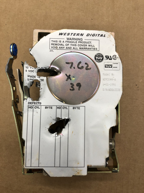

Hello Guys and thanks for all the info.  The Russian SKS is in mechanically good shape. My concern with the barrel is the keyholing that I observed while rendering the data on a hard drive inaccessible.  I'll take it out, once the snow melts, and see what it looks like on a paper target.

In that case it may very well be a crown problem, like BZ mentioned.
What kind of ammo? Hand loads or factory loads?  Ammo details..  Ammo issues can also cause this issue.
I remember Dannyboy had an SKS that absolutely hated boat tail Golden Tiger Ammo.  He was all over the map with it, sometimes missing the paper altogether.  Brown Bear was a relative tack driver with the same carbine though.   dntknw1
Definite key-holing problem there.  Will be interesting to see where this one leads and what problem you can positively identify, I have my doubts that a simple crown will fix something that blatant (though maye, I've been wrong many times before!  :-[).  Have you tried different ammo, slugged the barrel, or even taken a cast of the chamber?  To keyhole like that I'd think is more than the bit of muzzle erosion you found.  I'd be thinking worn lands all the way down or a huge jump at the end of the chamber.
If it does turn out to be the muzzle erosion, have you considered cutting down to an 18" or 16" barrel to remove that problem area vs. a full barrel swap?  Hate to chop up a gun (especially a Russian SKS45), but if it's an obvious problem at the muzzle maybe that's the easiest way to get a good shooter?
