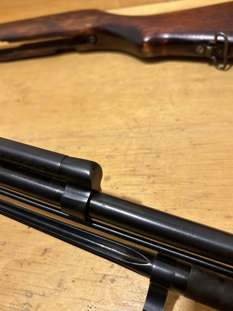

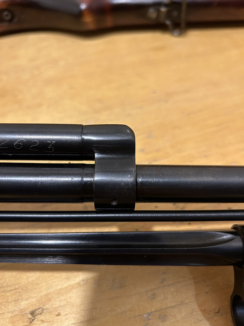

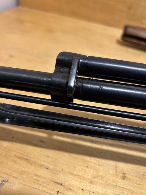

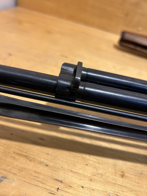

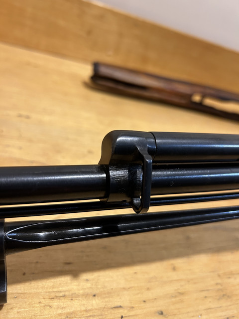

   From there Sean noticed that the front sling mount was thicker than his other SKS.
https://ibb.co/album/h1FD3R

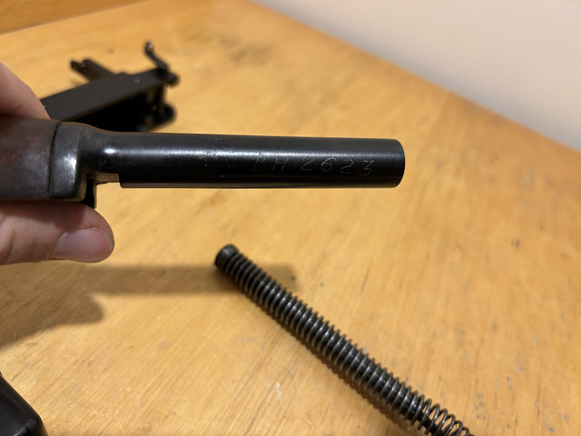

   Also the op rod rather than being round was approx. 3/4 round.
https://ibb.co/album/cX1QbX
   Now the question is, are the differences leftover from the 1948? We will probably never know unless additional pictures of a 1948 turn up.

jaroslav - The parts were machined, but not finished. The knurls were not machined on the safety and magazine release. Why? The front sling mount being thicker than later rifles. Why? The push rod was machined to approx. 2/3 round and is stamped. As far as the stock, the hole is in the spike stock(one on the right). Stock ferrule for a spike is smaller than the ferrule for a blade. Why is the hole drilled and not the normal channel for the cleaning rod?
I added pictures of my spike stock and a blade stock. It shows clearly the differences. And yes, it is a replacement laminate stock. Spike stock on the left.

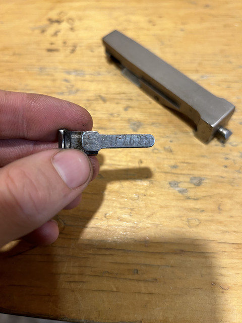

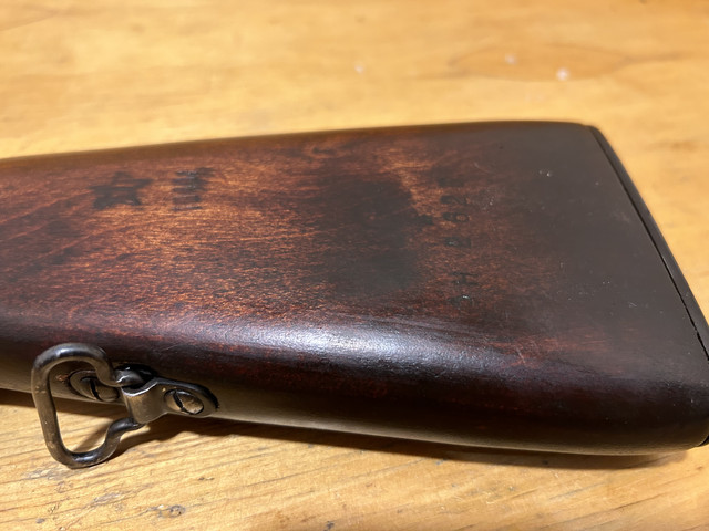

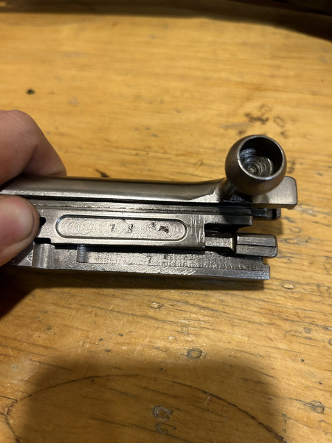

I have asked Sean for some more pictures. Still receiving additional pictures, but here are some for you to check out.
https://ibb.co/album/JW7XnG

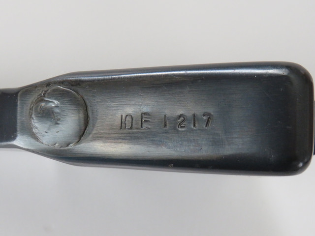

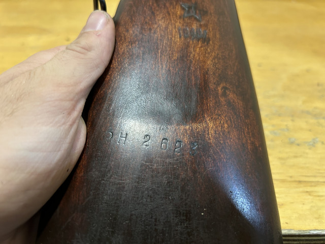

Here are some pictures of the inspection stamps. I will have the last set of pictures ready later today.
https://ibb.co/album/mSZZ8X
