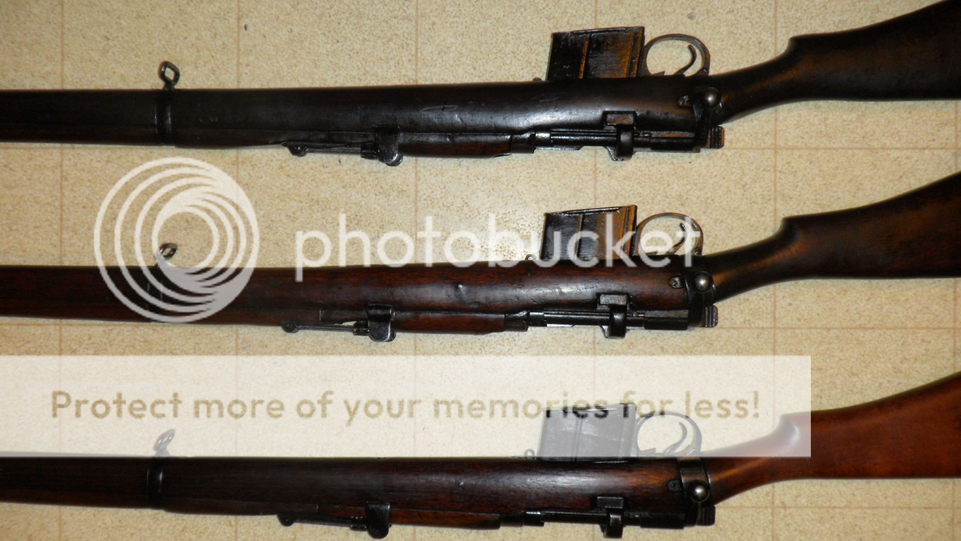

I picked up several of these about 10 years ago, or so. I've asked around but never get a definitive answer. Does anyone know which bayonet would have been issued with the Ishapore 2A Enfield that is chambered in 7.62x51mm (.308)?
They still have that black preservative paint? over the metal, but I'm looking forward to seeing them cleaned up and ready to fire. All bores look fresh and minty.
Lots of gooey goodness to get happy with...
The magazines on these are a little different than the .303 Enfield mags. These hold 12 rounds per magazine and are serial numbered (stamped #'s) to the rifle. I was lucky enough to get the correct serial numbered magazines with mine and also an extra mag for each rifle.
Thanks for any hints or info on the correct bayonets for these. I'd also like to pick up the correct slings for them.

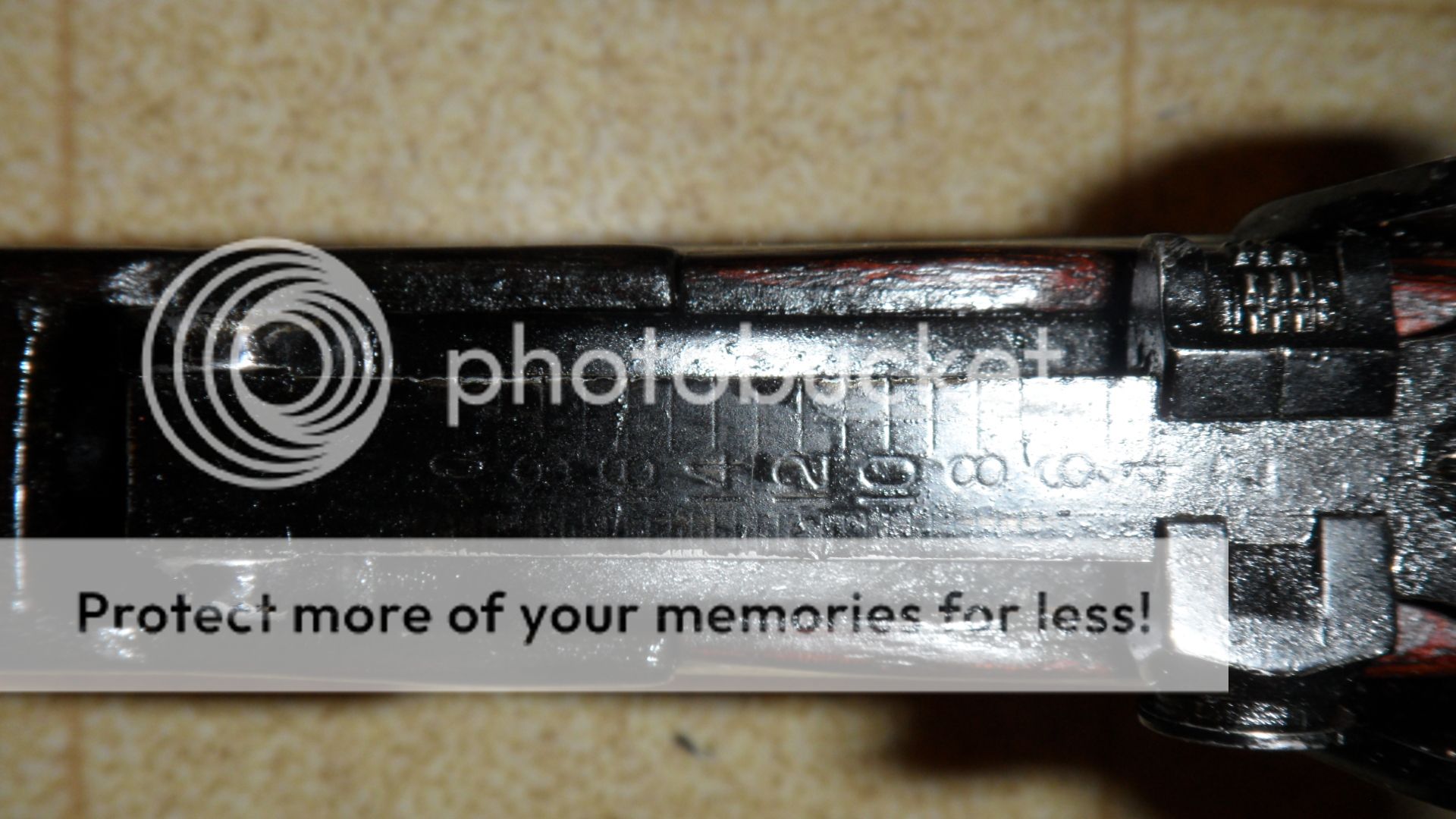

I got 2 of them about 10-15 years ago.. I got the 2A and the 2A1..only difference being the rear sight on the 2A1 shows 800meters, not 2000meters.
