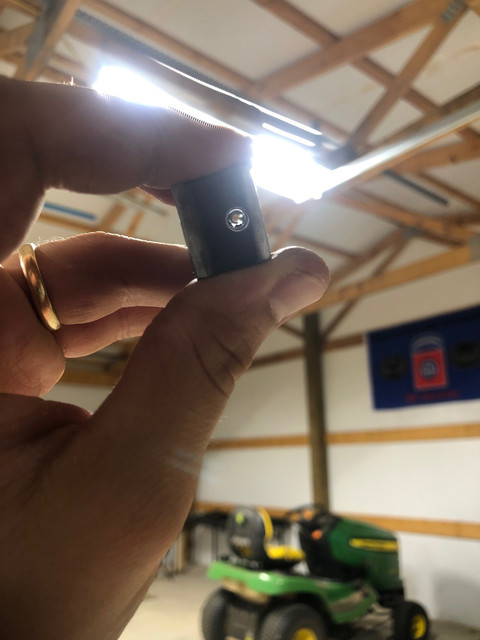

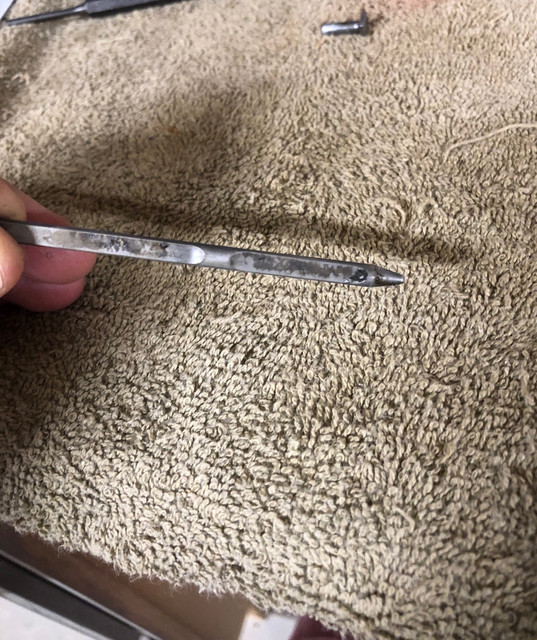

I've had a few random thoughts about this in the past....
We're not talking about a whole lot of weight here. Not really enough to be appreciable, anyway.
I understand that ounces count. Especially when it translates into the amount of extra ammo you could carry. Since the SKS is not a select fire, or auto for that matter, so it wouldn't increase the rate of fire in any appreciable manner.
HOWEVER! Commies have not been known to be overly responsive to the needs of the foot soldier.
My thought is that they did it in order to reclaim/reuse/recycle the metal shaved off for other purposes. I believe the Russians did this with the capture screws from captured K98's.
What says the gallery?
