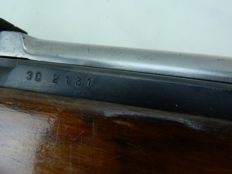

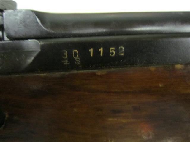

Others with the same prefix in the database:
I don't have great photos of the 3055 gun, but the other two match yours quite well.
