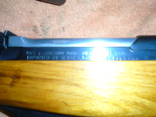

I have two pinned barrels SKS with that rivet holding the bayonet in, they have the serial sequence I assume that is like the SKS-M, NR, Sporter, etc. One is C13 91 27938, other is C9 91 30029, both MADE IN CHINA BY CGA, IMPORTED BY GLNIC LA.CA. With that "91" I assume they were sold in 1991. The bayonet rivet is not flared so I can back out the rivet and remove the bayonets (on both rifles) The 9127938 was missing stock, magazine, the 9130029 was in the black monte carlo stock, replaced that with a wood stock and handguard (non-serialized) I forgot: only serial numbers stamped are on left side of receiver, bolt carrier and bolt, the trigger, receiver cover and magazine (stocks also) are not stamped with any serial numbers.

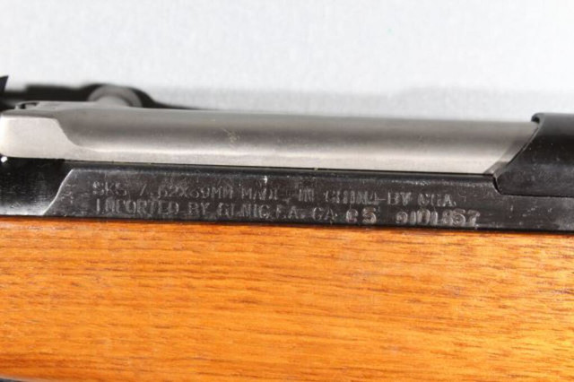

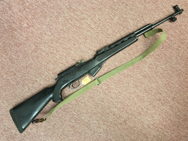

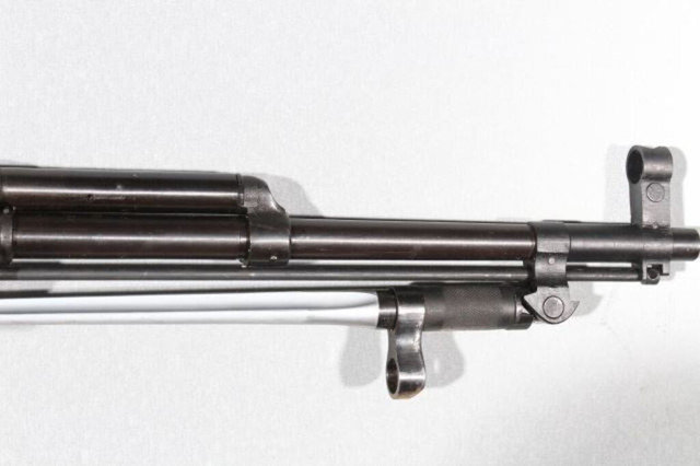

Found another pinned barrel SKS made in China by CGA with serial C5  9101857 and the bayonet rivet looks to be "flared" see pictures below (found on proxibid.com):

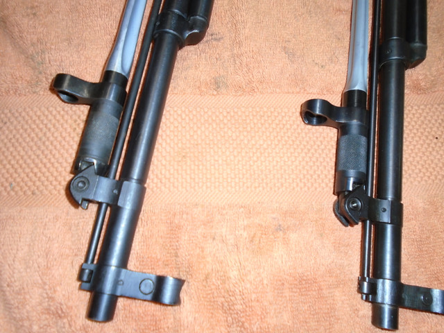

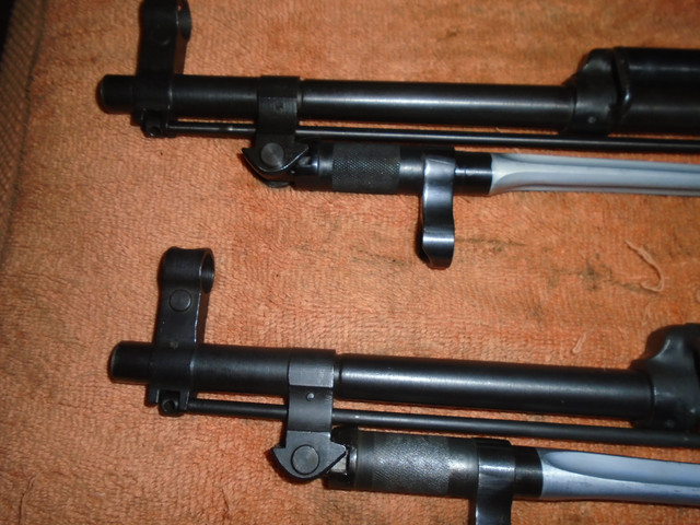

Thanks to "firstchoice" for seeing that I had the rivets inserted on the wrong side and they have been corrected!
Wrong way:
They are supposed to be inserted on the right side, above picture they are inserted on the left side, the correct right side is flush with the head of the rivet, left side is not flush.
Correct way:
Looks good, owenj492!  Glad I could help.  The recessed rivet head definitely looks better when seated properly.

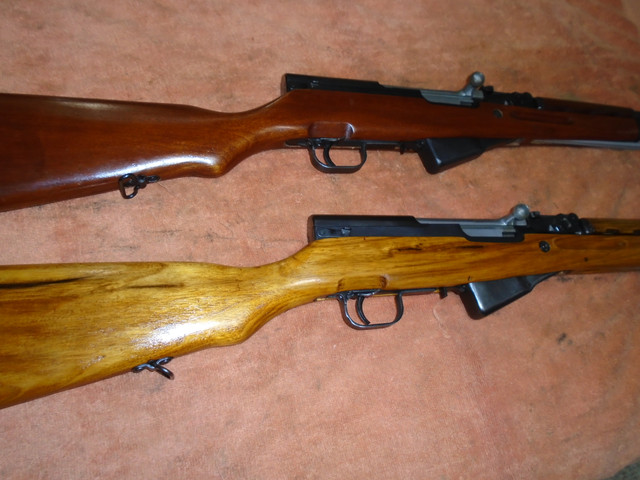

Your two GLNIC-imported Type 56's are really nice examples!

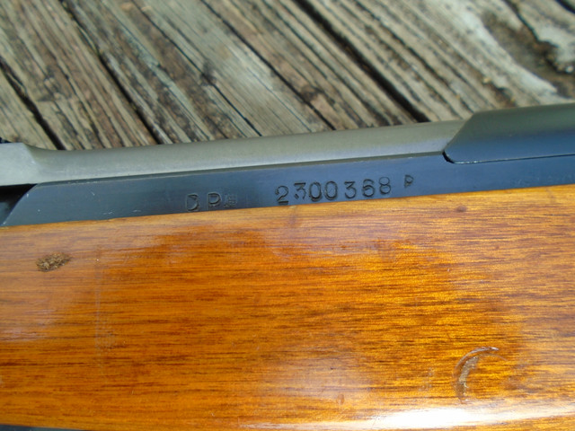

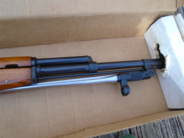

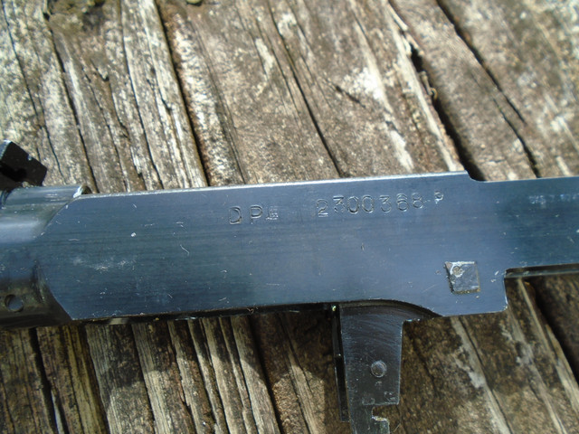

I forgot about my K Sports "DP" serial number 2300368P that is pinned barrel but has screw instead of a rivet:

Looking at owenj's DP... screwed v pinned barrel - didn't consider that.
