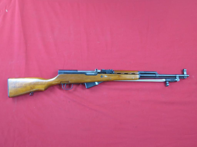

Okay, I don't know if a thread like this will take off or not but I saw this auction listing for an SKS. First I  :)) and that was immediately followed by the thought: "What's wrong with this picture?"
Starting off with an easy one:
Answer if you wish and post other peculiarities you come across.
Good job guys  thumb1 I didn't think that would take long. Rather funny looking Chinese with the loooong bayonet.
Very good. Next question is almost as easy: what bayonet belongs on that carbine and why?
Quote from: Bacarnal on May 03, 2020, 10:52:31 PM
Spike. Later type bayonet swivel.
Yup, no lightening cuts in the bayonet lug or the bolt carrier.
This one is an oldie but a goodie.
I was looking at it because of another curiosity. Second picture to come.
Quote from: Bacarnal on May 03, 2020, 10:56:37 PM
Bayo upside down.
Yup. A popular mistake for first time SKS owners to make in a thorough cleaning.
