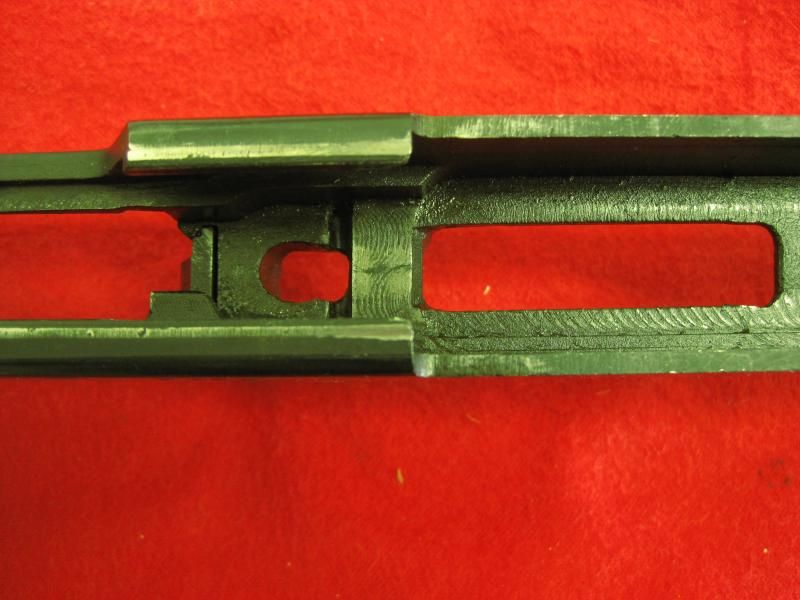

Looks like that shelf is cast in for that purpose. At the far left in pic 2...
Kind of like a pre-stamped last ditch style construction. Prototype perhaps?

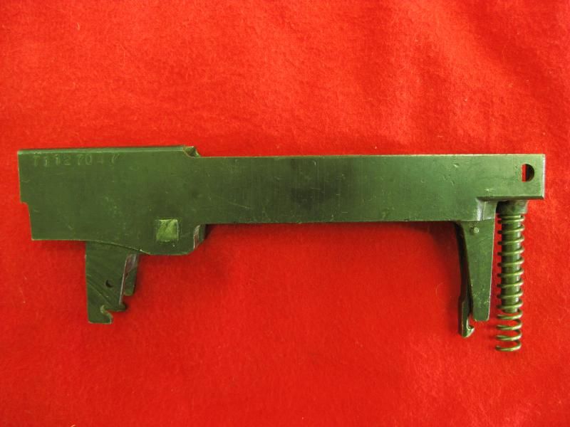

Right...  looking at the orientation of the disconnector, it does look like its dependent on the cast receiver body itself.  Wow.    Even milled and tempered receivers have a hardened keystock.
To me....  this is over the moon scary.

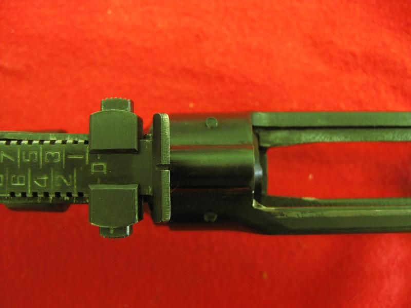

What is really scary is looking at the tip of the ejector in the 5th pic... I believe it has been shot a few times!
I could picture them moving to stamped construction as an "improvement" over this design, if the aim was to save manufacturing cost.
Odd that such a beast would get exported though...

The plot thickens...it appears as if the hole is supposed to have a pin going through it....right where the keystock would be.  Is this even safe to fire I wonder?
I think we need to get to the bottom of this before you even think about firing this one Justin!!!!
With the bolt, magazine, and trigger in the gun, but receiver cover off, push the bolt forward as far as it will go into battery, then press down on the top of the bolt (this is what the bolt carrier does when it moves forward the last 1/2" or so).  While still pressing down, try to pull the bolt back out of battery.  If it moves more than 5 or 10 thousandths, then you've got a serious problem.
It doesn't move even a smidge.  I looked through the pin hole and saw no bolt poking in the way either. It rests solid when pushed down on the metal directly in front of the interrupter.  I cannot fathom what that 'missing' pin would actually be reinforcing.  The only metal it would contact would be either side of the receiver, the bolt hammering into the metal both above and behind it, seems as if it would be pointless.  Perhaps it is a window more so than a pin hole?  Kind of like the windows on trigger groups? I could see the shadow of the edge of the bolt disappear completely flush with the top of the hole...as far as I can see anyway.

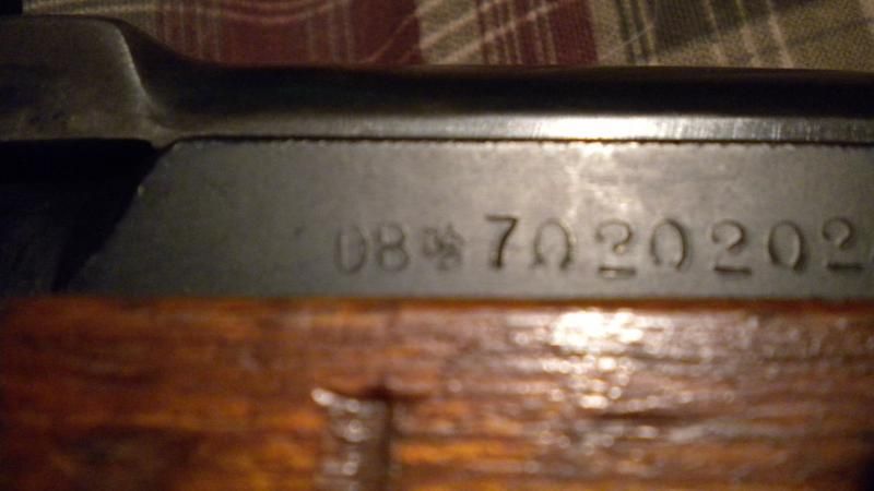

I took a peek at Yoopers and saw that indeed one of the examples of a cast receiver is a DB, but my serial predates it by either two years or 2 million guns...depending on what consensus is regarding these today. :)
I did also notice there is a T proof mark on the back of the bolt that I hadn't noticed, also...the serial is upside down compared to my other Chinese bolts too.  It seems everywhere I look, I get distracted by one weird thing...only to discover another.

The hole going through where the square keystock would normally go...is it drilled in such a way that the side of the hole creates the edge where the rear end of the bolt would touch in your photo 2?
They were definitely experimenting with design improvements with this gun.  I'm liking it more and more, the deeper we delve into it!  I'd be scared as hell to shoot it, but I do like it!
Edit:  Ahh I see you looked through the hole and saw the shadow of the edge of the bolt disappear...I'd agree that it's likely some kind of window.  A pin pressed in that spot just doesn't make any sense... :-X

I cannot get my camera to dig the light with either a flash or flood lights...so this is the best pic I have, it looks like a pointy D on the left of a triangly thing with a point on top, over a fancy pi symbol on the bottom if that helps.  If the sun every comes out again, perhaps I will fare better outside in the daytime.
The DB and character seem to be directly in line with each other vs the serial, and are struck about as lightly...I think it is a stamp for both.  It also looks like a proper B vs a double struck flipped P like many others appear....

It is not any of those characters, nor any of those listed on the guide.  Hooray...deeper we dig!
After I watch the Browns game tomorrow...provided I can see through the tears of joy or despair...I will try shoot another better pic.
Here are another couple of attempts on that new Chinese character...a bit better, but it is lightly struck, and I am unsure whether it is even a complete stamp.  The closest I could get on Mobilefish translated to 'Beginning'  but I wasn't entirely convinced my drawing ability gave it an accurate idea of what to think...and what it translated it to, didn't quite look right to me.

No DB or PB on this one but thought I'd just post it over here for reference. If a pin were inserted in that receiver hole, the bolt would not drop fully into position. Expect it is for clearance or inspection maybe.
We've had hundreds, maybe thousands of SKSs come through our shop and this is the first one we've seen like this. We're used to seeing SKSs with the square shape "Locking Shoulder" semi-permanently installed in the receiver. It's what the Bolt drops down in front of and it controls the amount of head space. (as seen right near the center of this photo)
But we received a Factory 0221 barreled receiver from a customer and we noticed that on the sides of the receiver is a hole cross ways through it near where the Locking Shoulder should be. First thought was, "uh-oh! someone is trying to convert it from SA to FA." But then we realized that could not be the case and this hole was put there at the factory and would not allow FA function.
Then we noticed that the receiver itself had an area machined and hardened that acted as the Locking Shoulder.
And while we've seen screwed in barrel models and Chinese Pinned In models, we had never seen one that was a screw in barrel and had 2 vertical pins through the receiver and barrel threads. (apparently 3mm pins)
