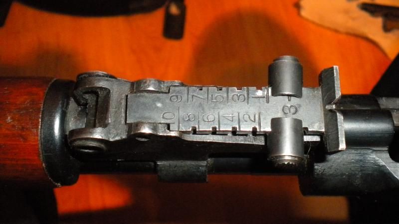

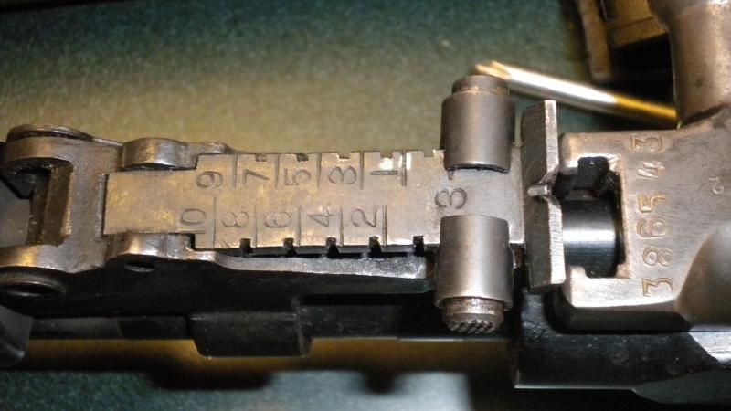

Now for the weirdest part, the rear sight leaf is very narrow, and has round barrel-like buttons.  I am unsure about whether that was added later, and crimped tightly to make it appear normal. IIRC the distances were different too.

Isn't there a Hunter or Sporter version that has the rear sight leaf like what you are describing? Do the increments only go up to 300 like the Saiga rear sights do?

Sounds like a late gun, possibly scrubbed aswell.  The rear sight sounds like an AK replacement to me.   wink1
Kind of wondering too LC, that's why I asked about the increments. Although, as I mentioned, I do recall a commercial version with a similar sight. I have had a few late model SKSs that had the ribbed machining in the barrel. Of the three that come immediately to mind 2 of them were pinned barrels as well.
Polytech Hunter has a dif leaf with left/right adjustments, but its not how he described this one.

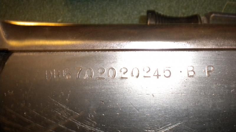

First of all, it is a DB, which explains the similarities to the DP I recently was eyeing.  Among other weird things I noticed that it has an unusual BHO mechanism, and the ejection 'port' on the side of the receiver has a diagonal cut to it at the rear rather than the usual rounded off look.  The RSB seems to be cast, and the sight leaf appears to be original to the RSB, I don't think a normal leaf would fit in it...although I could be wrong.

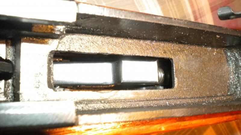

The milling on the receiver is so rough that it almost appears to be cast from the inside, although it does lack the pins present on those as well...the outside looks much nicer.  I initially thought it was scrubbed, but it was just grimey as hell, and was a grease smear over the serial.  The only non matching part I could see was the bolt carrier...I didn't check the gas system, as it was on there pretty good, I was covered in grease...and they had a glass counter. nailbite1
I was mistaken about the BC matching... well anything....but at least that explains the early feature on a late gun.
I only was able to get a couple pics...The proof mark on the BC is a little odd, I haven't seen that before on a Chinese...not that it goes with the gun, I just found it interesting.  There were also some stamps inside the receiver.
I looked up AK sight leaf pics and didn't find any quite like this one...although they are similar, this lacks the groove in the center, and the '3' is not in the same place you would expect to find them on the examples I found.  I don't know anything about AKs at all though.

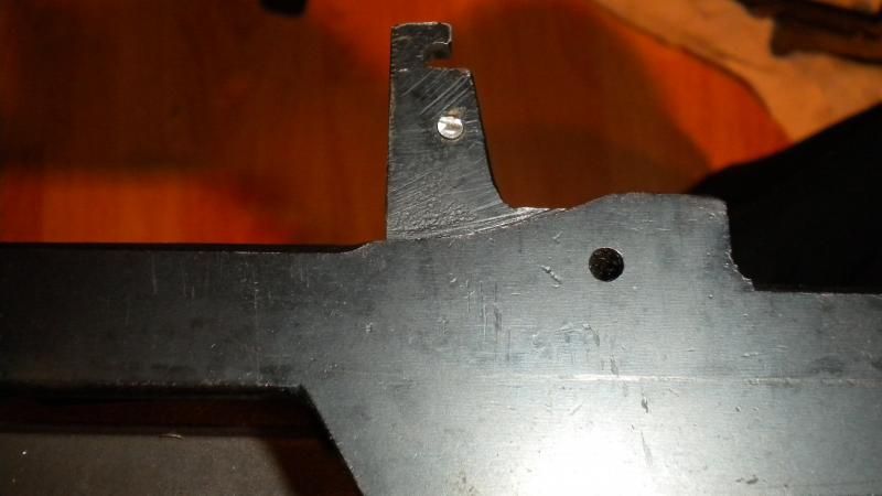

Looks like a "3" marked chinese leaf with an AK slider. The bolt hold-open is off a commercial gun... cant remember which one.

Regarding the leaf, does that seem like an actual AK leaf?  All the ones I saw photos of had that center groove, and they all seemed to have the 3 III or n <-cyrillic off to the left side of the groove, where the 3 on this one is in the center.  Do they indeed swap out with a normal SKS leaf?  The front sight is pushed all the way to the right so if it was replaced that could explain that.  It looks to be in the same condition as the rest of the gun, so I suspect it has been on there for quite some time....if not always there.  The PO also applied what looks like Liquid Paper to the sight post, and a dab of red paint or marker on top.  thumb1

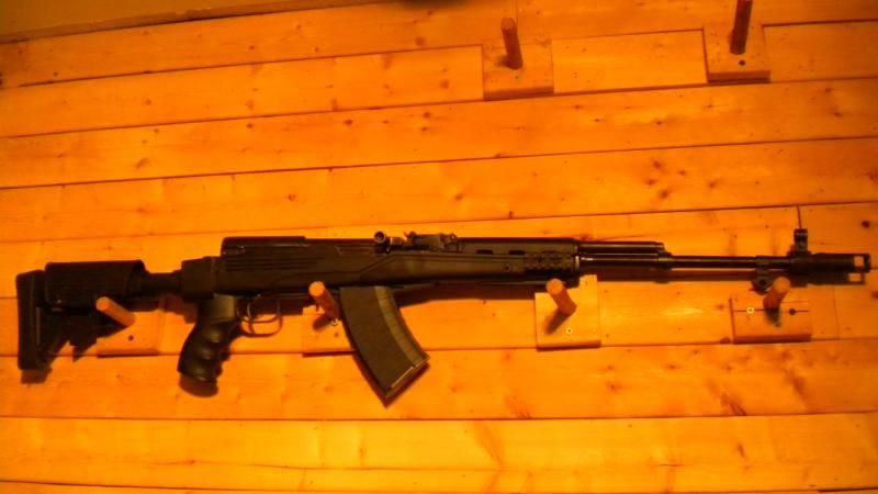

As issued by my pawnbroker...in an ATI Strikeforce that is so loose and sloppy it makes my ATI Ultralight from years ago seem as stable as if it were made out of an ivory tusk.  Gouged in all the wrong places for fitment...I think this was Junior's first gun.  Missing the bottom rail...bleh.  It came off immediately.

This is what got me all jaw dropped n stuff when I first saw it....apparently an AK style sight leaf.   The uniform crud in the buttons and under the leaf compared with other oft neglected cleaning spots for the average schmo buying an SKS lead me to believe that it was possibly imported this way.

Y'know that weird square thing on the sides of the receiver on most SKS's?  That is not present on this one, instead a hole that passes all the way through.  Perhaps an unutilized section for select fire?  I always wondered what those square things were on all my other SKS's, but never thought much about it until now.
The other side of the receiver, notice the pitting in the joint for the barrel.  This does not appear to be due to corrosion, but from casting. More on that later.
Further evidence of casting...maybe?  There are several places that show the granular nature of cast metal...but others that seem to be machined...particularly on the outside.  The inside is very granular too...and considering the PO seemed to use some sort of heavy grease to lube the bolt, I don't think it is corrosion, especially since it only appears in places that don't seem to be milled.
This section of the receiver has me thinking that this was cast, and then later machined to tolerance...it is solid metal, but looks like several pieces pressed together.

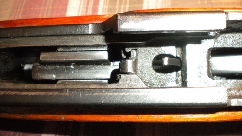

The funky bolt hold open...never seen one like it, appears to also be possibly a cast part, or it could be filth...very well attached filth.

Here is what she is looking like with a borrowed stock, bayo, and mag....and with the tactikillah scope mount instead of the rattlebox the original is....with a ridiculous scope.

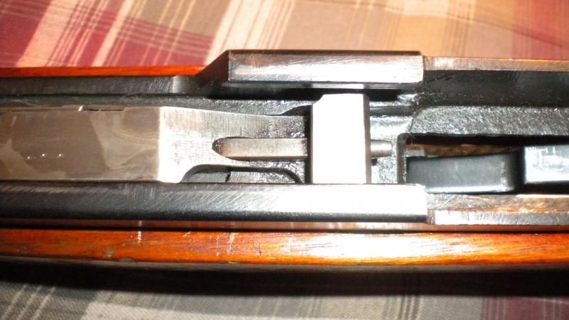

That absolutely boggles my mind!  The square piece is a piece of hardened keystock.  It performs one super important function: when the bolt locks in battery, that square edge is what holds the bolt forward in battery.  It, along with the angled portion at the bottom back of the bolt most certainly determine proper headspacing.

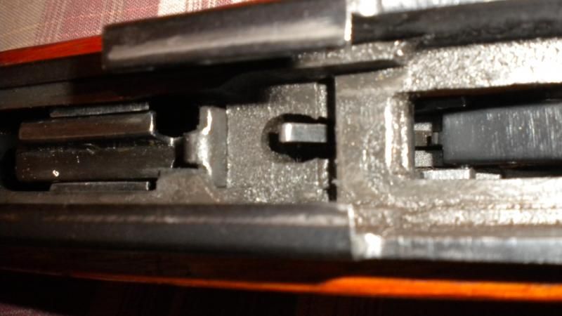

Could you do me a favor?  Take some good photos of the inside of the receiver with the bolt in battery and let me know what that bolt is actually locking against.  How much play does the bolt w/o the carrier in place actually have when it's in battery?
At first blush I don't think it's a cast RSB...at first I thought it's what I called a 'mid' on the survey, it's definitely not an early.  Then I saw the side with the gas tube takedown lever and it really looks like a late, just cut with a dull butter knife:
Maybe the orange peel effect is from heavy pitting, or it may truly be cast and was made from a completely different mold than what we've seen before?

I'm with RM, what on gods green earth is the bolt locking against?    :o :o :o
The plot thickens...it appears as if the hole is supposed to have a pin going through it....right where the keystock would be.  Is this even safe to fire I wonder?
I compared it to a 78 /26\ and boy is there a lot different going on under the hood with this one.  Not being particularly aware of what exactly goes on in there I welcome any advice.  I seem to remember someone doing a animation of how the bolt system works...but I have no idea where to find it. Stupid lack of search functions...there.   There does seem to be some banging around in there which might explain the replacement bolt carrier. It appears almost like someone fired it without the recoil spring in place once....if that is even possible.  There are a couple dings in the back of the receiver that seem to indicate something going wrong at some point...but it could of happened when they were 'fine tuning' the internals.
I did find that this has dead rock solid neutral engagement, and it seems as if it may have had a trigger job,  although I don't see any obvious replacement parts...but it is smooth as I have ever felt on an SKS. Dropping the buttstock firmly on the ground a several times didn't get the hammer to drop, so I have that going for me. :)
I really need to get this thing super cleaned up, it is still really grimy internally.  The pin rattles, but not enough for my comfort...and I gotta strip the stupid cold bluing off the bolt carrier.
I must say, I am pretty convinced that the RSB is cast...of all things on here.  It is strange, I don't think the DP I saw was, but the gas block certainly was.  Its been a few months, I also fear calling to see if it is still there...as I have run out of skateboards to sell.  chuckles1

I think we need to get to the bottom of this before you even think about firing this one Justin!!!!
With the bolt, magazine, and trigger in the gun, but receiver cover off, push the bolt forward as far as it will go into battery, then press down on the top of the bolt (this is what the bolt carrier does when it moves forward the last 1/2" or so).  While still pressing down, try to pull the bolt back out of battery.  If it moves more than 5 or 10 thousandths, then you've got a serious problem.
This is very scary....  even if the headspace is set and its "supposed" to be this way.
