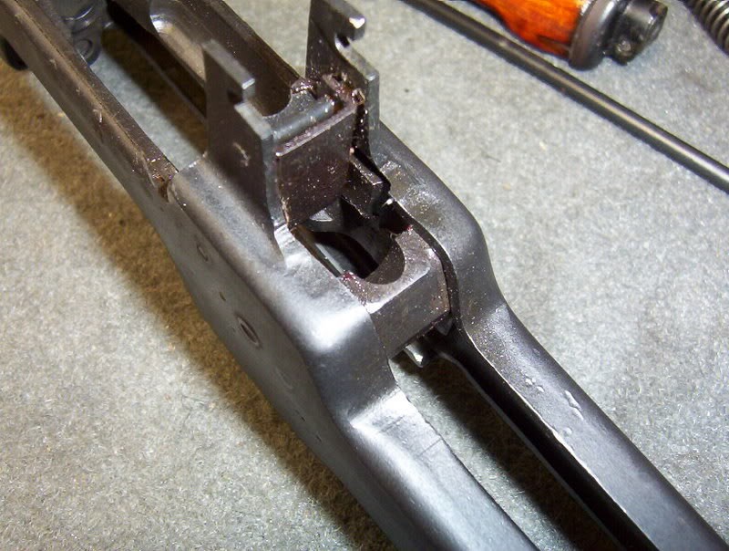

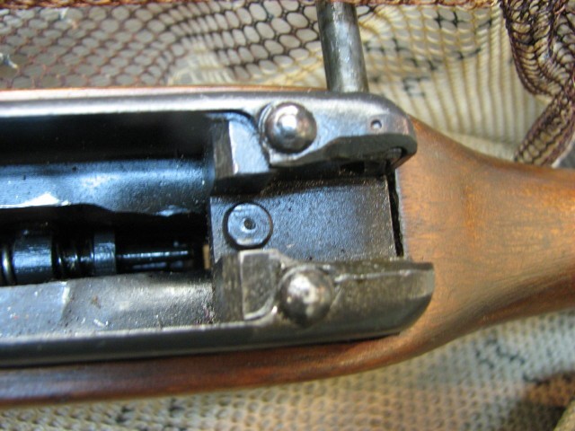

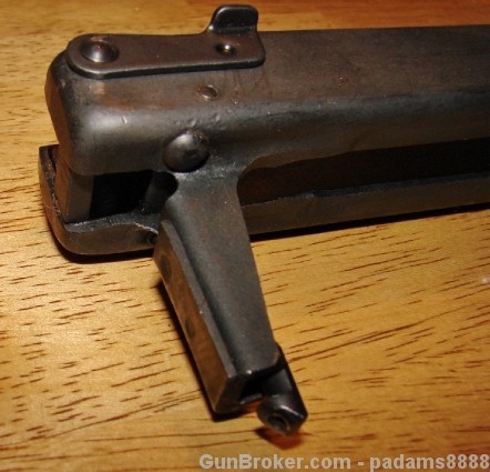

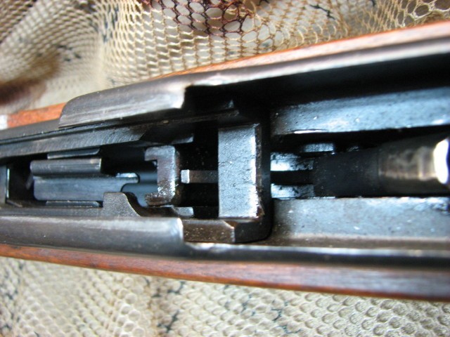

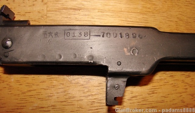

Here you go Bob,
They are unique and interesting and ugly and finicky and the stocks tended to crack badly due to point pressure from the individual rivets.
They certainly helped to troubleshoot the T63 design when it was upgraded in 1968.  thumb1
Thanks RM! What's the market price going for these days?
No idea.  They were never tracked back in my tracking thread days.  It depends on condition, and whether the seller and buyer both know what they have.  Some can be had for pennies on the dollar, while others can't be touched at $1000.
If I was forced to guess, I'd say avg. price on Gunbroker these days is ~$750 when at least both parties knows what's for sale, but I've been out of the game for almost three eyars now so the times have passed me by.  Prices are much higher than they were in '16 for certain!
Correct me if I'm wrong here, but that stamped receiver looks like it uses a cast "trunnion" of sorts with the receiver shell wrapped around it? Why in bo-diddly would they go through all that to circumvent using a one piece receiver? That makes zero sense to me.
Okay, there's got to be a simple, "duh" explanation here.
#13
Firstchoice...  your right, there is a large trunion that goes from the barrel clear back to the mid-tang and just has sheet metal wrapped around it.  Makes no sense to me.

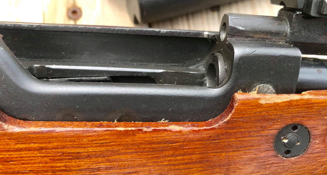

Here's a few pictures of mine. It was in a tapco stock when I got it so I modified a wood stock for it, still need a better matching handguard. You can see where the previous owner had ground down the front rivets some.
