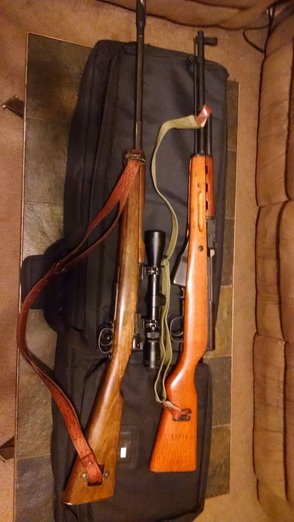

What did I just buy? Lol, I know it sounds bad just asking but I found this and the SKS on fb  for 700, I offered 550, he countered with 575 for both? I said OK? He says its a Mauser rechambered for 308? I have about 10, 000 rounds of 7.62x51 with no rifle to shoot it with?
How did I do? I'm not a Mauser guy and hope I did alright?

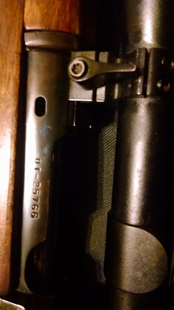

What's marked on the receiver rail? Or receiver ring. And is that a muzzle brake on the end?

It's a M1916 Spanish Mauser, 7.62 is not the original caliber, it was 7mm originally. Most of the M1916 Spanish caliber converted rifles carry the OT serial prefix. Beware of hot hunting loads, they are a weaker two lug design, not the stronger K98 3 lug design.
OK. That's a Spanish Mauser. Heavily chopped & butchered. Should be fun to shoot!

It has been met by Bubba, its not the worst Bubba has done but I'm not loving her right now, gonna treat her like a stepchild....
