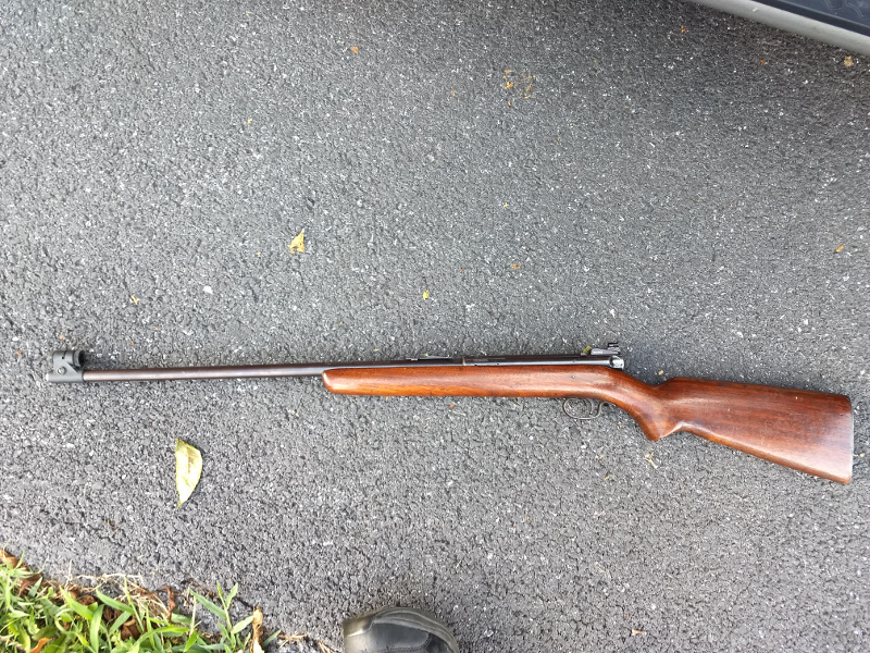

Another I scarfed up on when I got the TU 33/40... Figured hey, it's old and it's a Winchester, not one of the more well known models, but a Winchester none the less. Actually, until I saw it, I don't remember really ever seeing one or maybe I just looked over them. It's a butt stock tube fed design, it's Winchesters third semiauto rimfire rifle.
These have a interesting history, some were shipped to the Britain as lend/lease trainers or some say basically to be used as last ditch weapons. The first year of production in '39 and 1940 was a .22short model with a 24 inch barrel, production stopped in '43 due to the war, the last year, 1955 they offered a grooved receiver for scopes. This is the most common version, the regular .22lr with 22 inch barrel, Winchester serial dates it as a 1950, total production is just over 100k.
One down side, someone added a Williams peep sight and front sight...at least it was a tasteful modification.

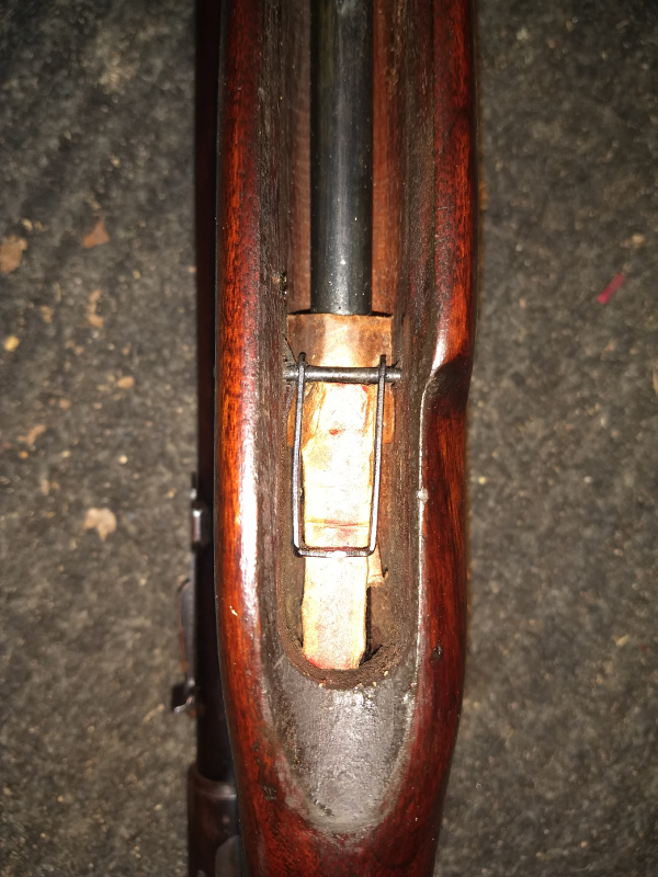

The missing trigger return spring, I figured out a piece of cardboard worked to return it.. after 170rounds, the trigger operation hasn't missed a beat yet. I adjusted the magazine tube, now when you load it, and cock it, that first round pops right in the chamber, before, it was a hair too close, the rounds would usually wedge up at the top between the barrel and receiver.......when it did actually fire.

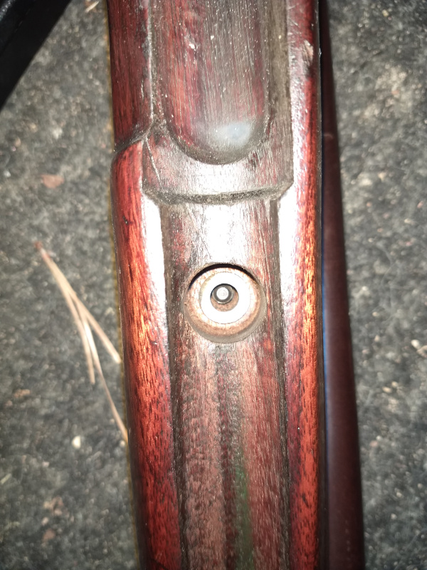

I found when I tightened the action screw down, the whole action kinda bowed just a hair, so I stuck a washer in the only mounting screw hole, no more bowing I can detect, and it still fits tight.

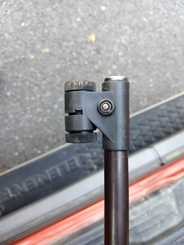

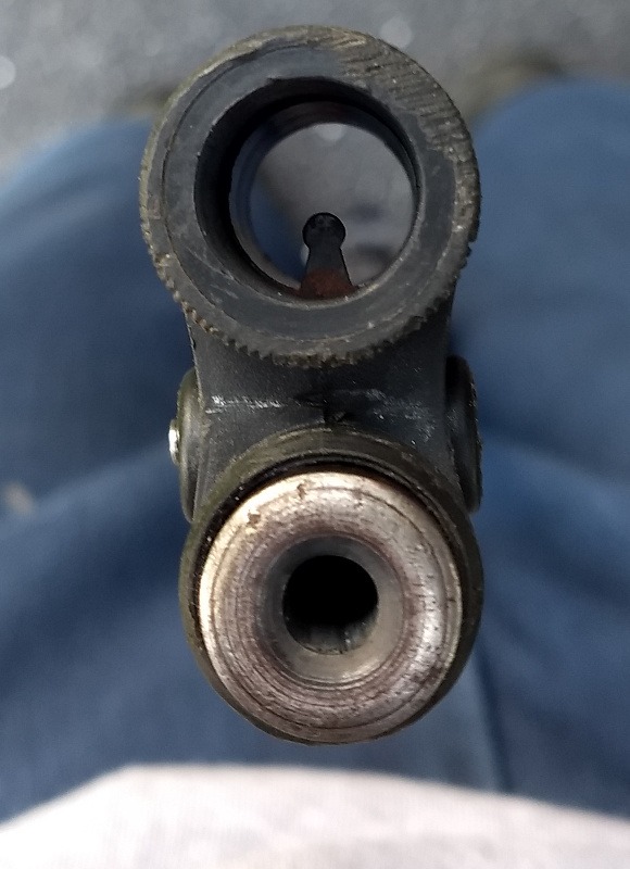

The barrel crown looked questionable... so I said screw it, I took a ball bearing and a gob of valve grinding compound and went to town on the crown.. Also, I changed the front sight(see above, it had a blade style made by someone, I found it was too short for the rear sight). This front sight is now a cheapie plastic globe sight off of a Crosman model 3100 break action pellet rifle that I had probably before I started high school(dammed if I know why I still have it, I don't even have the rifle anymore). The cheapie globe sight sits high enough to allow for some rear elevation adjustment, instead of it just barely hanging on the bottom of the sight. After some work to the base of the sight, which I basically bored the base out .020 inch, just enough to fit the Winchester barrel, the mounting screw fit right through the empty dovetail left by the blade sight. It fits very tight, with the screw installed, it will not move.
It looks like this now, kinda has the commie rimfire trainer look to it, but overall, not a real big change. I discovered in an earlier session, the rear sight loosed during firing, also it didn't quite fit the radius of the receiver. So....I lapped it to fit the receiver with really fine sandpaper, then used threadlock on the base of the Williams sight peep and threadlocked the mounting bolt.
