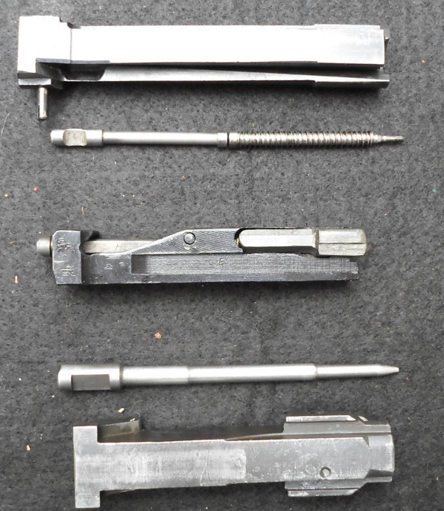

Carriers
Bolts
Bolts, the Hakim and Mas 49/56 firing pin have been pulled, the Hakim you remove an tapered pin, it's snug, but pushes out, the firing pin is 3 pieces, the firing pin, a firing pin extension and a firing pin spring. The Mas, you could swap in 2 seconds, once the bolt is free from the carrier, it falls right out. The Mas like the SKS is subject to slamfire, easily enough fixed, a small alteration and it's not a big issue.
[/img]https://dl.dropboxusercontent.com/s/06uuko8j53s7cu9/SAM_1351_zps8fab503b.jpg?dl=0[/img]
Bolt face, extractors, bolt and carrier mated together for reassembly.
Hopefully this will help those who have never seen the inner workings of a Hakim or Mas semi-auto.

I just got off the phone with a friend of mine, a collector who owns the MAS I've shot. He was warning me about slam fires. I guess the MAS has the free floater pin like the SKS too?
French jokes bat1
It is a pleasure to shoot, I bought a bunch of 7.5 French when Aim had it.  As for the sights the Mas 49/56 sights are updated from the Mas 49. I also have 4 Mas 36s, 2 of which are bringbacks, one is papered from Veitnam, and a Berthier in 8mm Lebel. Back in the day France was the innovator in firearms. The first to produce a smokeless cartridge, the 8mm Lebel, also the first spitzer designed bullet in the same caliber. They are a rifle all to their own, and I enjoy the crap out of them.
Slam fires on the Mas are not an issue with milsurp French ammo, the commercial stuff it can be, with soft primers. At one time there was an aftermarket light weight titanium firing pin, I have one, now they are rare to find. You can do a slight modifaction on a orginial and it helps prevent the slam fire. Original firing pins are readily available and the modifaction is simple, basically blunt the pin. Instructions for the modification are easy to find.
