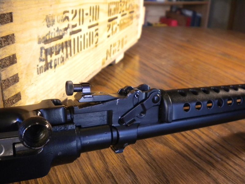

Loop takedown lever...and a Genuine Norinco BEC steel scope mount....which fits like a glove on a very snug bug...we are talking return to zero for sure without any further Bubbage needed secure. I hate how secure it is. A lot.
William's peep sight along with a two piece Chinese gas tube with the obligatory Bubbattachment for the kitchen...
Looks like it means business, don't tell it that it has been neutered...more on the innards later. Heck, it is New Year's Eve...and despite this being my first one sober, doesn't mean I don't have **** to do.

Congrats brother  thumb1
Your first Russian eh? You know the old saying about opinions right....something like every A-hole has 1 ...or something like that I'm sure  rofl but....I say FULL on restore that bad boy and move all those Bubba parts ( gotta admit for bubba parts they are sweet as I'm sure you know) to 1 of your other cool project guns.
I mean damn man....you got a righteous 90degree gas block there. thumb1 NOW spill the beans on that bolt and carrier and firing pin buddy... inquiring minds want to know....
