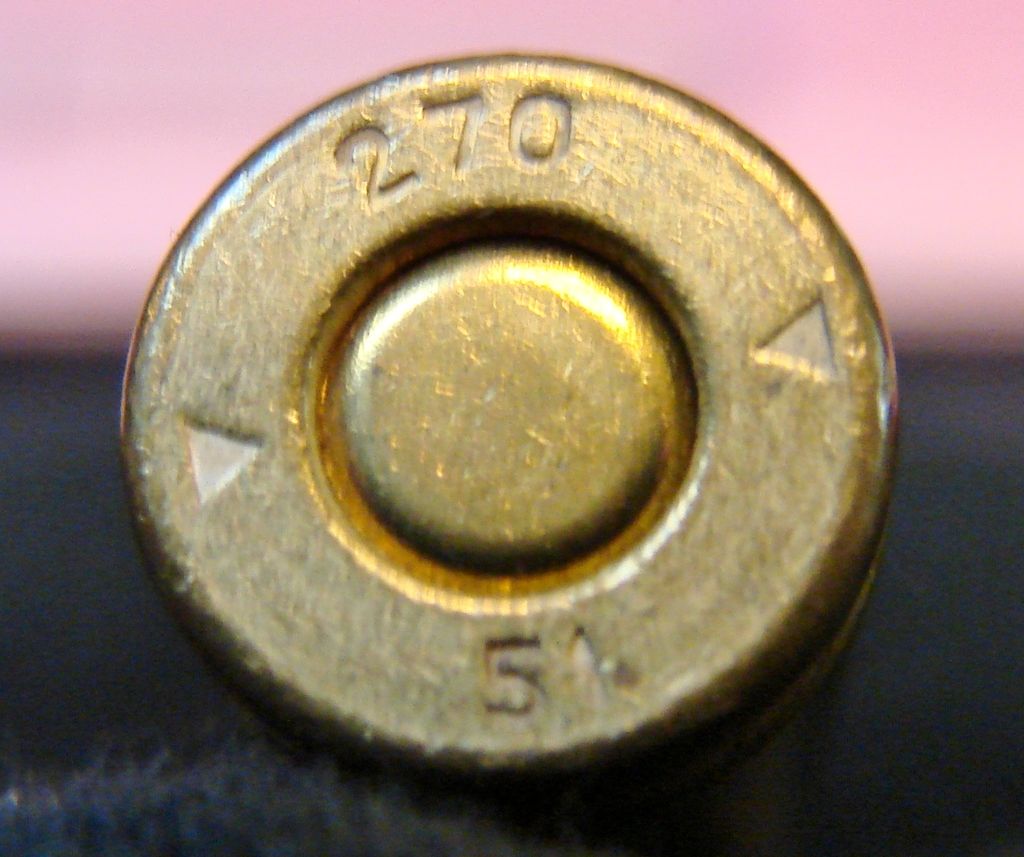

Going through some of my x39 ammo yesterday and came across this 1951 Factory 270 (Lugansk) round....besides being in excellent condition, what threw me off was It looked to be brass cased at first, but after the magnet check I can only conclude that it is brass washed...??? Did the Soviet Union even do that?
Quote from: padams8888 on December 19, 2015, 04:41:31 PM
You've got very strong evidence sitting in front of you that they did :)) That's definitely the Lugansk factory code and "yellow brass washed" (65/35 Cu/Zn) is just a bit of extra zinc away from "copper washed" (or red brass 85/15 Cu/Zn), so process wise I would think it's similar.
