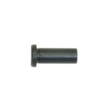

The rivet is simply a straigh round shaft with a recessed or counter bored end when new.  When installed, the end is flared to keep it tight and from coming out.  You can reverse this process by using a drift punch or similar to drive/push the rivet back out and the flared portion will simply fold back to a cylindrical form with no flare..... Flip bayo and reinstall and flare with conical or round object in a vice.  This is the same way the rear sight block cam lever for the removal of the gastube is removed and reinstalled.
Here is a new one thats not flared
Cool, Thanks LC...Didn't realize you could reuse 'em.  thumb1
There is always the possibility it can become damaged in the removal process....  But it should be able to be reused atleast once before the metal fatigues and breaks.
Don't forget to use a pushing tool having a small enough diameter for both it and the unflared material to pass freely through the hole.  I dont have one of these types of bayos anymore, but you may be able to press it out in a vice with a very small craftsman sicket on one side, and a larger socket on the other thats just large enough for the rivet to clear...  Make sense?
