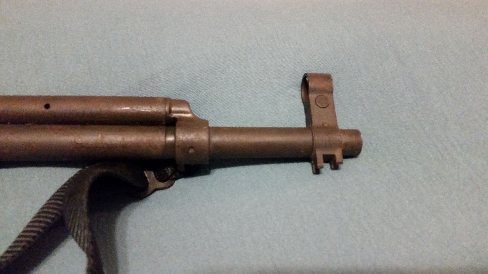

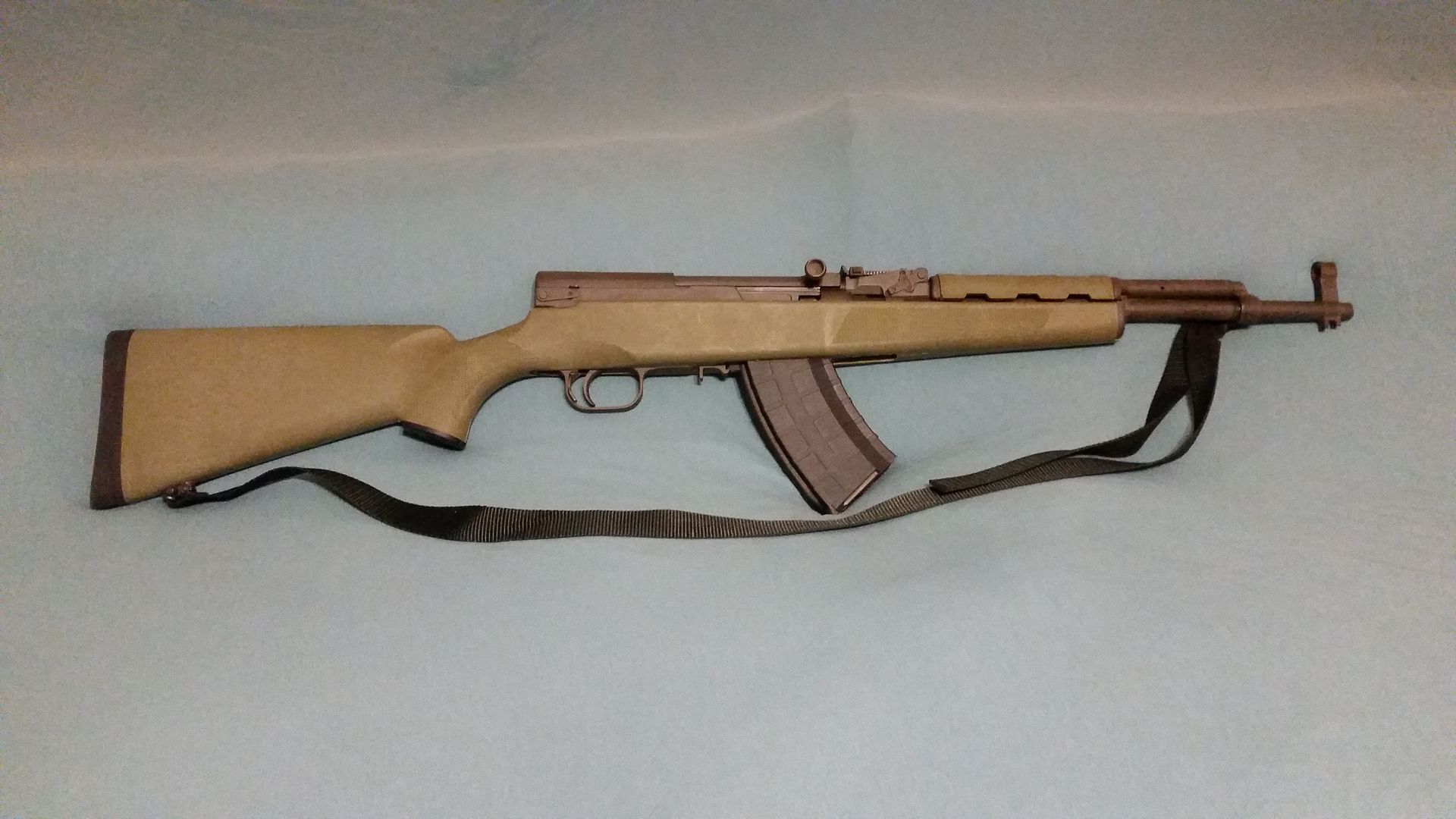

My FFL called yesterday afternoon, and told me my transfer had arrived. I picked it up right after work, but had a full night so she just rode around in the trunk of my car till I got home later that evening. I am always skeptical about buying sight unseen, because you never know what the seller didn't take pictures of.

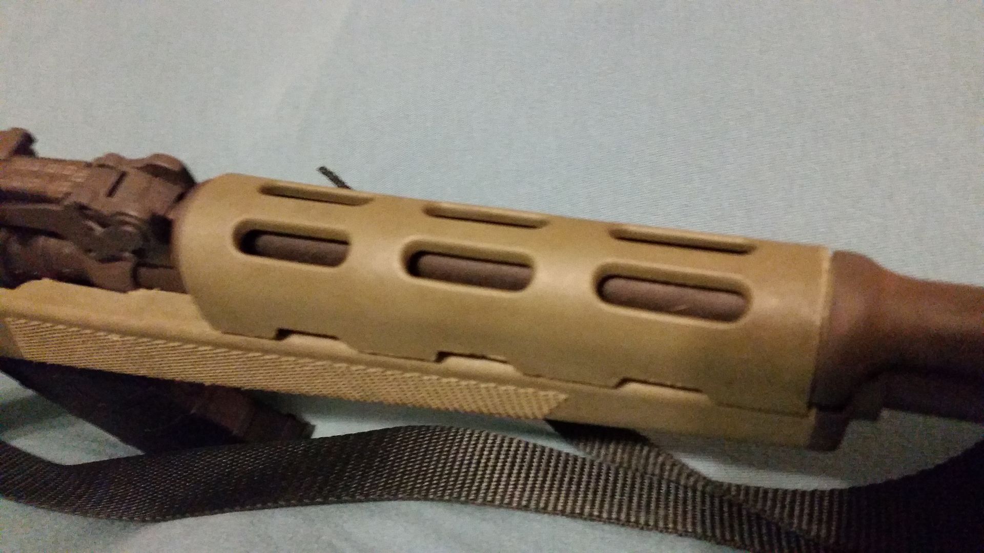

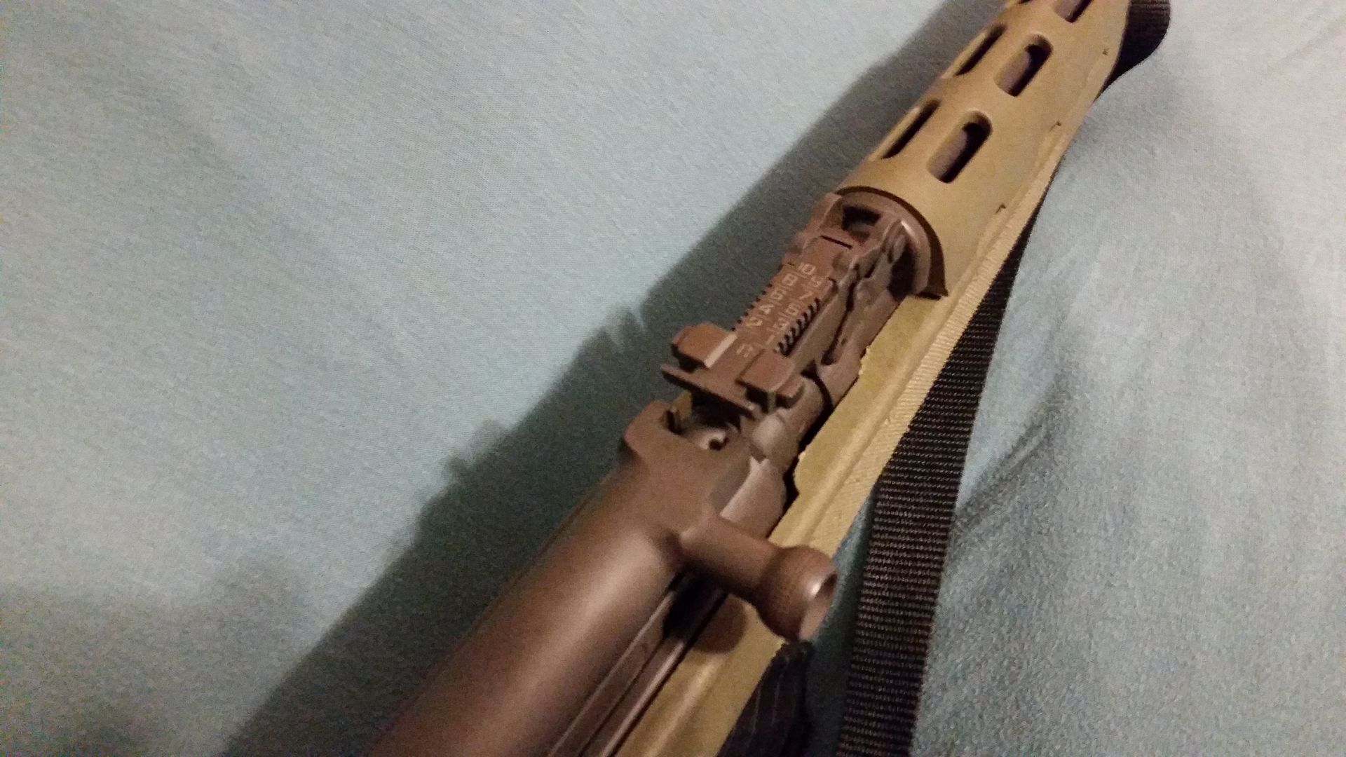

After getting my hands on her and tearing it down, I was surprised with the condition. All the bluing is in great shape, and just a little wear where the bolt carrier travels back and forth. It appears the previous owner took pretty good care of it, and smells and feels like she is coated well with gun oil.  The gas tube and piston do not match (but they match each other), all of the remaining serialized parts do.  I am very happy with my purchase, and the project ahead of me.

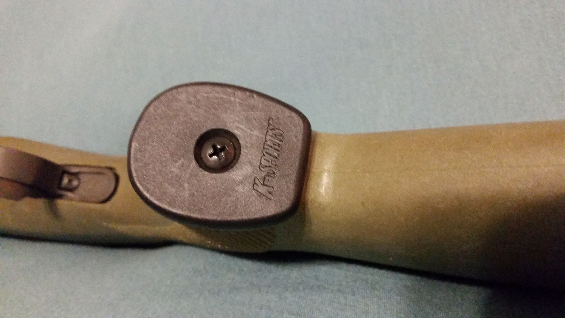

The only con is I really do not like the combat exchange stock. I do not like how it fits the receiver, and the mag well when you insert the mag is less than to be desired. This SKS did not sell new with this stock with evidence of the wooden dowel used as a ferrule pin. (never seen that before)
Well enough blabbing here are the pictures. I apologize for the indoor pictures, but it was dark by the time I got to really look her over.
This is how she arrived.
Came with a partial cleaning kit.
Hopefully this weekend I can get started fitting the metal mag liner to my donor stock I have, and return her back to the wood stock.

Toothpick for a ferrule rivet....  First for me.
Looks great man!
Lookin good bb, this is gonna turn out real nice!
toothpick...paperclip....who said SKS repair has to be difficult.  chuckles1
I wonder how long the toothpick will hold up? Seems like a somewhat viable solution, at least or awhile. The easy peasy factor is a bonus.
