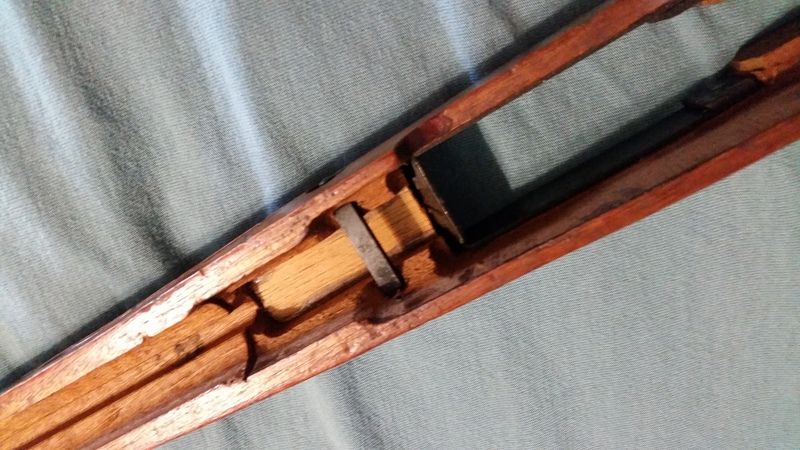

Original magwell filled with wood, then the mag plate went over that on the underside of the stock.

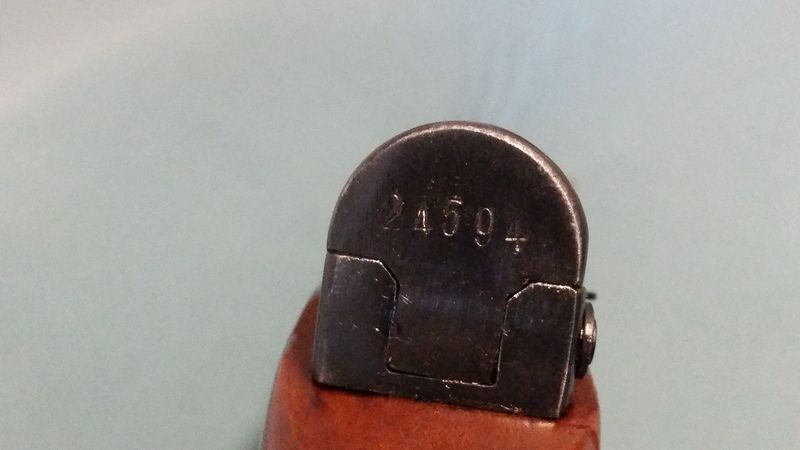

"matched" receiver cover

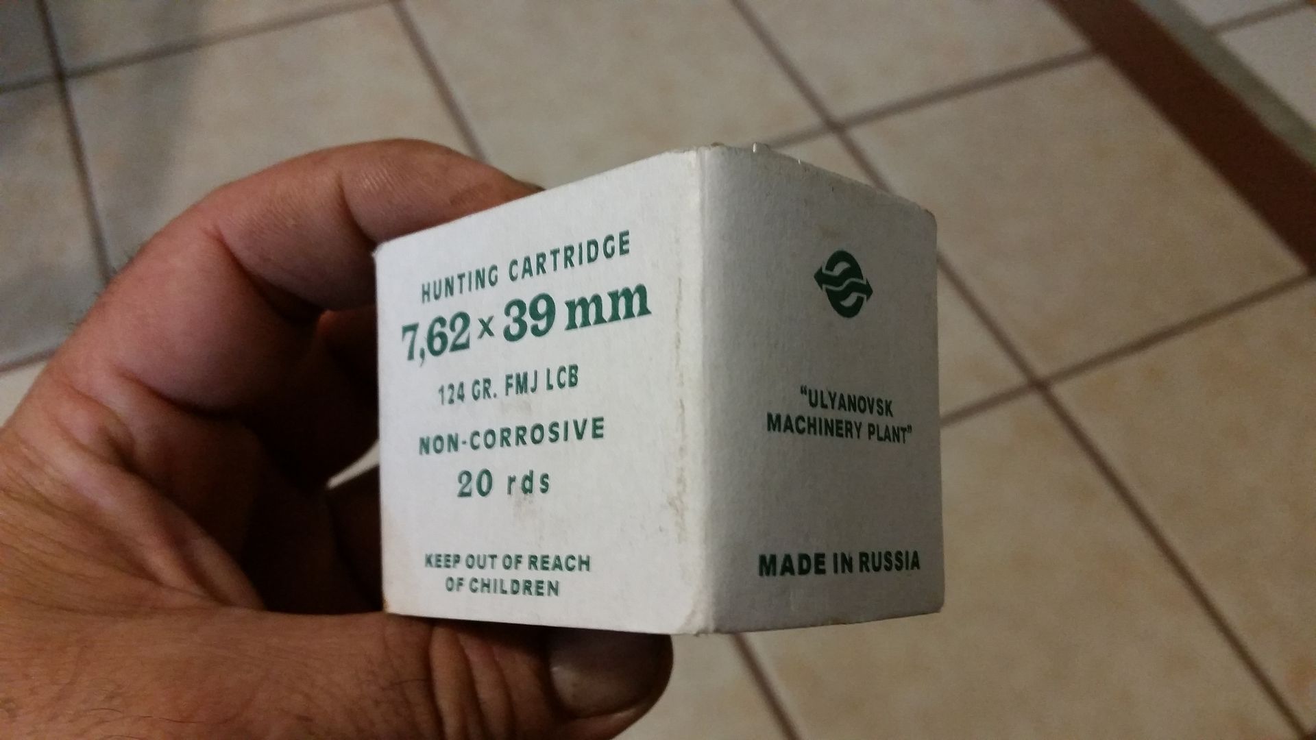

Finally got to take the Type 84 to the range. I also picked up some new ammo on the way there from a local guy (see pic below). It's 124 grain FMJ LCB made that the Ulyanovsk plant. A little research turned up that it's the same ammo as the old style Wolf Military Classic, steel cased, lacquer coated.

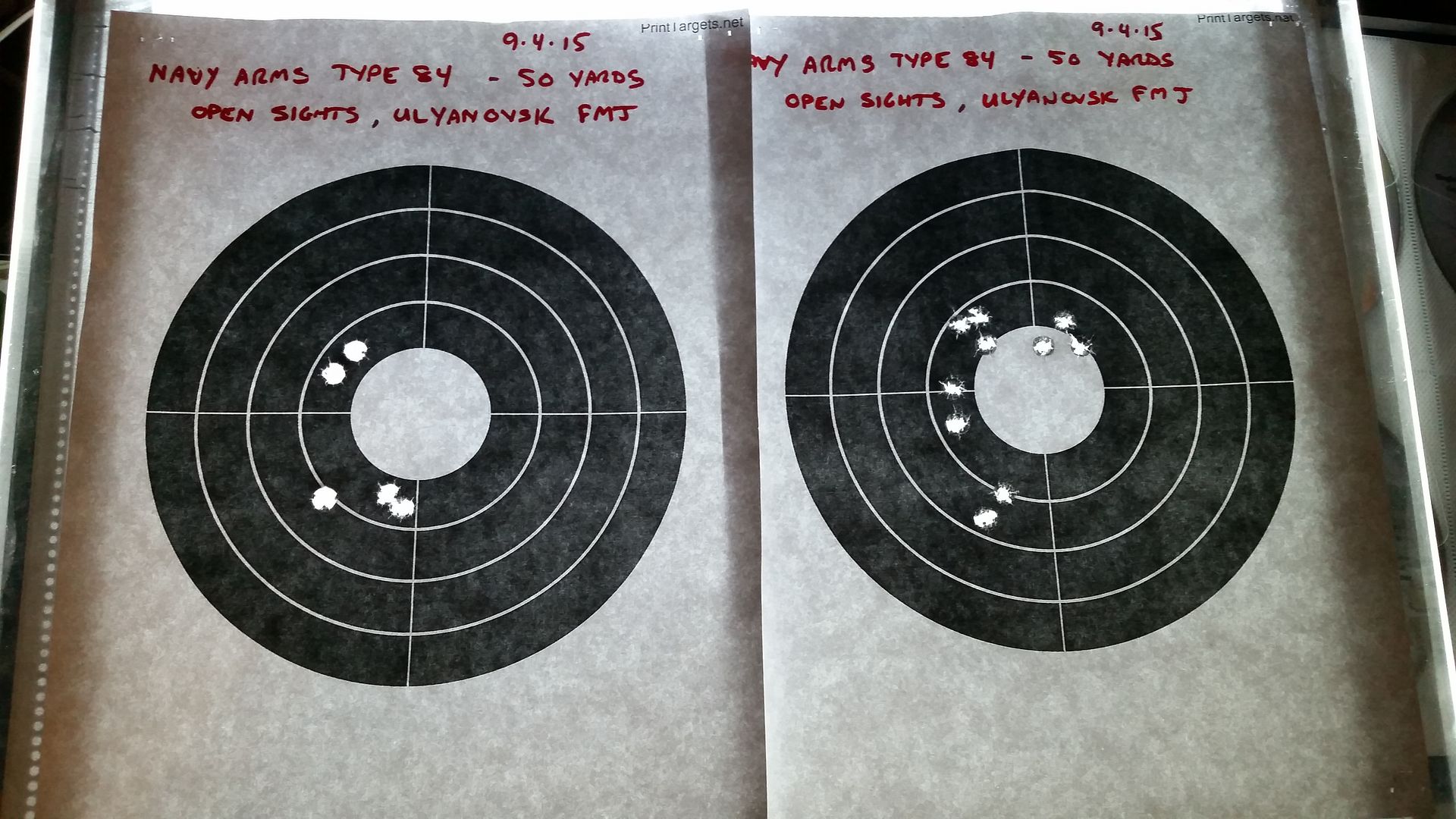

The 84 took a little sight in, but once there I was really impressed with the groups. Pics of a 5 round and 10 round groups below.
What I wasn't impressed with, is the guns reliability. The magazine just about dropped out every other round. It's not really the guns fault....it's just a poor magazine catch design. Unlike all the other AK mag guns (except the MC-5D) which use a new sheet metal catch, the 84 uses a modified stock magazine block. Both the magazine and the catch, have negative engagement angles. That means the latch angles are in in favor of the magazine coming out, not staying in. The MC-5D has the same exact issue....and also uses a modified stock magazine block with negative catch angles.

Pretty good groups there PS.
