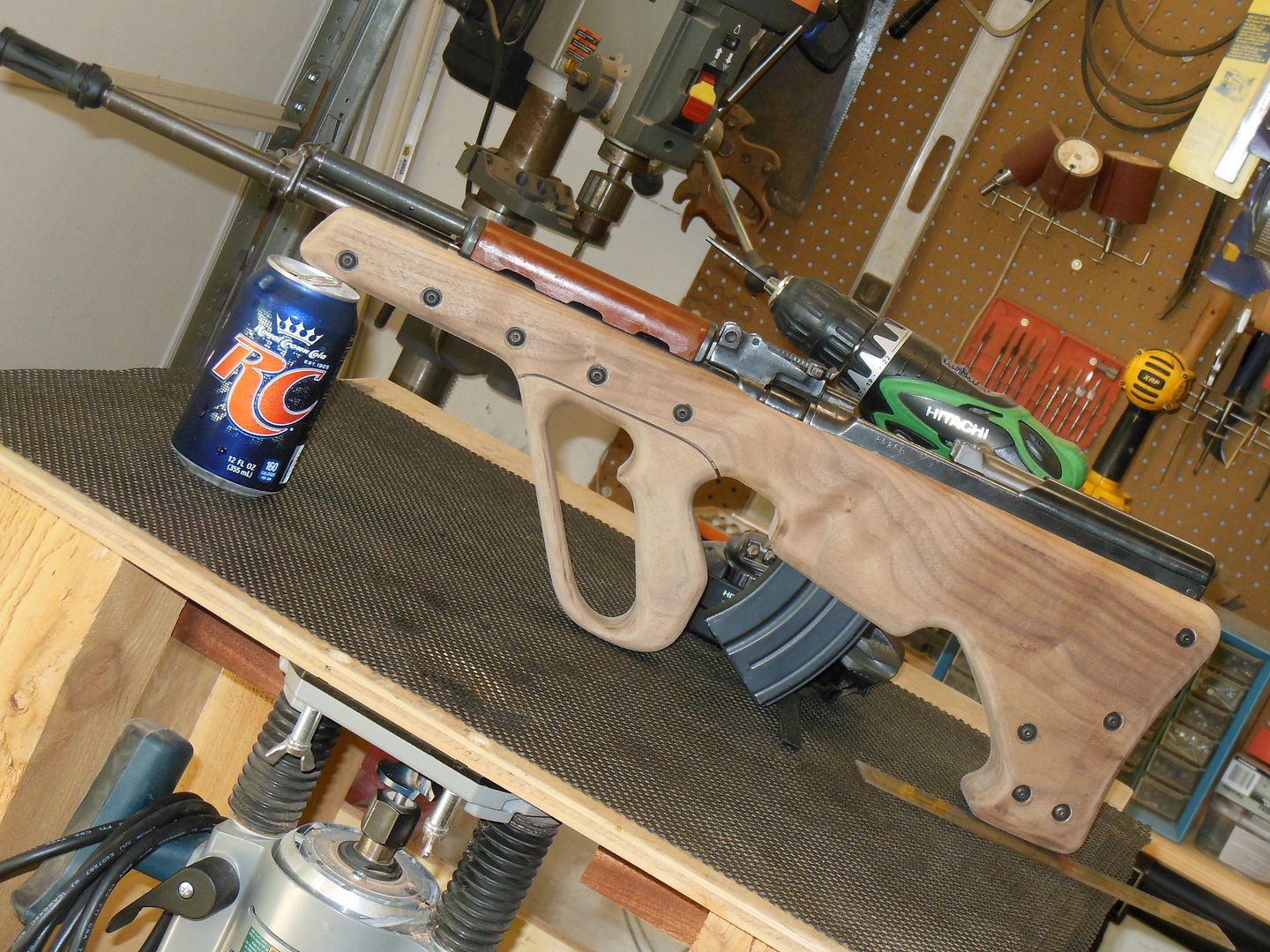

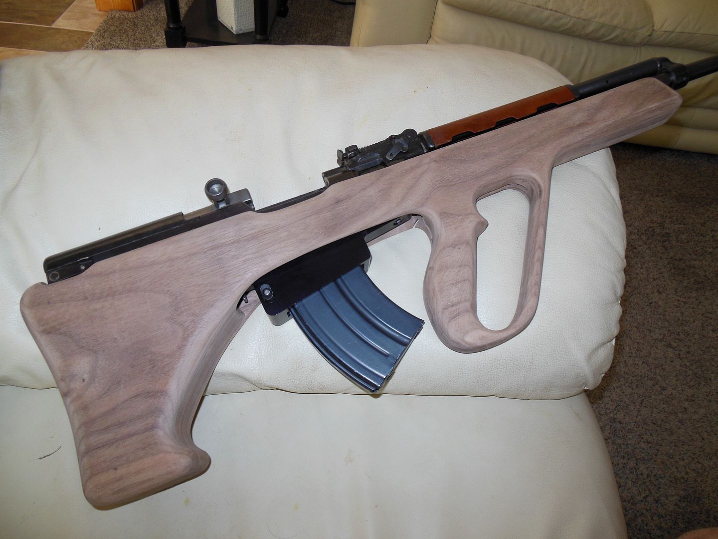

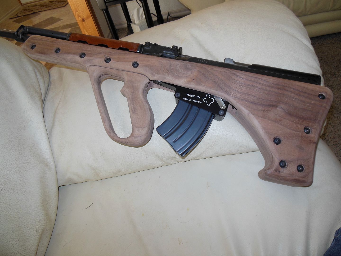

Marcus:
Here are a couple of pics of my Franken-Chinese in a walnut BP with 14 inch LOP, and one of your G9's in residence.
I have a second one in the works that has another 1 inch of LOP, because the first one makes you chicken-wing your elbow to shoot.  I will also thin down the trigger grip for smaller hands.......even mine won't fit it comfortably.
Next is the trigger, which I'll have to bury in the right side, but that's no biggie, I made the walls extra thick, anticipating the tight fit.
KTF
1mlt
Kermit, the 2 'skirts' will have to be shortened. I guess, draw a line from the front of the skirt to 'blend with the rear curve section. You need access to the cross pin than holds the mag catch bar and the ambi release on the left. Are you going to notch the stock where the mag catch bar is? Just enough so it has some room to move? Another reason why the trigger bar needs to be on the right. And trying to get to the mag release button on the right will be problematic if you have to reach your finger into a hole. Having said that, the left side has to shorter, so the ambi has room to engage and disengage the mag catch bar. The ambi 'hangs down' about 1/2" below the bottom rear of the G9 on the left side. Plus, if the skirts are there you can't R -n- R the adapter w/o taking the stock apart.

LKermit
Yep, I get it.  I'll carve on the first stock to get the second one right.  The trigger bar may have to run up and over the adapter, so that it doesn't get exposed by the trimmed skirts.
Thanks for your feedback, Marcus!

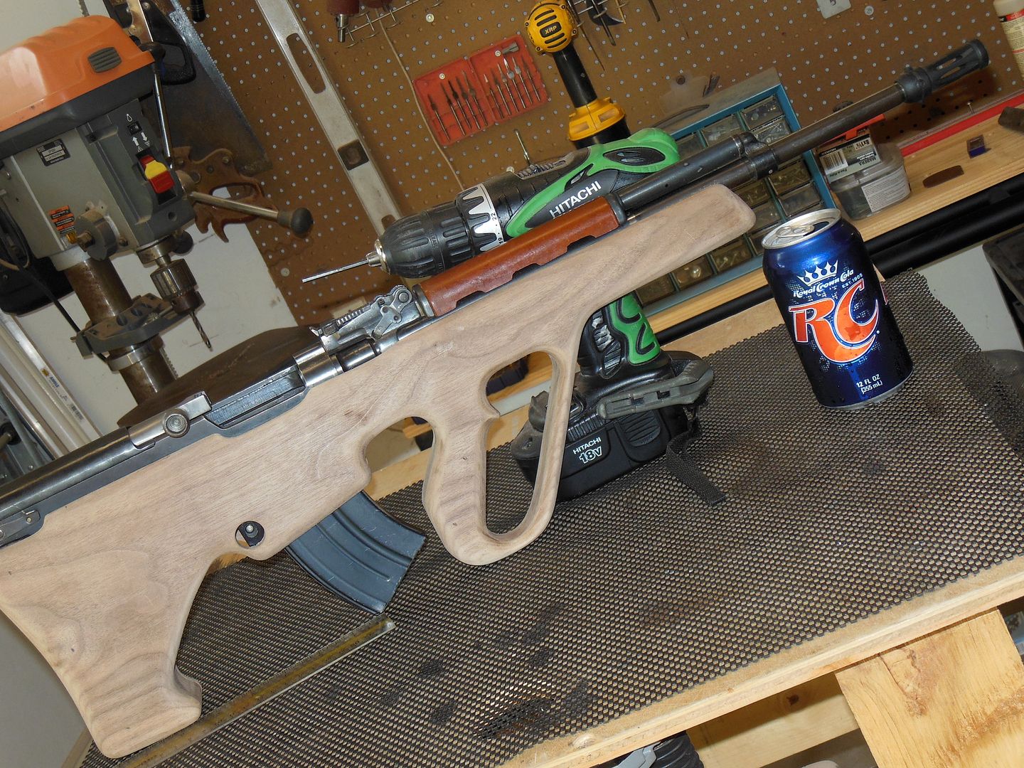

LKermit
Quote from: LKermit on August 01, 2015, 08:20:52 AM
KTF
Marcus:
Here she is sans her "skirts", and there is still room for the trigger bar.   I have relieved the side where the release lever is, so no problem getting the release to work.  What else do I need to do now?
KTF
1mlt
That should do nicely. Looks like there will be sufficient clearance on both sides of the stock now. Thanks for mocking it up so fast. How long did it take you to fit the G9 into the rifle and stock? Does the mag 'pop' out when released and can you load it with 1 finger when the rifle is upside down? That is the 'sweet' spot.
