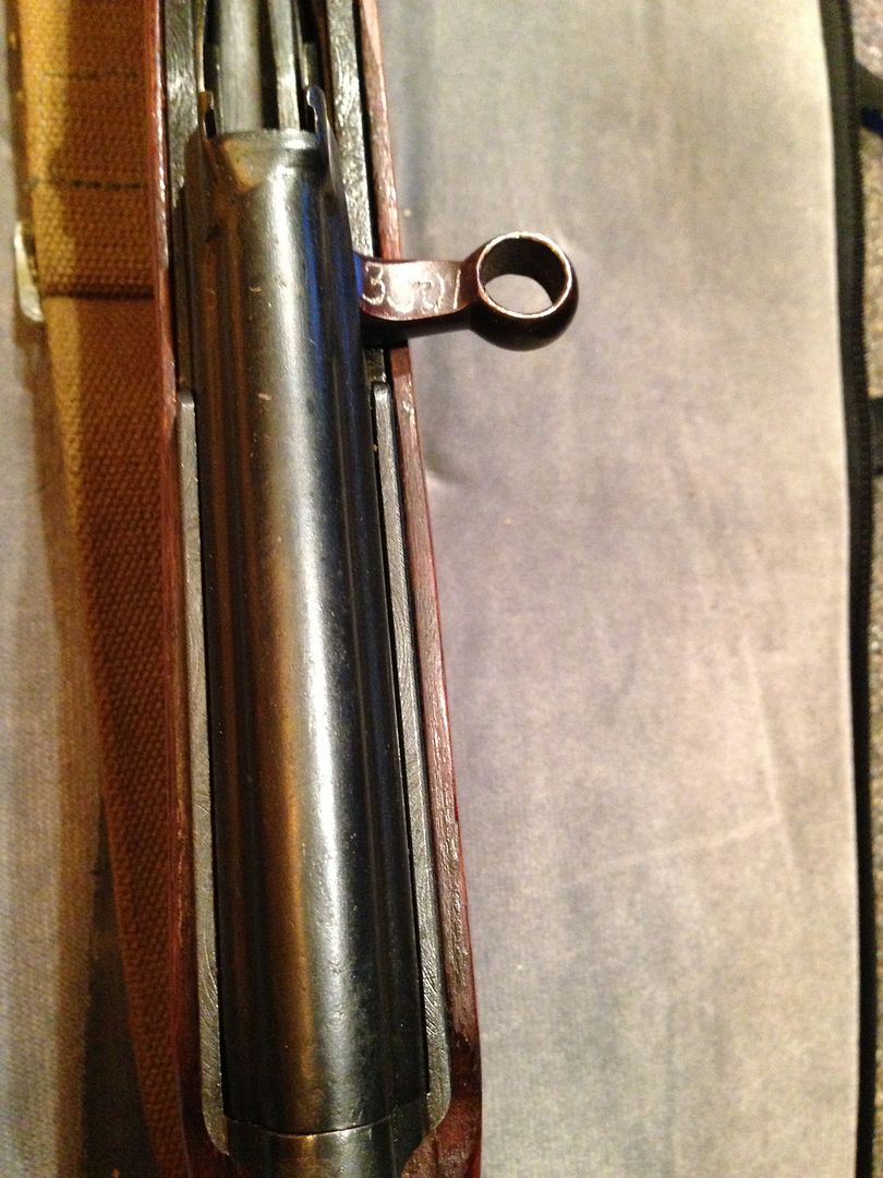

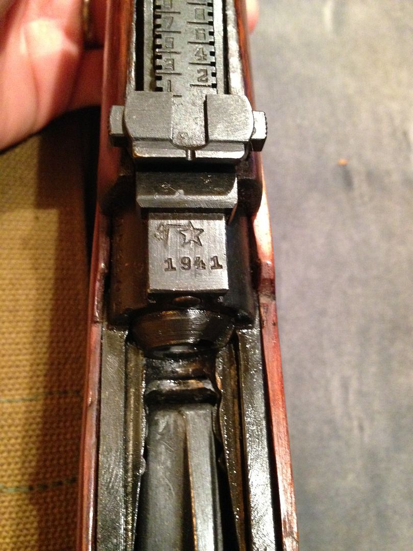

Is the bolt blued, or is it [SA] stamped?
Looks like a mint russo furb to me with blued bolt and EPs on side of mag etc.

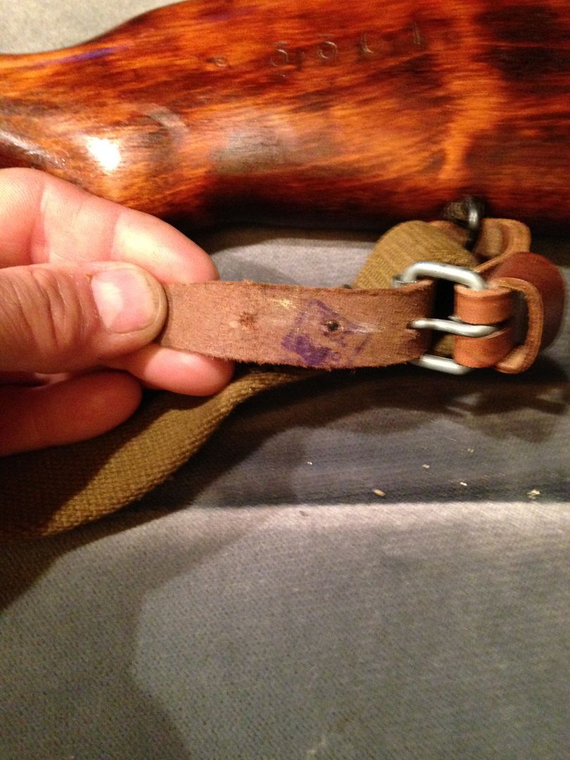

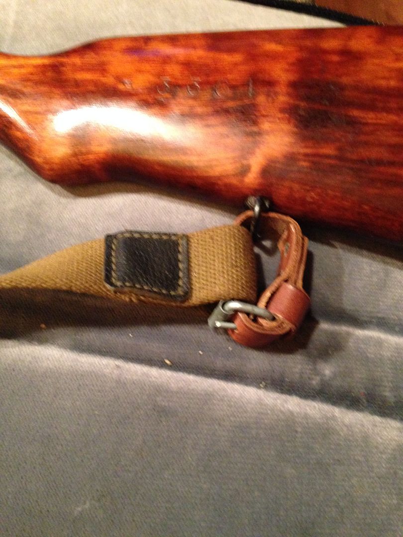

I was googling pics of SVT40 slings.  Is the sling on the rile in the pic a navy sling (for the stock with the Mosin-like slot in the buttstock)?
Thanks
