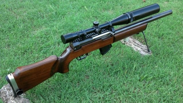

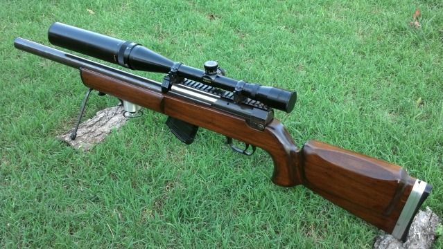

This may be easier to list the parts that are NOT custom made.   rofl
Receiver
Bolt
Carrier
Trigger Group
Return Spring Assembly

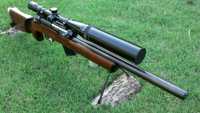

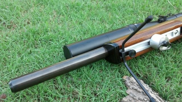

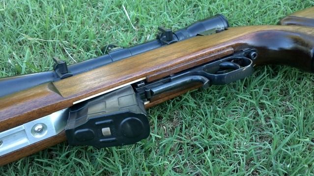

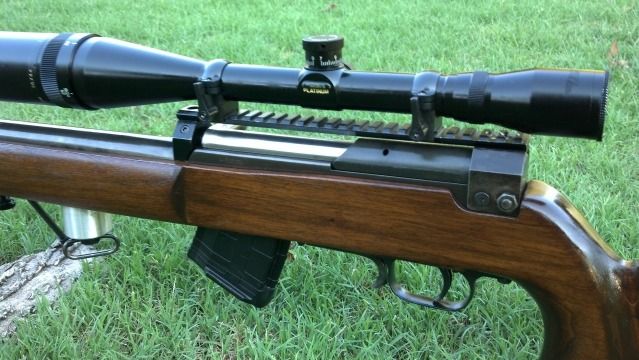

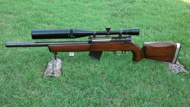

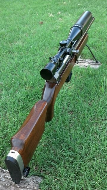

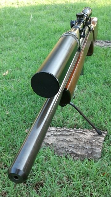

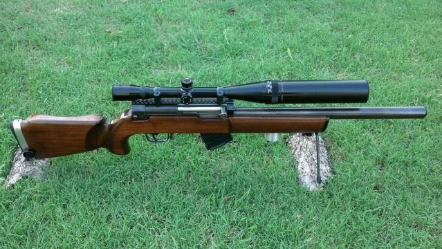

This is a single-shot straight-pull bolt-action benchrest style rifle with a custom chambered Israeli 1919a4 barrel. The action is fully bedded with two aluminum pillars. The magazine is a shortened duckbill-less Tapco and locks in similar to the marcus adapter via a custom aluminum ramp just behind the Anschutz accessory rail and is released by my custom "Talon" extended release. The stock is solid black-walnut fitted with a Vostok adjustable buttplate assembly, a solid Ebony nose-cap, and an Ebony grip-cap. The Scope rail was completely custom made as well.
Anywho...  on to the pics!
Now that is a work of art, beautiful. I saw the photos of this one back when you started it from scratch, sure came a heck of a long way!

Nice! Got anymore of those talon releases? I always did like those!
Well, they are custom built to each fcg housing and I'm never home anymore to do them.
