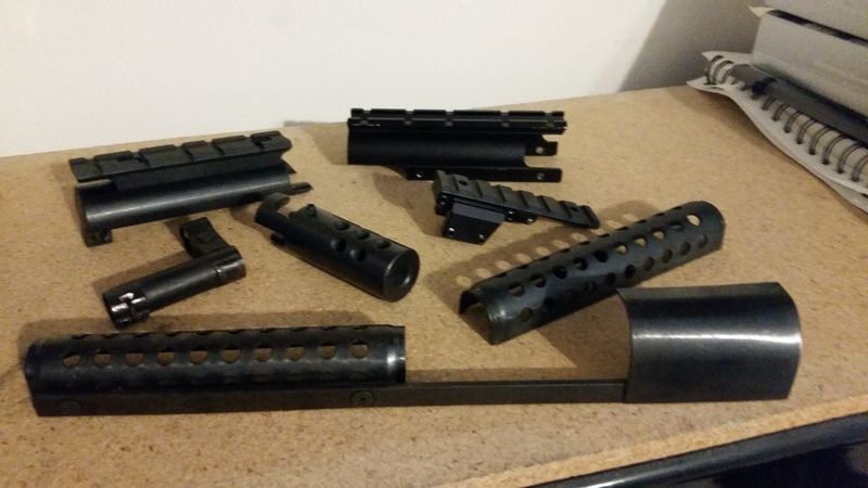

Justin, I have all the below stuff available if you are interested in any of it for your project....
Receiver cover scope mount (surprisingly stable), scope mount that drills and taps into the sides of the receiver itself, Scout Scope mount, cheese grater, cheese grater with shell deflector, very heavy duty muzzle break, and a neutered FSB.
PS:
I am interested in a few of those leftovers you have there...for this and other projects/temporary bastardizations.
Those cheese graters with the deflector are the bees knees for policing your brass, even without a scope....even used that RC mount would look real nice on my DB, and be likely to have plenty of filing room...since I had to work on an over filed mount for over an hour to fit snug as a bug before, it just is too modern for my happiness...yours is the right era for the look I am going for on that one, it would look darn proper with a Red Star scope as opposed to the silly NC Star Rail thing it wears now....I won't even post pics of it until I remedy that issue.  chuckles1
The scout mount also intrigues me for an option on this particular build since it is still open for imagination at this point.
If you have any needs I may be able to address, LMK...we could work out a swap perhaps...I have lots of leftover parts too. Otherwise LMK on a purchase price on what you have...and I will try to work that into my summer fun money budget. (What I can sneak into my bank account that wifey won't notice)  :)

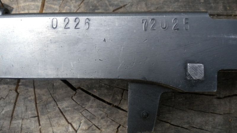

Here is the barreled receiver...she is a bit unique, so I thought I would share beyond submitting to the survey...
It is what I am assuming is a 0226 but with a plain jane series of digits rather than the arsenal stamp. The machining is quite lackluster, and the scratches and dings I am assuming are manufacturing flaws, rather than damage...unless the bluing is really thick on this one.

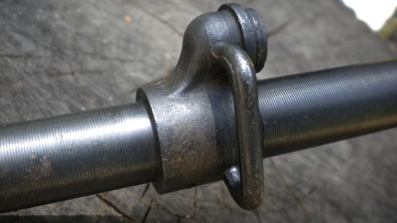

Here is a nifty feature I have only seen once before on a DP I saw last year...a cast gas block.  It has a funky look to it huh?

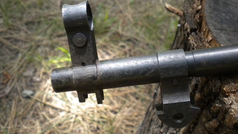

Here is the FSB....also possibly cast?  The majority of the gun does not exhibit any pitting except the end of the barrel, and the FSB...which don't match each other.  I am a little intimidated trying to remove this if it is cast...wouldn't it be more likely to break?  I suspect the barrel pitting was caused by corrosive ammo and lackluster care given....the bore is a mirror.

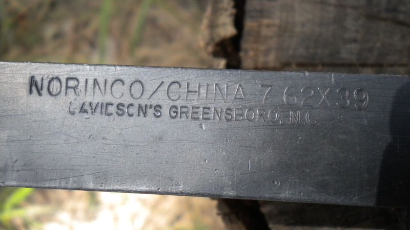

Finally, the BILLBOARD sized import stamp...a new one to me, but apparently known by the survey.

Cool...   A 1972 0226.   Odd, but like you said the rest of the gun went bye bye long ago so I say bubba the living **** outta that thing.   :)
Ill have to ard ths 0226 variation with no [] to the arsenal list.  Likely make it 0226b

I find it interesting that this one is a 0226.  Here's an [0233] & 0233 with the same type of differences, only as far as the dating theory (as best I can figure anyhow) goes these rifles were made within ~1800 units of each other.  Will definitely have to study this no [] subset of guns a bit more in depth to figure out what's really going on:
The second of these guns had a cast gas block too Justin.  '71 & '72 look to be two years where they certainly seemed to use that type.  thumb1

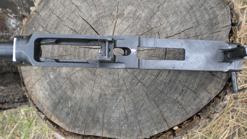

Not much to see under the hood so to speak other than this wicked milling grain...
It does appear to have been modded already to accept whatevah stock you want to put on it...I hate it when people do this.  Note the 0 stamp too.
A shot of the whole underside if you were looking for milling differences...
