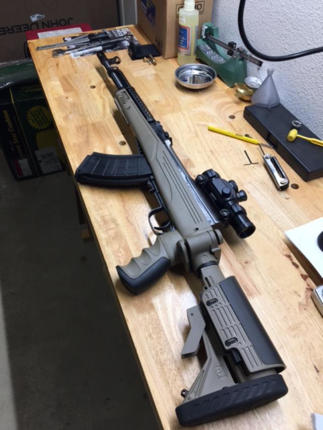

Thanks for all the info. We cut it today. Came out at 16.25. Modified the front sight so this will be a press on and one pin deal. We were able to chuck it up after the cut and machine for the sight and then cut a little deeper for the threads. Ordered the die and pilot today. Also ordered a comp/break.

Threading tools and brake finally came in. Maybe tomorrow I can try and see if will function.
Friend gave me this made in japan Tasco red dot.  The ATI with the cheekrest works nice so the Tapco will be for a rifle I haven't bought.
I have to grow old but I don't have to grow up...
lowell66dart
Got to put a dozen rounds thru it today, functions fine. Darn red dot won't adjust left or right.
Just noticed it, looks like it is on backwards. Turrets should be on top and right with illumination knob on the left or top. That is the standard configuration of all scopes and dots. Unless there is something I don't know about it with that knob on the left side, but the illumination knob/dial wouldn't usually be on top AND in front of the elevation turret.
