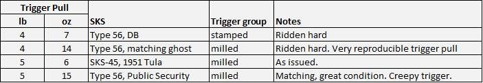

I only have one SKS with a stamped trigger group, so not much of a sample size.  It did perform well.  I suspect the smoothness and lightness of the trigger pull may have more to amount of use and hence wearing in of the smoothness. Exact spring constant and lube may be other factors. PS could probably speak better to the various factors. I'm no expert and this represents a rather small sample group.  The Public Security SKS is in excellent condition but definitely had the trigger with the greatest creep.  The old beat up Albanian used ghost Type 56 had the best trigger with regard to feel, creep, break and consistency of the weight of pull.  The stamped trigger group DB had the lightest overall pull but more variance with respect to the exact weight of pull to the break.
Used my Lyman trigger pull gauge. Pulled the trigger a few times first (warm up) then measured the average of 7 pulls. Tried to replicate the direction and duration of the pull as closely as possible for each trial.

Quote from: Phosphorus32 on January 27, 2017, 08:44:55 PM
