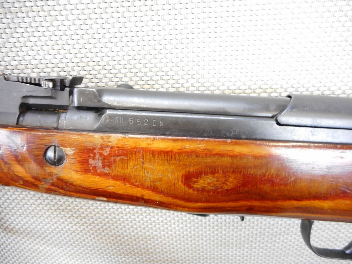

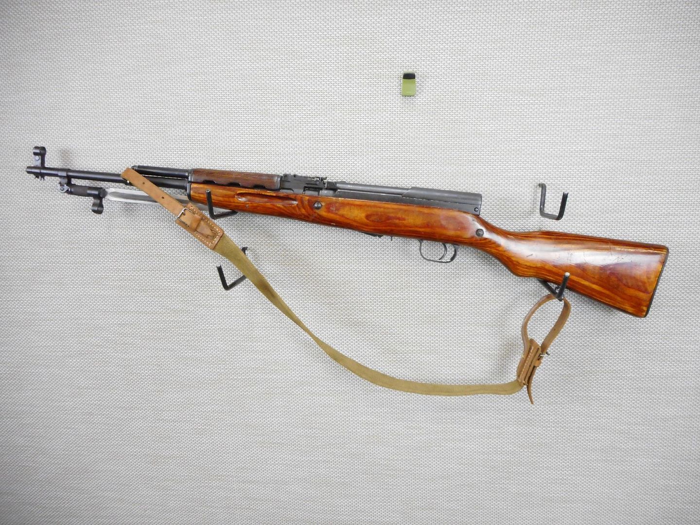

https://www.icollector.com/SIMINOV-MODEL-SKS-CALIBER-7-62-X-39_i32500676
This is a Canadian auction that's already been sold. It was for a Russian SKS45 with the laminated stock/blued bolt carrier/Arabic stock numbers. Wasn't sure if anyone is keeping track of SN's for these?
#9
Thank you very much for that.
A Russian with the blued carrier / lammy combo..
I still lean towards these being middle east refurbs. Now I'm really leaning towards it.
Nah, looks like cold blue on the carrier and the Russian ICs dont have a blued carrier to begin with.  Laminated stock is normal for a russian also, so its not like thats any indication.
Unnumbered stock, and that's not cold blue. That looks identical to multiple IC examples.
They're refurbs.

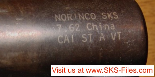

Looks at the stamps prior......   They had no problem stating NORINCO where applicable i.e imported from China PRIOR to the 'A' and 'ALB' version in question.
[/li]
[li]CAI #1, Century International Arms out of Saint Albans, Vermont:
NORINCO SKS
7.62 China
CAI ST A VT
Type: Ink Marking
Location: Left Rear Receiver Cover
Notes:  I'm calling this one the first CAI stamp out there.  Early St. Albans etching located on the rear left of the receiver cover.  Obviously a simple receiver cover swap makes this entire import stamp go away.  BATF certainly had issues with this type of marking, due to it not being on the barreled receiver as well as the very minimal depth of this type of etching. (Photo courtesy of padams8888.)
