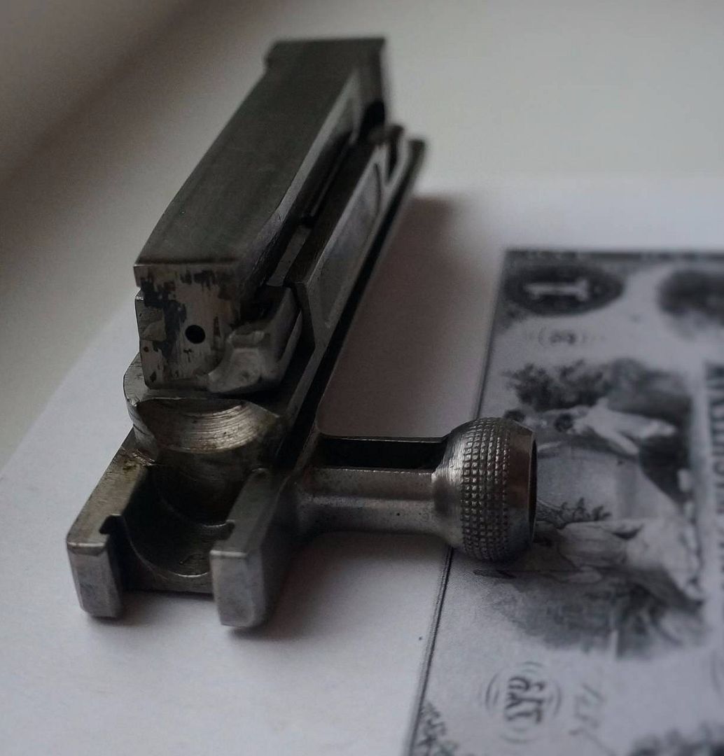

Fascinating!  8) Look at that bolt face  :o

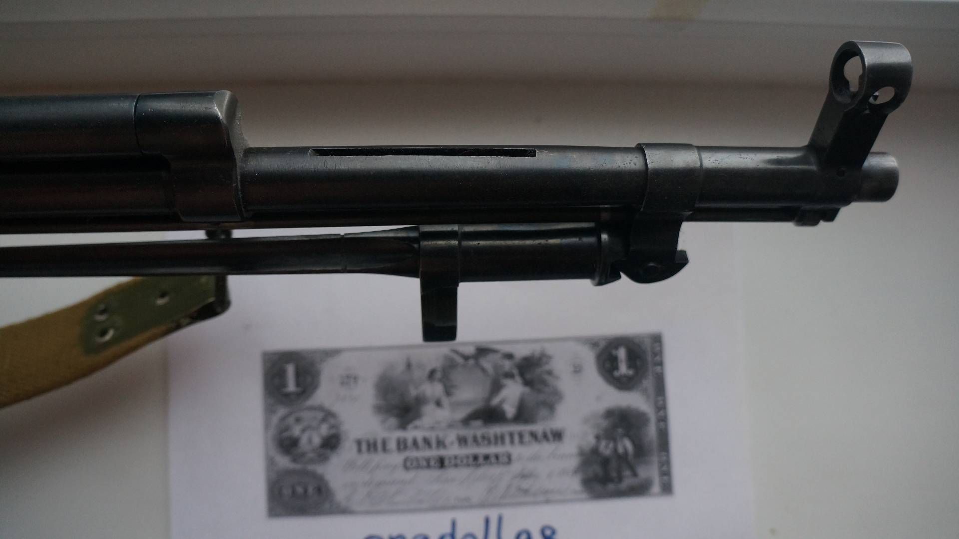

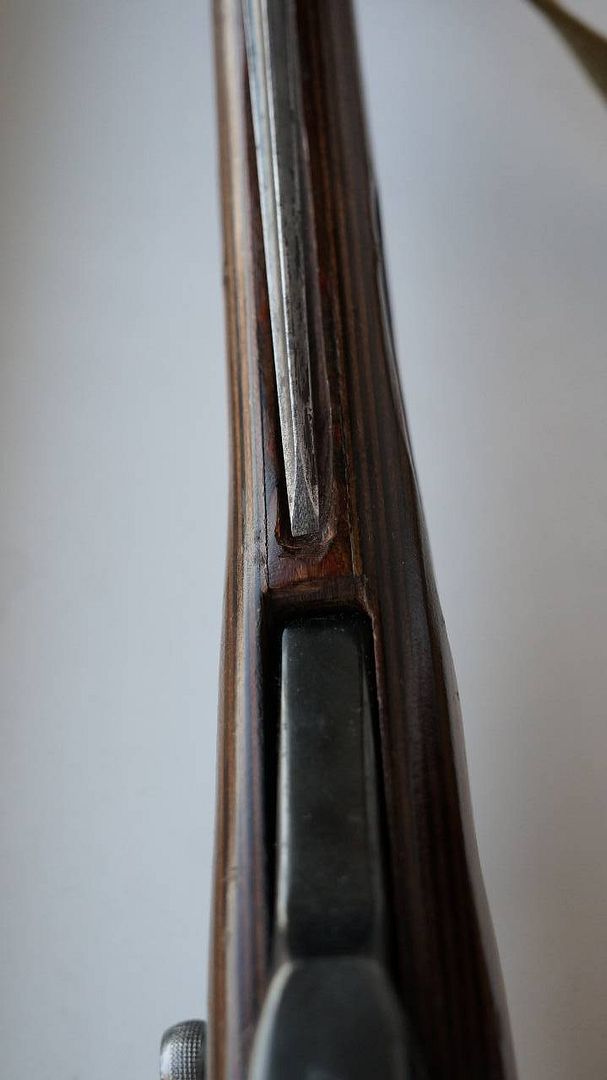

Nice to see the clear "8" in the date though even if the cover (and indeed the whole rifle) has been decommissioned for sale in the Russian civilian market with the cuts.  That stock is a replacement.  The second crossbolt wasn't even known to be needed as a reinforcement point in original stocks until '56.
I find it interesting that the bayo collar appears to not be knurled, would make for a slippery grip in gloves in the snow I'd think.  Gas tube takedown lever is a totally different style as well - no tab.  :o
Boltface looks odd too, the fixed portion that grabs the case looks off, though that might just be the decomissioning cuts making it unusable and not swappable.  I need to pull one off my '50 and compare it to the photo to see what the ifferences really are.  :)

I think the lever tab is just hard to see at that angle, and the extractor was removed for demill.

No, I think it's a distinct variant.  Check these '49s out.  Notice the dark shadow from the tab on this one that's in the same orientation as Bunker's '48.

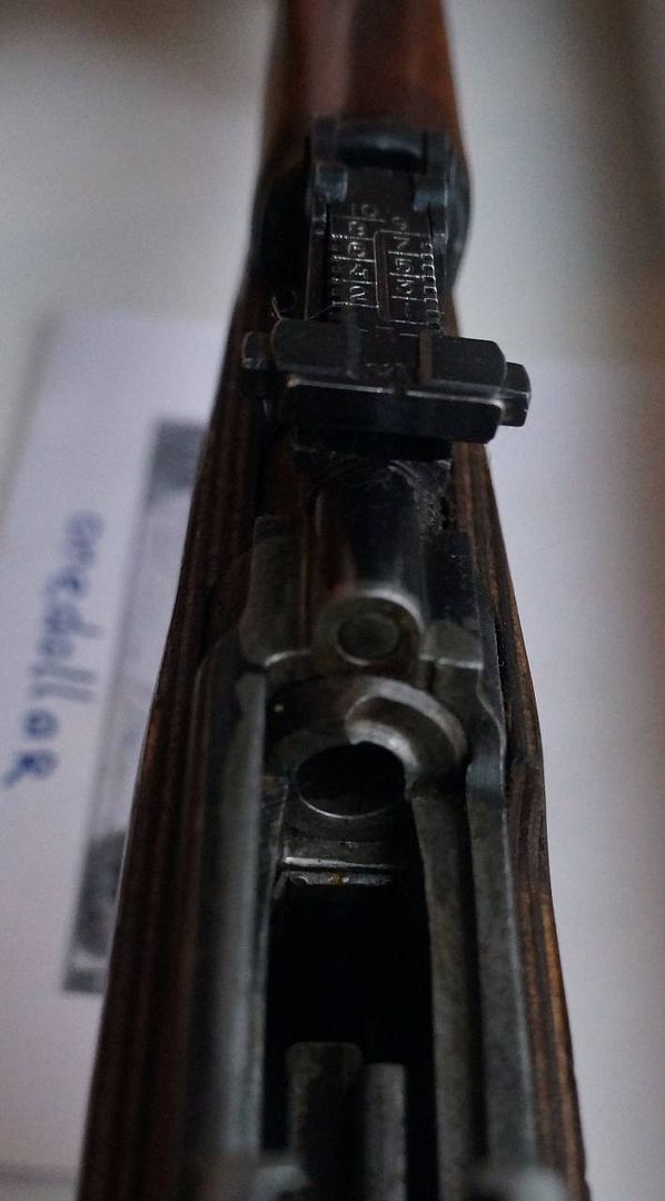

But then when you see the detent dimple, you see that it actually has a groove that it can ride in on the rear sight block.  This means that the rear sight block is different on this '48 as well, that one slipped right by me at first:
Another thing I noticed is that the receiver cutout for spent shells to freely eject on the right side of the '48 is milled with a vertical profile at the back of the cut.
49's and above all have angled profiles at the back and the stocks all follow this contour pretty well.
I wonder if the original '48 stock has a vertical cut in it instead of the slight angle we see in all other stocks?  This gun is definitely an odd duck.  Neat stuff! thumb1
Oh,  I see the dif in the lever...  Im just not convinced it dont have a finger tab.

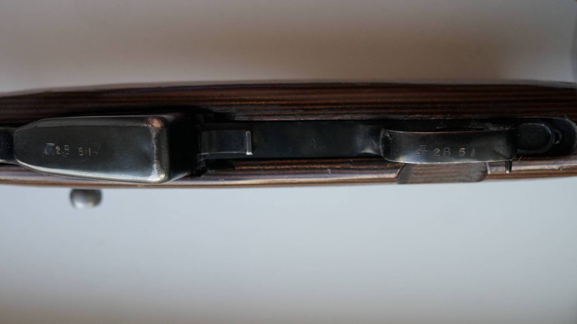

I think you're right on the training thought Bunker.  Notice the "УЧ" in a box on both the trigger group and magazine:
That as well as "УЧЫ" is the typical abbreviation for "УЧЕБНЫЙ" which is "Training" according to The Google.
Datig has a page on training TT-33s
We've found a few Russian SKSs pop up with УЧ stampings (top one from user El Viejo, second from Rocky11731, third from Bill in Indiana):
Yeah...  I dunno.   Maybe that boltface was made that way.

Pretty sure that's part of the de-mill process. Looks like a carboned up bolt face that was taken to a belt sander.

I can't how it could work as is.
The extractor is the only part having a lip on all sks....  but not having the left/bottom rims, I imagine the case going all over the place uncontrolled during extraction prior to being ejected.
