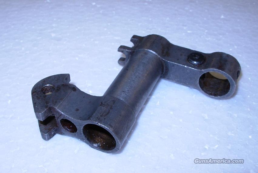

Ok Agrace...  That will come right off.  Lol.
It actually looks like the M lug isn't simply ground off.... Its a special critter all its own.  If you simply cut off a regular unit ears, it wont have the same block mass remaining.
