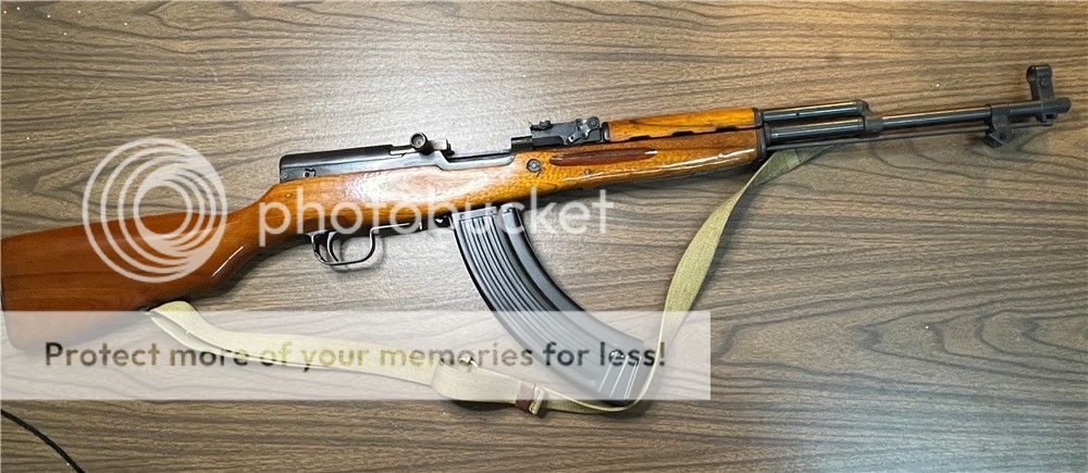

RM, I ran across an interesting variation of the B-West #9 Import Stamp on a Gunbroker auction:
https://www.gunbroker.com/item/892881019
"B-WEST" is inverted, for some reason. Just thought it was worth noting.
I know the auction pics will only be up for 90 days so I went ahead and uploaded them to my Photobucket and then to here.
If this has already been covered, feel free to delete the post.
Neat one FC. Technically that's a commercial chinese import stamp, but no I've never seen an inverted B-West stamp. Very neat!  thumb1
Bubbazinetti
That image on the receiver says "Sporter" but it's a 20" rifle. I thought all Type 56 Sporters were 16" carbines?
Quote from: Bubbazinetti on February 22, 2021, 07:40:06 PM
All the Sporters imported by Labanu were 16", but this is a B-West and is not even on the list in the SKS Guide of commercial variants. Also of note besides the B-west being upside down is it doesn't state SKS just 'Sporter'. Add to the fact it is a DP with Changchun City stamp added.

Quote from: firstchoice on February 21, 2021, 07:14:21 PM
Quote from: running-man on February 21, 2021, 09:33:05 PM
Neat one FC. Technically that's a commercial Chinese import stamp, but no I've never seen an inverted B-West stamp. Very neat!  thumb1
RM, were you saying that the B-West stamp is a commercial stamp only or that the B-West SKS shown is a commercial model? If so, are all DP's considered to be commercial?   (Sometimes I need a refresher course.  thumb1 )
FC, the photo doesn't show here at work (we have photobucket stopped at the firewall as they are a security risk apparently).
When I get home I'll look at it again and try and remember why I made that curious comment.  I can't remember at the moment which is not surprising seeing how many times I've slept since February 21st.  chuckles1
B-West did import some commercial guns, but a good many of them were plane Jane 20.5" standard type 56's.  They did stamp "Sporter" on a good many if not all of their imports.  Many people get wrapped around the axle with that little word.  Hopefully I didn't, but honestly it wouldn't be the first time (nor the last time) I'd be wrong!  rofl2
Thanks RM!  Photobucket is a sanity risk!  chuckles1  I keep with them because I have soooo many pics uploaded on their site. But it's always a challenge.
Yup definitely brain fart there on my part FC. I got taken in by the banana mag and the sporter text instead of really looking at the gun more than two seconds.
Std. type 56, aftermarket mag.
Thanks for keeping me honest!! thumb1
