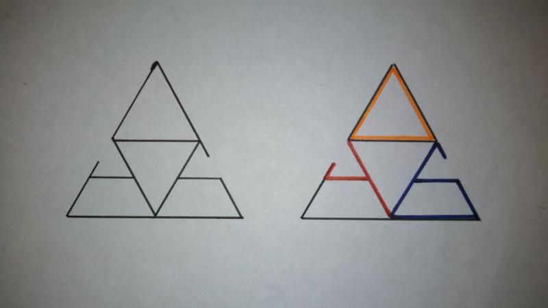

The stamp itself, is of the "triangles" pattern and what I will call a 406b arsenal stamp. This is how it is listed in the survey database, and it's a "b" because there is a numerical 406 arsenal also. Going off how most "decode" the other popular triangle stamps, 406 seem pretty valid (could also be 0406 if you count the extra triangle as a zero).
The stamp looks like this (artwork by myself):
I have highlighted what I consider to make out as the 406. This is really just a title though, as what actually matters is just guns with the same stamp, whatever you want to call them.

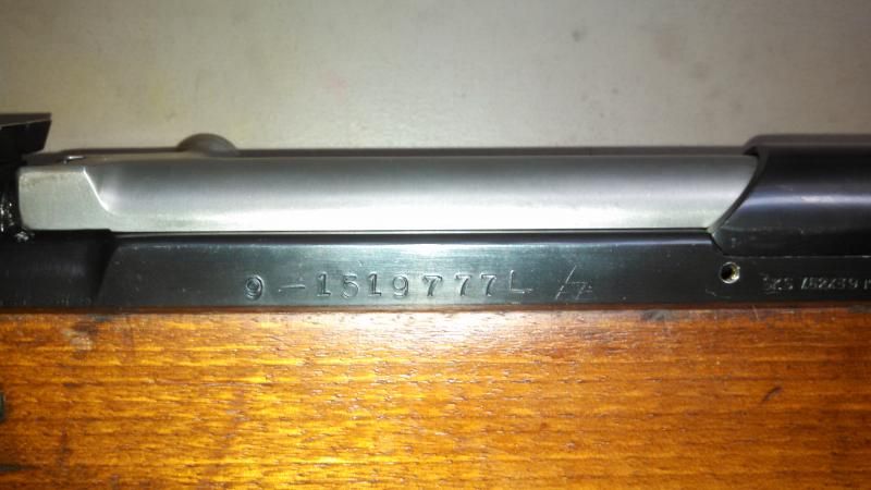

Now, what I find interesting about this arsenal, is that the serial number on all the 406b guns I've seen always starts with a number and dash before the actual serial. They are also followed up by a letter afterwards, and before the arsenal stamp. The letter suffix doesn't surprise me as much as the number prefix, because we've seen some importers put a letter suffix stamp. If you look at the data collection post below, it seems pretty obvious that the letter suffix IS importer added.
Here is a picture of my gun, for comparison sake:
The other thing to mention, is that all of the 406b guns I have seen except one, were imported by Poly USA. Not sure if there is relevance there, but it's worth mentioning for now.
I would love for other people with this arsenal to chime in, with their serial, importer, and other build info. I REALLY would love to make some kind of connection with the number prefix. That's the only thing that seems to set the 406b guns apart from other arsenals.

9-1519777 L  (my gun) Importer: Poly USA. Short lug barrel, "D" rear sight mark, ground off bayo lug.
