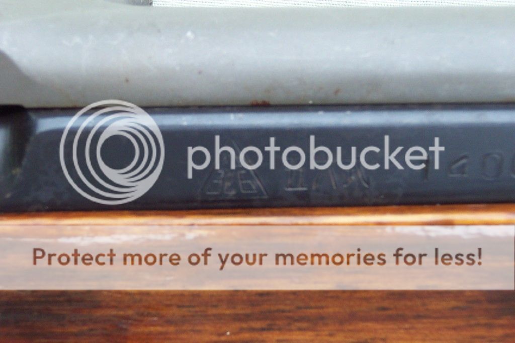

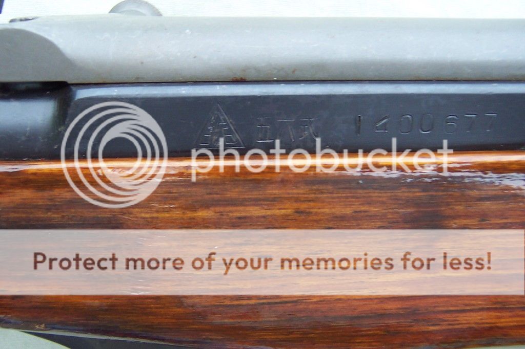

Example of /326\
( This is the 1 I just picked up, just because it has a D stamped rear sight...and  to prove mosinitus hasn't completely taken hold.  rofl
