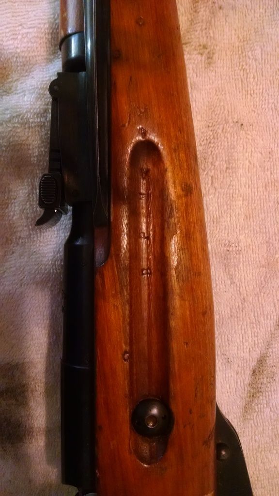

I've been watching the gunsnammo site for a while thinking about getting an M39. She's had a few late sixties rifles lately and I couldn't pass up a 1968. I can't find anything definite on these rifles but it looks like around 6,000 were made with left over parts. One source said they were assembled by Sako but didn't have anything to back it up. One theory is that these were used for officer marksmanship training but again no one is really sure. This was built on a 1905 Izhevsk receiver with a mix of early Tula and Izhevsk parts and a Remington bolt body. The stock is a post war with the square joints and the butt has been reinforced. I put some comparison pictures up to show the improved sights and much thicker stock. It has been shimmed and the pistol grip is a nice improvement. The inside of the receiver has been polished and the bolt is butter smooth. It also has the Finn "jam free mod" on the magazine. You can't see it but the trigger has two pins inserted for the sear to ride on and for some reason the extractor has been blued.  To me it sort of looks like a M91 and K31 hooked up and this is the result. I can't wait to get it out to the range. I think even R-M could love one of these :)
