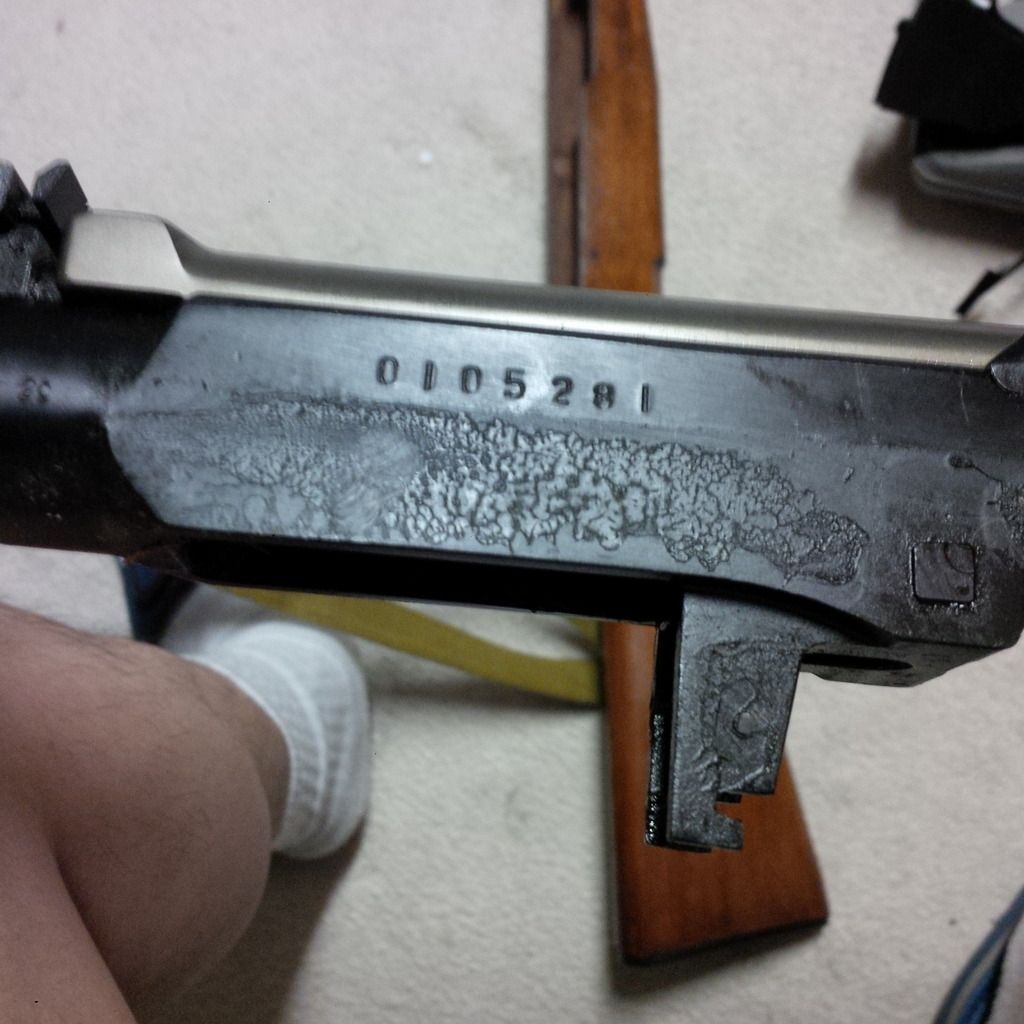

I have a Chinese sks with no Chinese nor Soviet markings except the"n" on the rear sight serial number 01052xx.
The left side of the receiver is clean without any marking except the serial number it has spike bayonet, front side sling mount milled trigger guard and from reading the info here this should be manufactured between 56 to 57 is that correct?

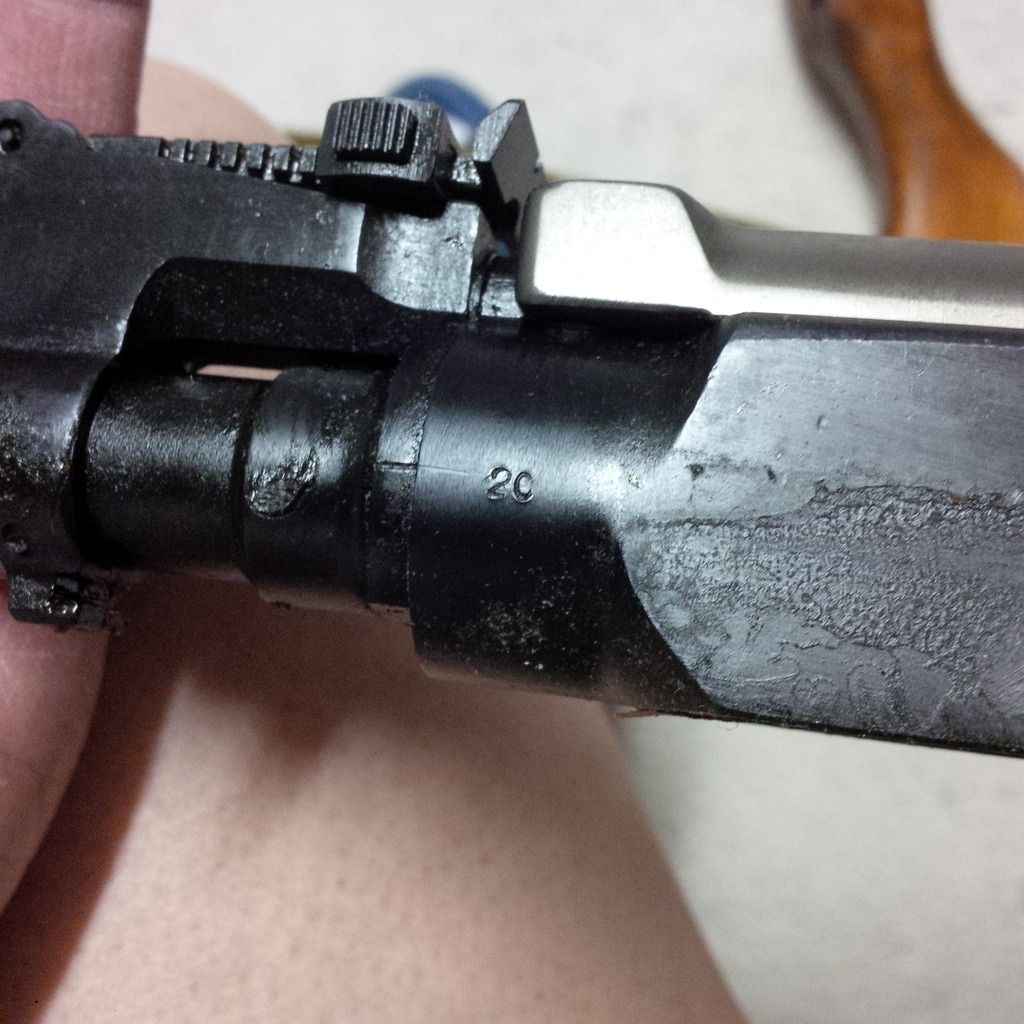

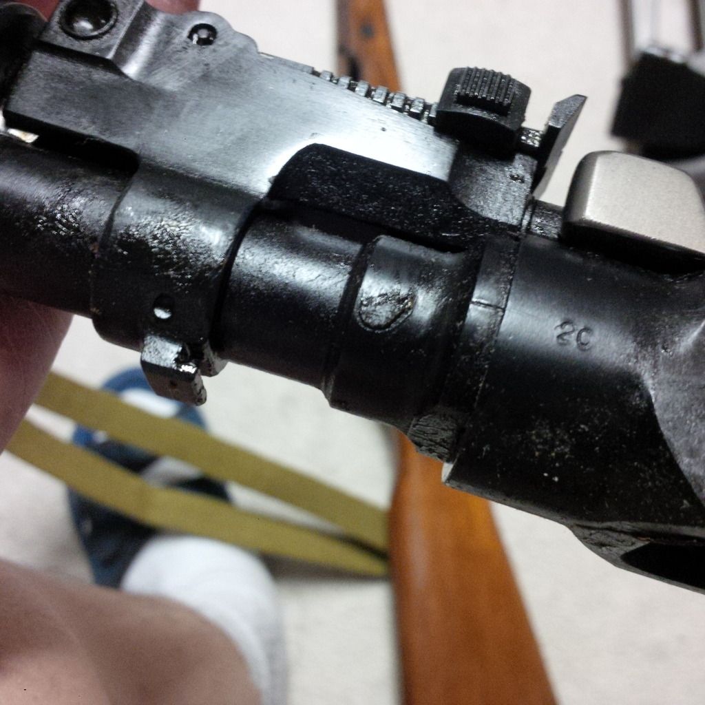

On the left side of the receiver the only marking is 2C or 20 can't really cause the rifle is still in cosmo and I want to preserve it as much as I can and there is no marking that I can see on the right side of the receiver.

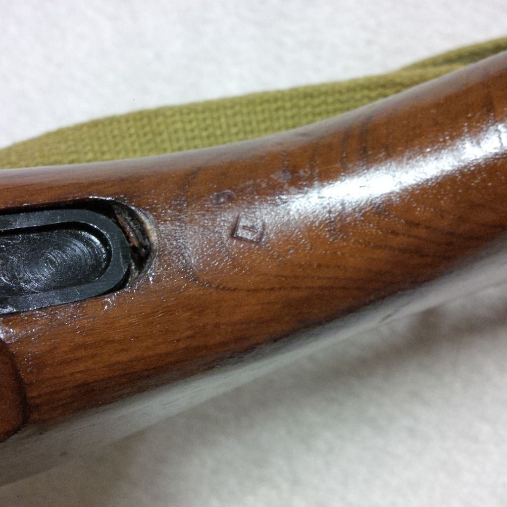

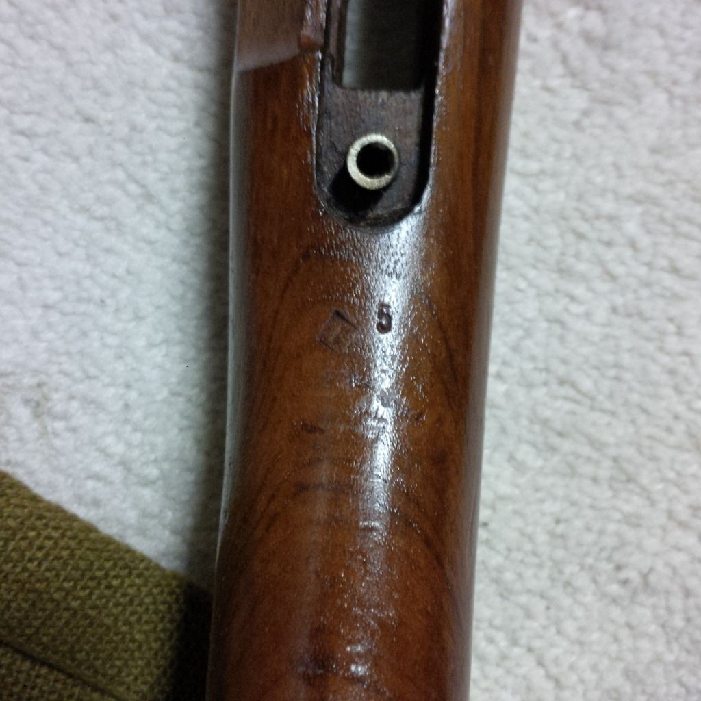

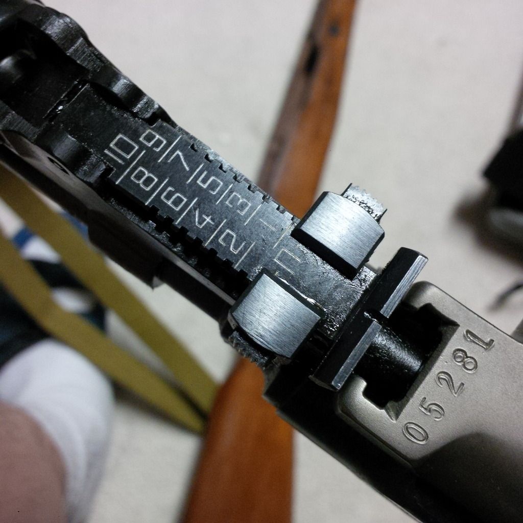

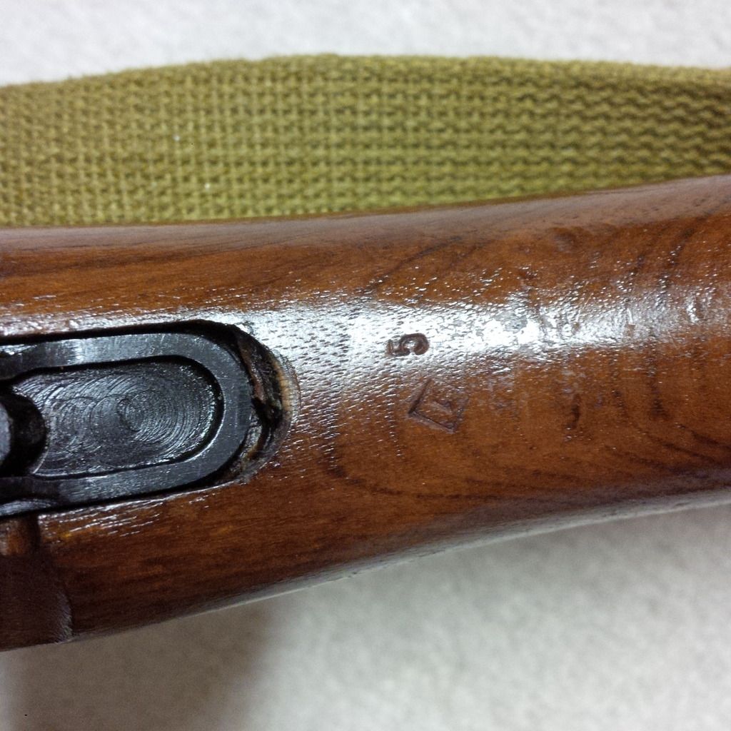

There is also "n" on the rear sight and marking on the bottom side of the stock us 1 with a square and a 5.

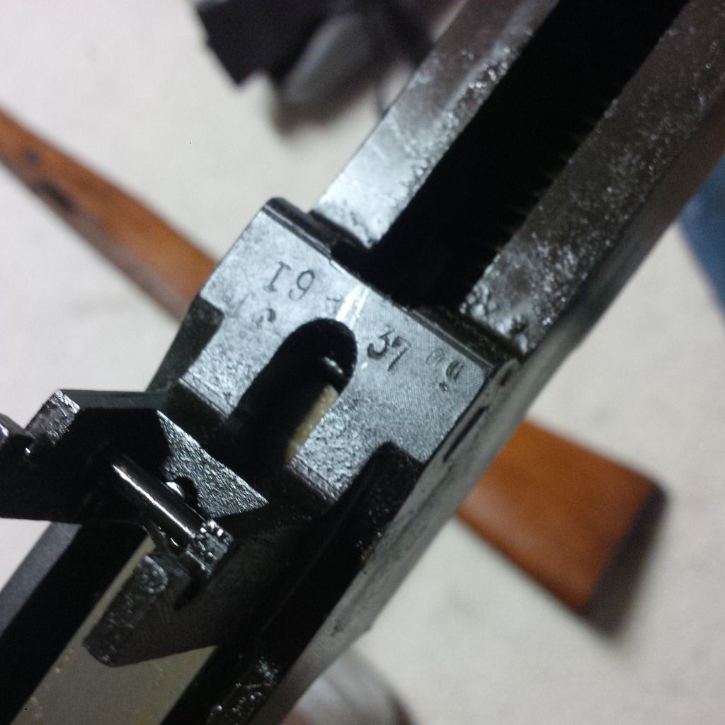

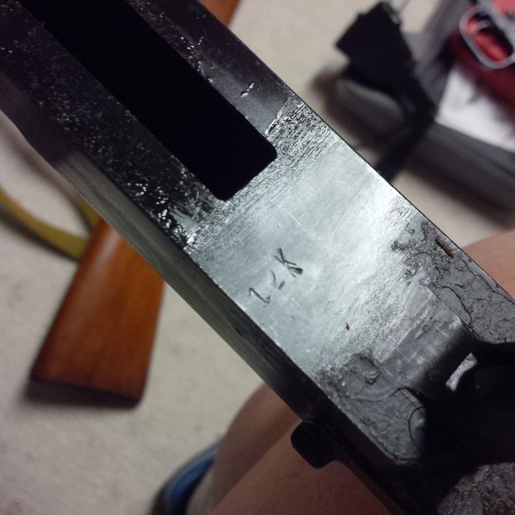

There is a number 12 and looks like kk on the bottom of the receiver near the front and I did found what looks like 1957 near the rear of the receiver
Thanks for the pics..  This is def a scrubbed and rebuilt rifle done in later years given the lack of markings, serial, its features, and evidence of the sides of the receiver and cover being resurfaced.
Based on the style of your rear sight block and receiver type, I would say it was originally a 10m or 11m /26\ gun from either 1965 or 1966.  The (n) rear sight would also be correct for this assessment. The #20 on the left/forward of the receiver is a mating number to your barrel which you will likely find the same # on the barrel lug.. same side.
Although scrubbed and re serialized, Its still a quality gun most likely originally from Jianshe like described above.

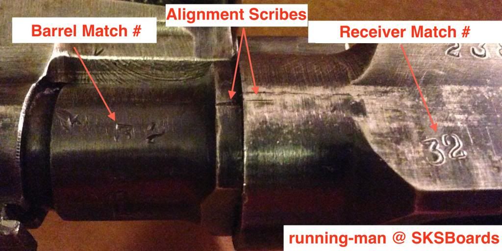

This is a pretty interesting barrel match number.  Typically, the numbers are stamped on the barrel lug and the flat of the receiver like this:
This one is on the receiver round with the lug looking pretty blank (to me anyhow, another 20 might be hiding under the grease)- that's something we simply don't see in the US.  That leads me to think that this gun was built/refurbed long after our Chinese type 56s stopped coming into the US (which was in 1994).

I can tell you this, that П on the rear sight is a Cyrillic "Pe".  Russian SKSs had this on all their rear sight leafs (leaves?  :)))  The Chinese utilized this type of sight well into the '60s and it was gradually changed to other versions such as a "D", "3", and "III".  Having this sight on a 'new' gun could mean that the new gun is made up of older components, or it could also mean that the new gun is actually an old gun that has been refurbished which I think is a bit more likely.  None of the stamps on the bottom of your receiver look like pre-1965 stamps to me...they look modern.  Again, they could have been put there on a new gun, or old guns could have ben srcrubbed of any previous markings and then these new stamps applied in their place.

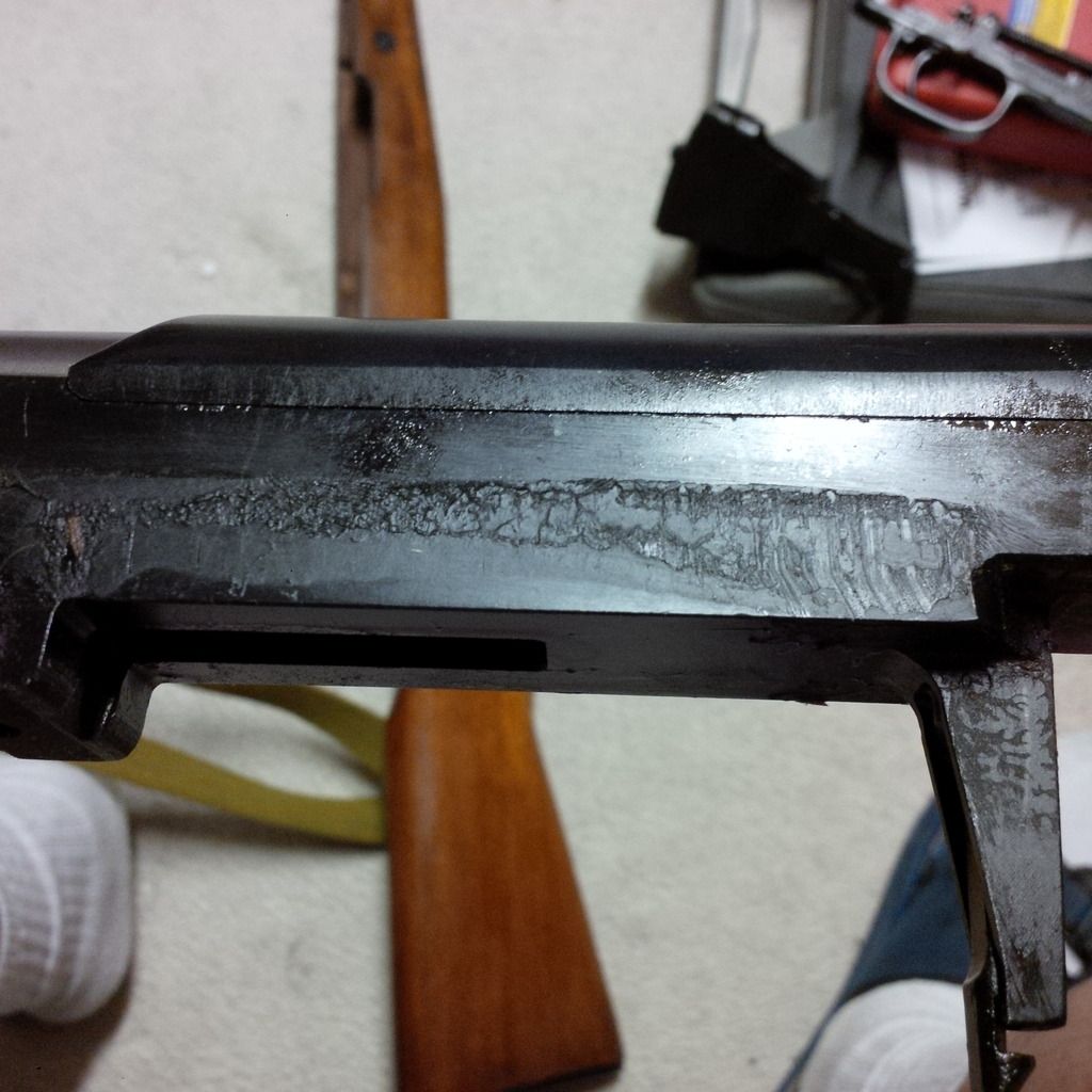

Ok, this photo is the money shot; I totally missed it before LC slapped me upside the head with it:
Quote from: spcamno on April 18, 2015, 10:54:06 PM
See how the receiver cover has flats to match the sides of the receiver?  Both have been ground down a bit in order to scrub the S/N and other markings on the receiver.  99% sure it's a scrubbed older gun, refurbished in '01 & not newly built from old parts in '01.
It could easily be a 65/66 Jianshe gun like LC says, *or* it could be from almost any year between '65 & '80 from one of the other smaller factories.  I think that's about as accurate as we're going to be able to pinpoint this one based on the features.
