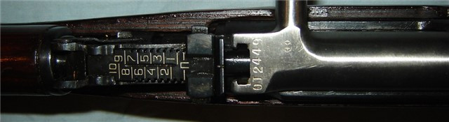

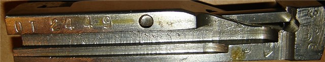

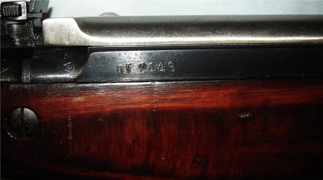

P32 is correct with the OT prefix, it doesn't help as there is only one single other OT entry in the database.  Interestingly enough, it also has a blank receiver cover though it has the 1st GRAU stamp on it:
In general, we have relatively very few '53's in the database compared to '52s and '54s, good likelihood that it is a '53 from the lack of other examples.
