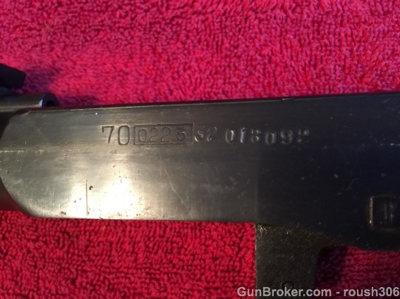

Arsenal mark could have been scrubbed during refurbishment. This is a great example of the year code. The 70 being a different size and font makes it really obvious how those digits are the year code, 1970 manufacture.
The second serial number 04372DN is the importer added serial number, to make sure it's a unique serial number for that specific importer's list of all of their serial numbers (regardless of firearm model), as per ATF regulations.
First of all, welcome to the boards!  Glad to have you here.  thumb1
Definitely an odd duck you have there.  Not commonly seen, especially with the second set of numbers so far away from the first.
While not common, these have been seen in the wild before in various formats.  In the first format, a large 70 (or 71) followed by the arsenal stamp and then a 5 or 6 digit S/N is often seen on rectangle arsenal guns:
Then every once in a while you will see a carbine without the rectangle stamping, but with very similar stampings, though maybe he 70 isn't as large, but has a clear 70 + arsenal #+ some two digit number (33 is often seen like in yours) + S/N:
In your carbine's case, I would guess this is a 0223 produced carbine (just like the above) and the #'s on the bottom are the S/N and correspond to the 4372th carbine in this particular lot.  The DN may have been stamped at production, or most likely were marked there during decommissioning/export/import.
