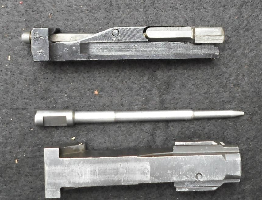

Just for giggles  :) here is a MAS 49/56 firing pin in relationship to an SKS bolt. It's a chunk compared to the toothpick SKS firing pin, and neither MAS has ever slamfired.
