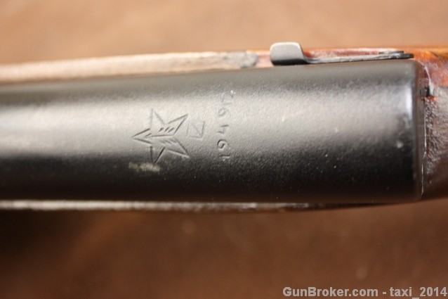

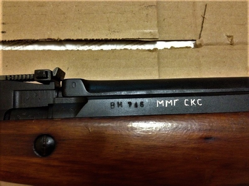

I think that question was answered long ago (on the Canadian boards oddly enough as a response to a majority of members over there taking the receiver cover at face value 100% of the time instead of looking at them with a skeptical eye): We know they scrubbed and swapped covers routinely pairing early parts with late guns and late parts with early guns.  The why is generally unknown, but it happened quite often during refurbishment.  The pin damaging the cover is pretty low down on my list of likely causes though.
Here's a '57 with a '49 cover:
Here's a 56 with a '49 cover:
Here's a '49 with a '53 cover:
