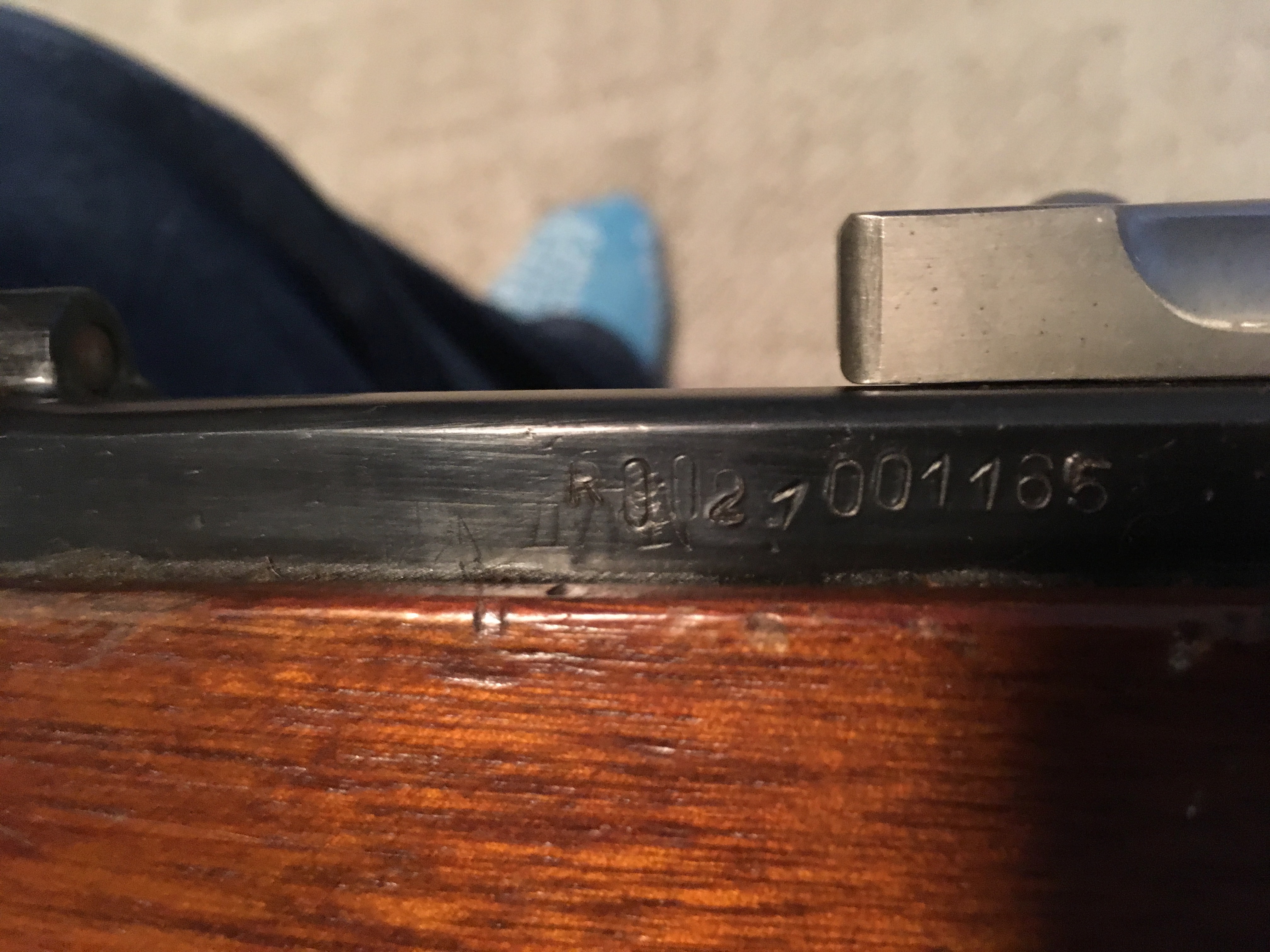

here's the info from the side of the rifle
Gary

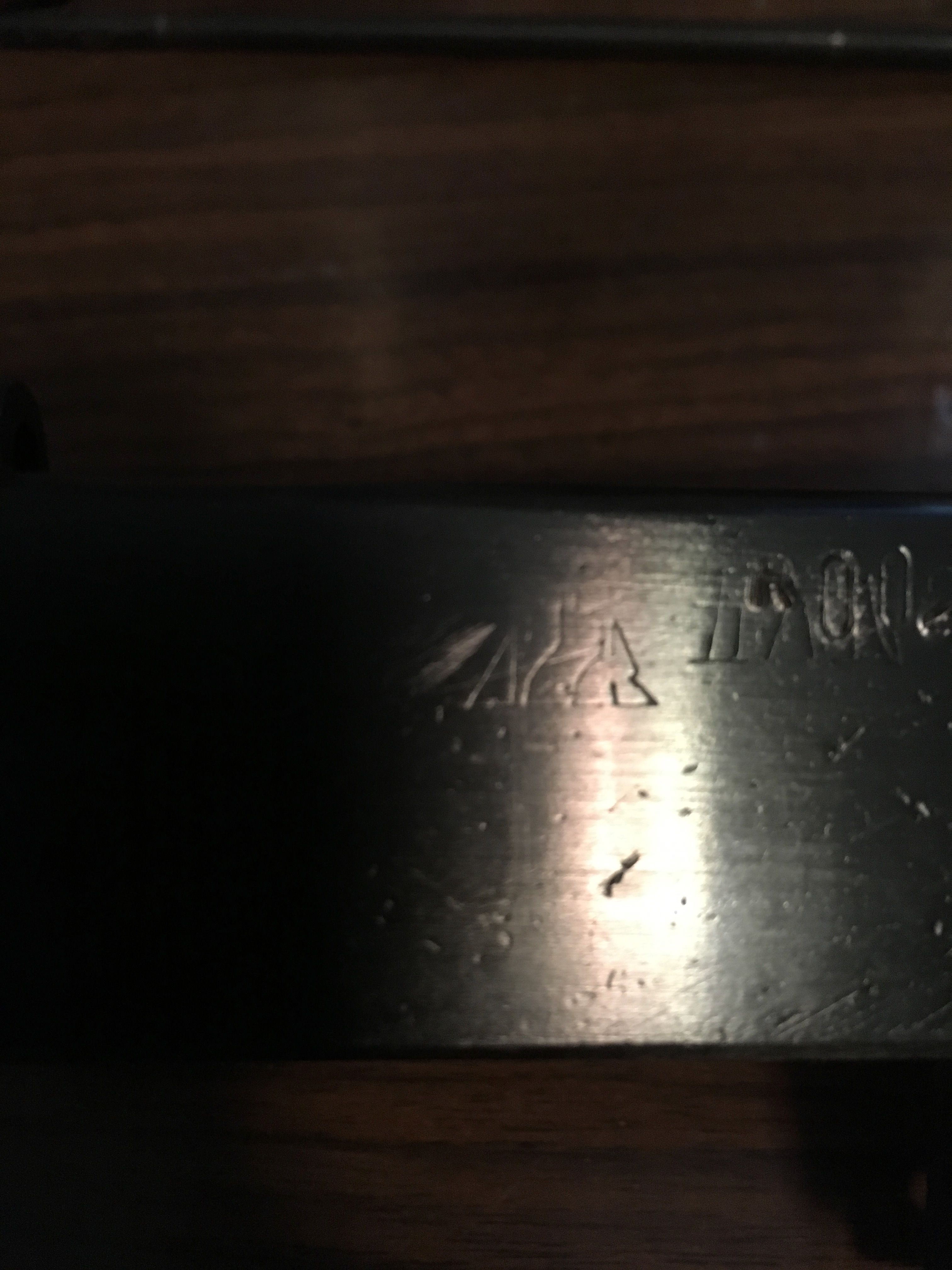

21 = 21st year of production = 1976. The "R00" in front of the SN was added well after original production. Looks like a /0223\, maybe, but the arsenal stamp is bleached out by the flash, so hard to say.
In any case, definitely a spike bayonet.

The area immediately to the left of the serial number and the Chinese ideographs is what we're needing to see clearly. As mentioned earlier, it looks like it could be [0223]. That's the arsenal mark that we're trying to determine for you. Throw in a few pics of the rifle when you get the chance, too!

Unfortunately, no. The arsenal stamp is the marking that looks like an odd looking number inside a triangle to the left of the Chinese characters.

Between the two I'd be pretty confident it's a /0223b\ stamp
Not to be confused with the /0223a\ stamp.

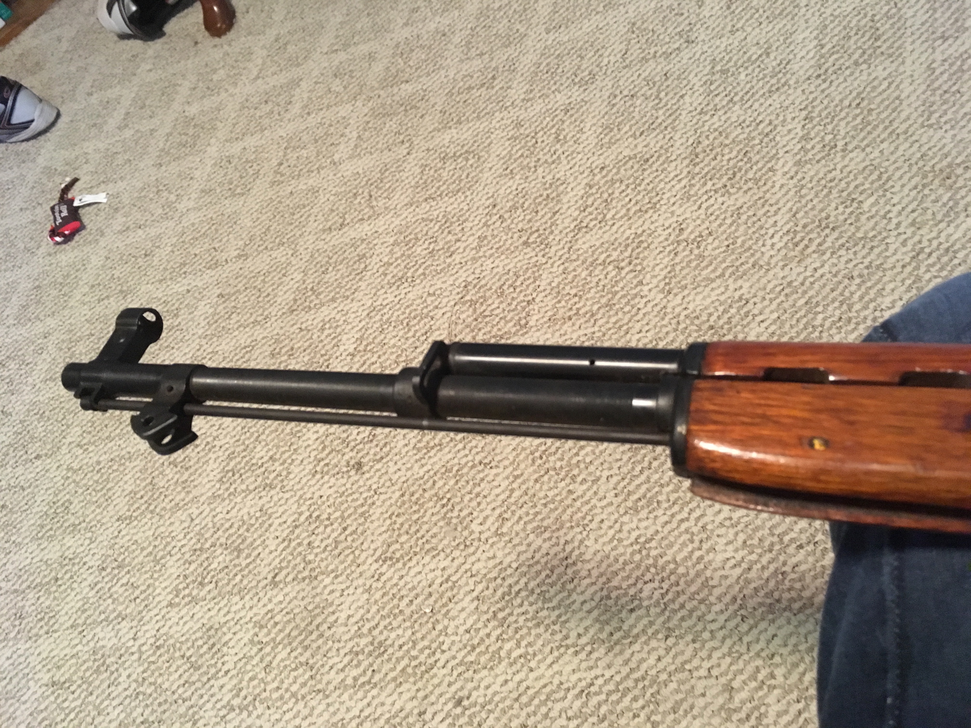

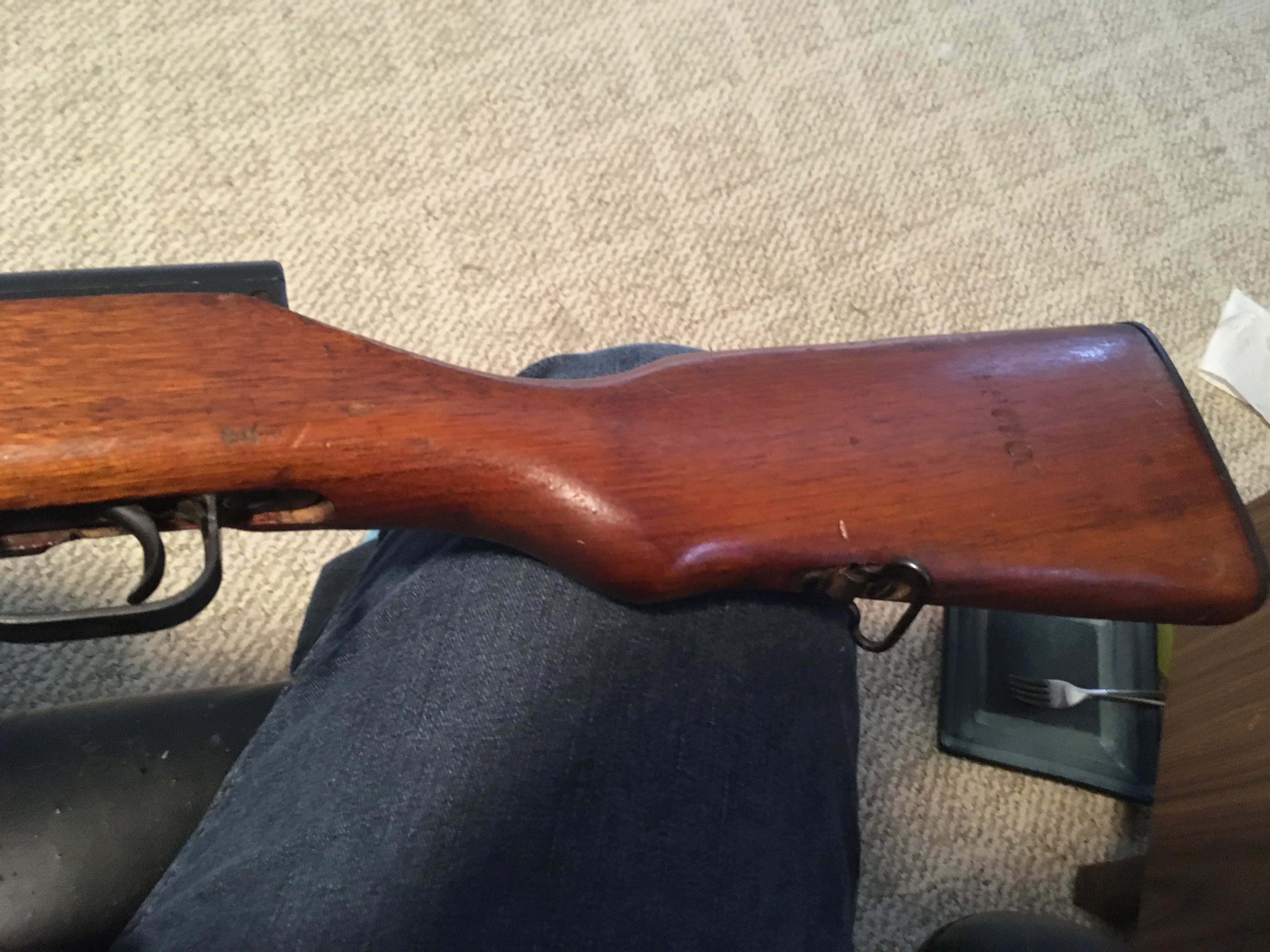

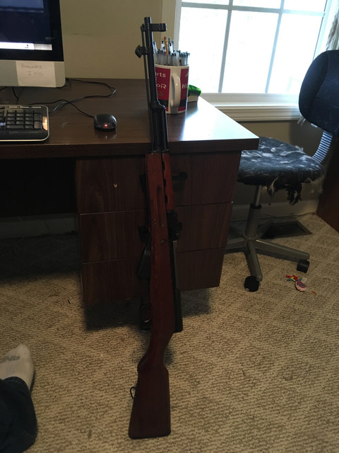

Here are some more pics
Gary
Hi Gary!
   Yeah, that last pic shows us it's Arsenal /0223\ that produced your rifle. And the stock is definitely made for the spike bayonet. I think I still have a few extra standard length spikes, if you need or want one. Let me know if you do and we can work something out.
I can't see your barrel/receiver match-up to know if it's a pinned barrel, or not?
Your rifle looks like a decent example, for as much as I can see. Put a bayonet and sling on it and she'll be an as-issued example. Does it appear to be all-matching numbers?
I Look forward to seeing it in it's completed state and whole-rifle pics taken to show her off here on the board! We are somewhat voyeuristic about our gun pics, don't cha know?!  :) :) thumb1 (Just watch out for that GM guy!!!:-X ??? :P

Welcome! I have a couple of extra spikes - if someone can nail down the 'zact measurement u need, I'll send you one. Cant tell if lug is rivet or screw type. PM me.
