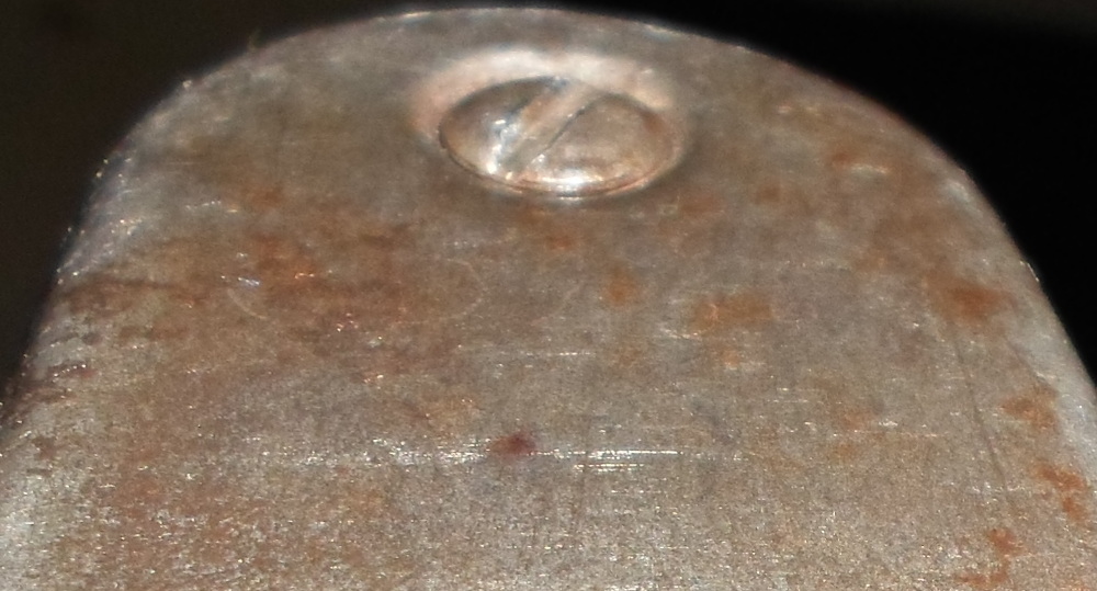

I'd be very interested in what is found.. I wish I could get the other one to show up in pictures, but my dinky camera won't pick the number up.
After 27 attempts, this is the best I could get. :)
My Romy has a serial in that exact location... dont match the receiver.   banghead1
