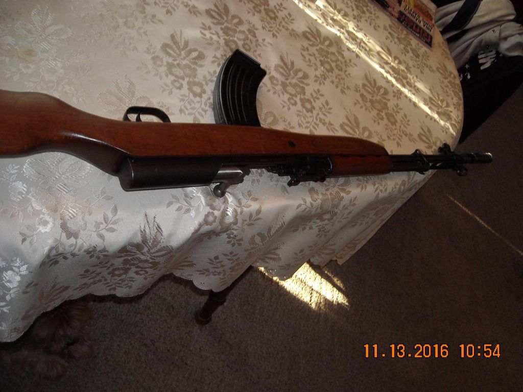

Got my SKS home today. Pictures to follow later :)

Good luck man...now lets see some pics  :)
