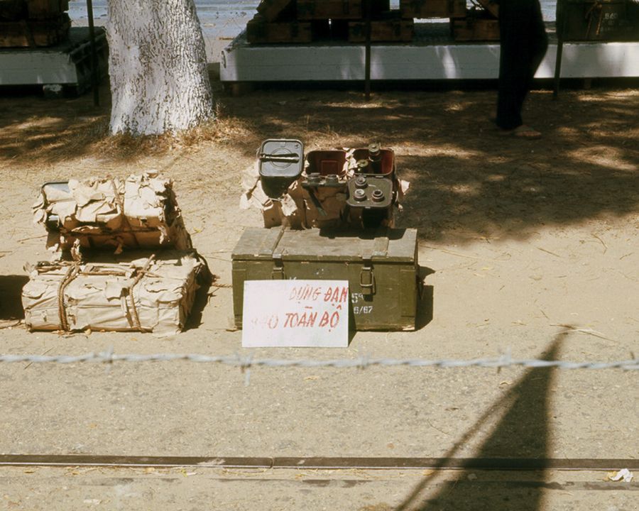

15 July 1967, "Operation Market Time" intercepted a trawler in the Sa Ky River. Once the battered hull of the infiltrator had been refloated, and its cargo removed, both were transported north to Da Nang.   Once the battered hull of the Sa Ky infiltrator had been refloated and its cargo removed, both were transported north to Da Nang, where these photos were taken.  Note the T56s Spiker's appear to be brand new. Too bad we don't know the serial numbers and markings on these, likely 11M or 12M series.
Remains of the trawler:
An inventory of the trawler's cargo, as reported in the US Naval Forces Vietnam Summary of July 1967:
Photos of the infiltrator cargo taken in Da Nang:
